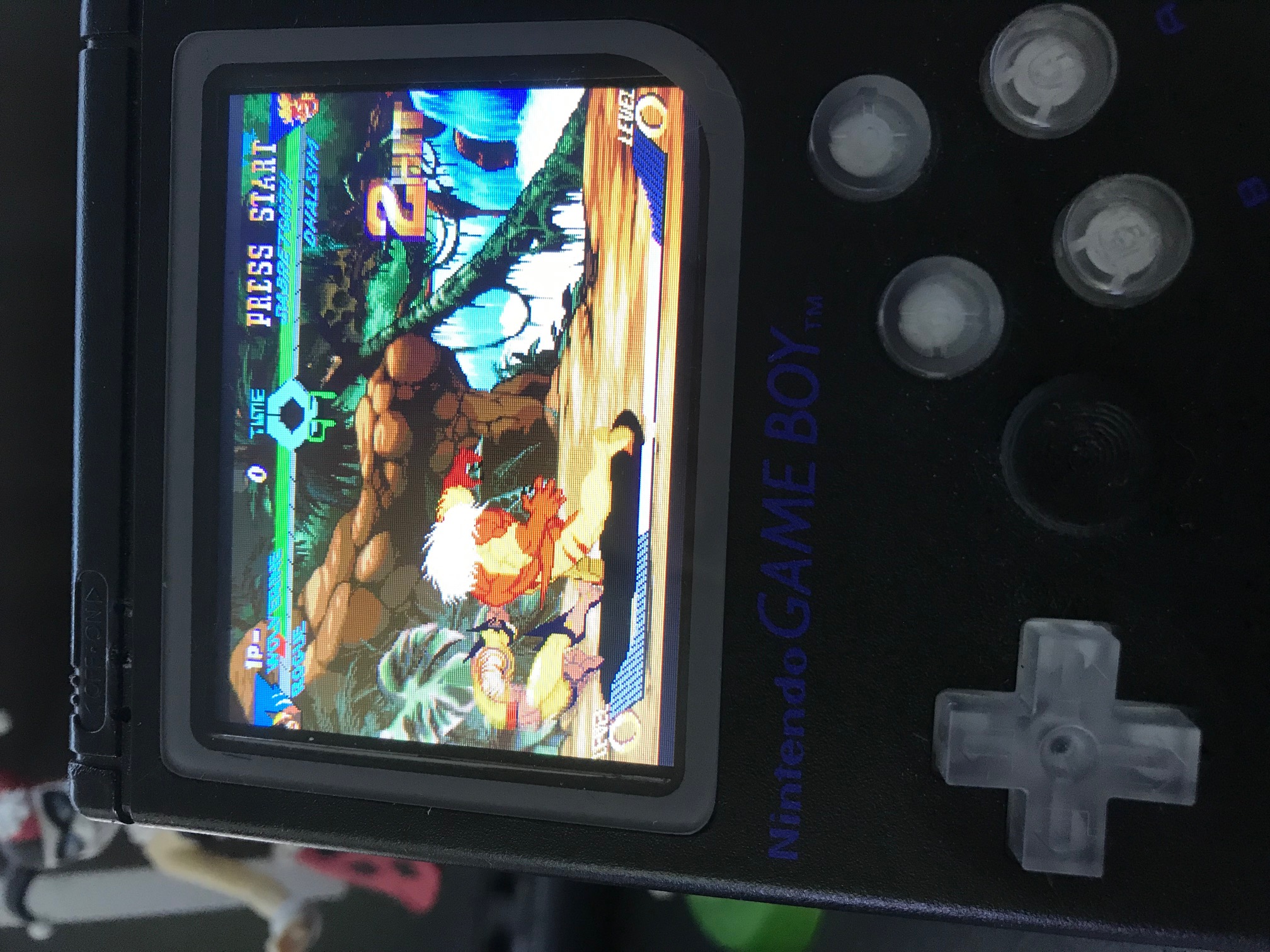

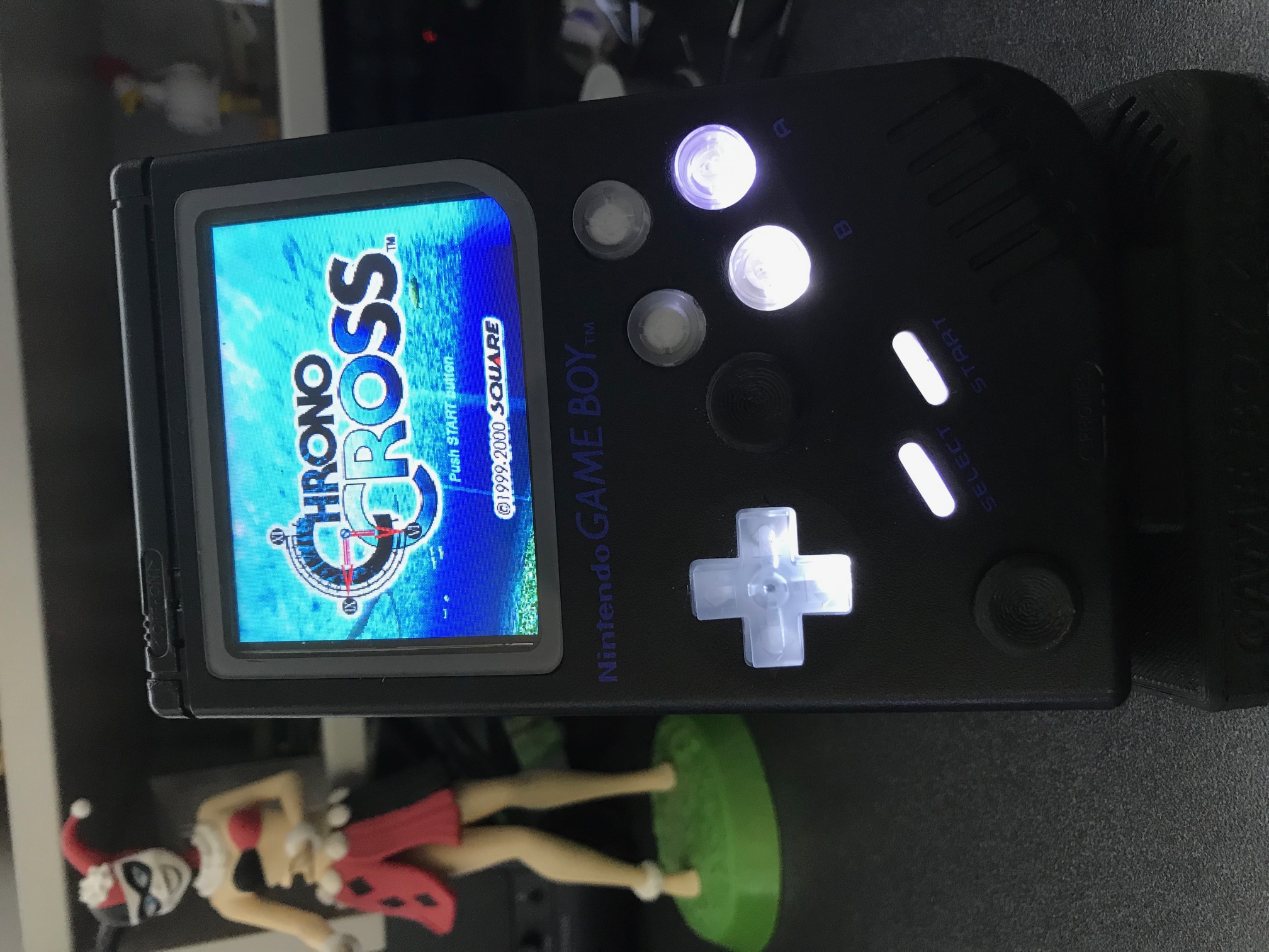

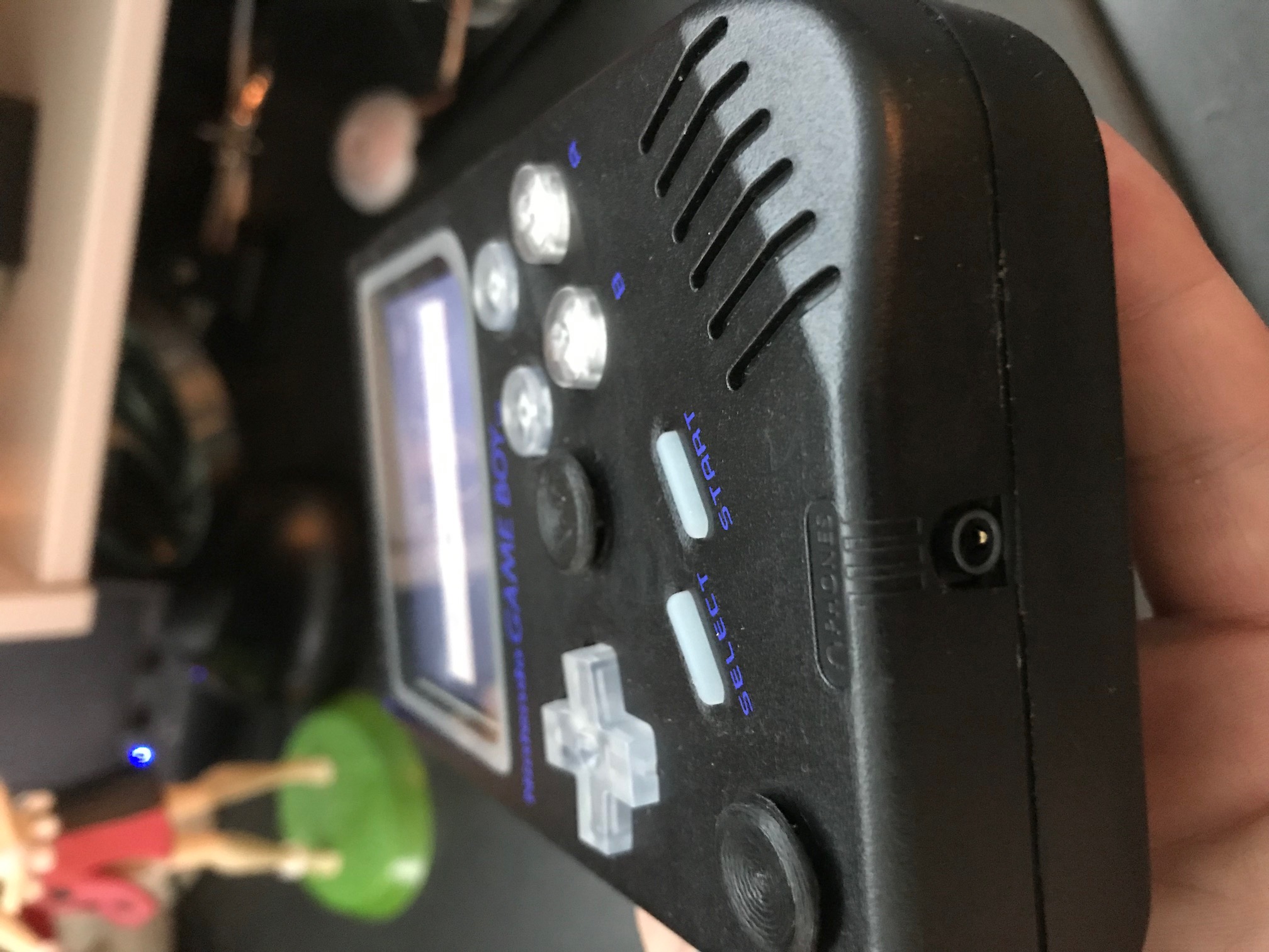

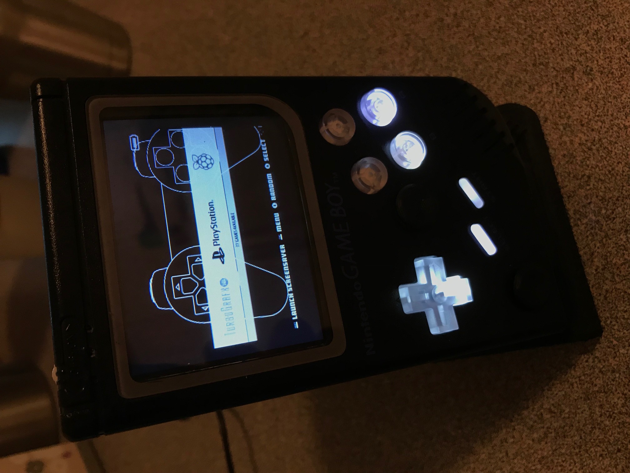

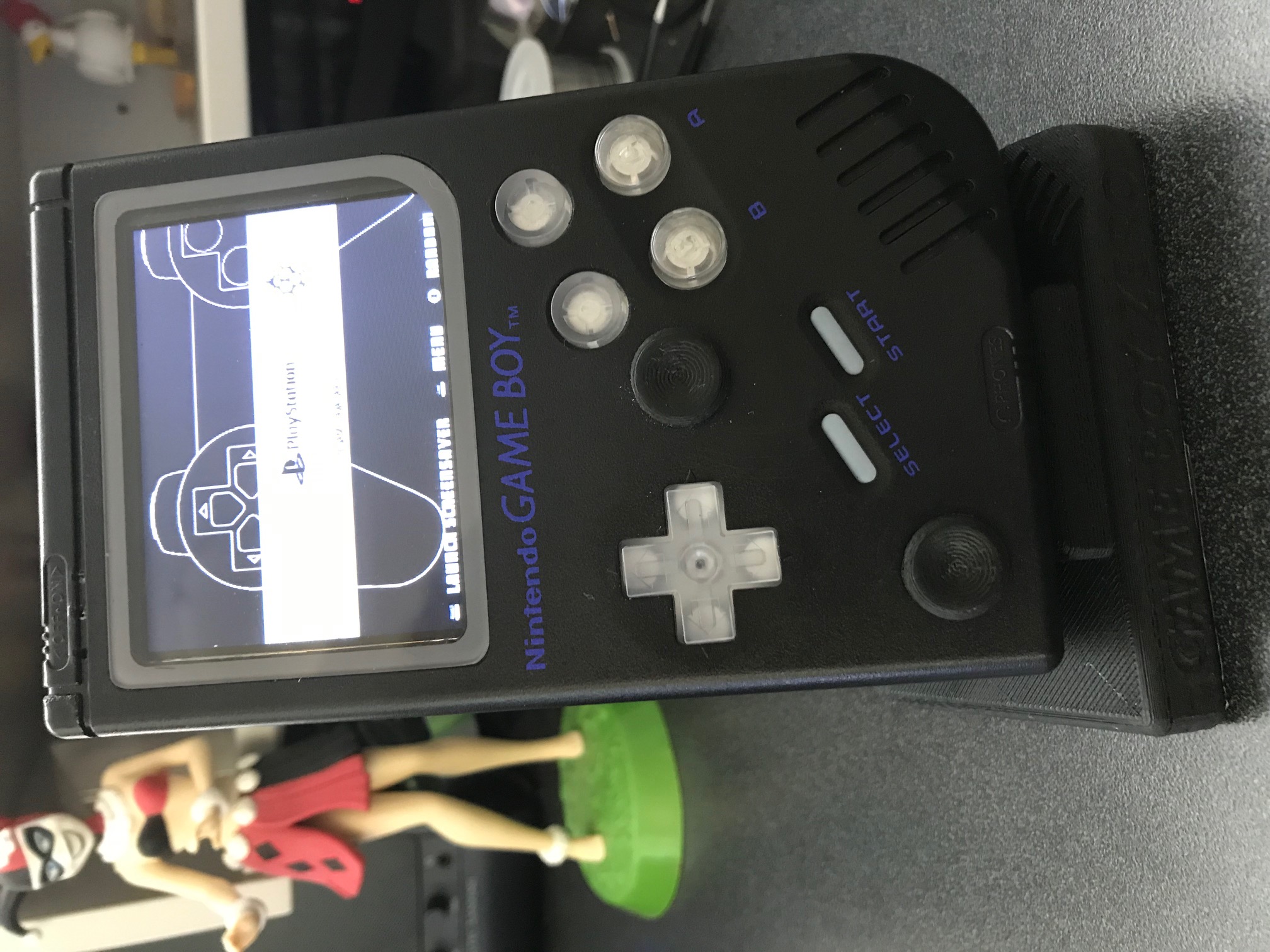

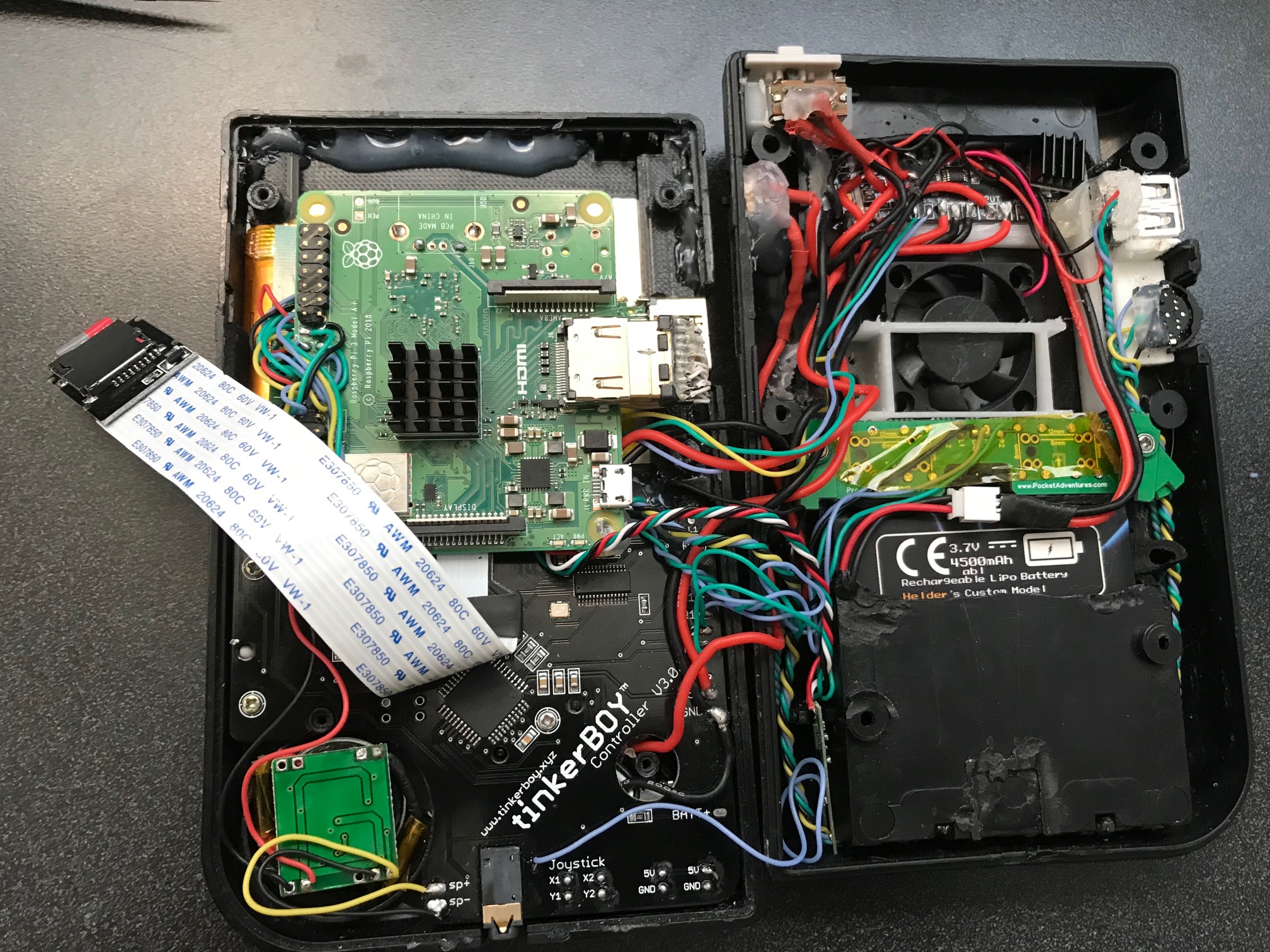

This one was in the works for a long time, but I think I'm finally "done" (or as done as reasonably possible). i've had it in working condition before, but I was never totally happy with it, and now I think I am (mostly, anyway).
Highlights:
  • Pi 3 A+
  • Temperature-controlled rear fan
  • LED backlit buttons, with H/W switch
  • Dual analog controllers
  • "Wide Angle" SPI Screen (Looks amazing! :D :o )
  • Digital Volume and Hotkey
  • HDMI Connectivity

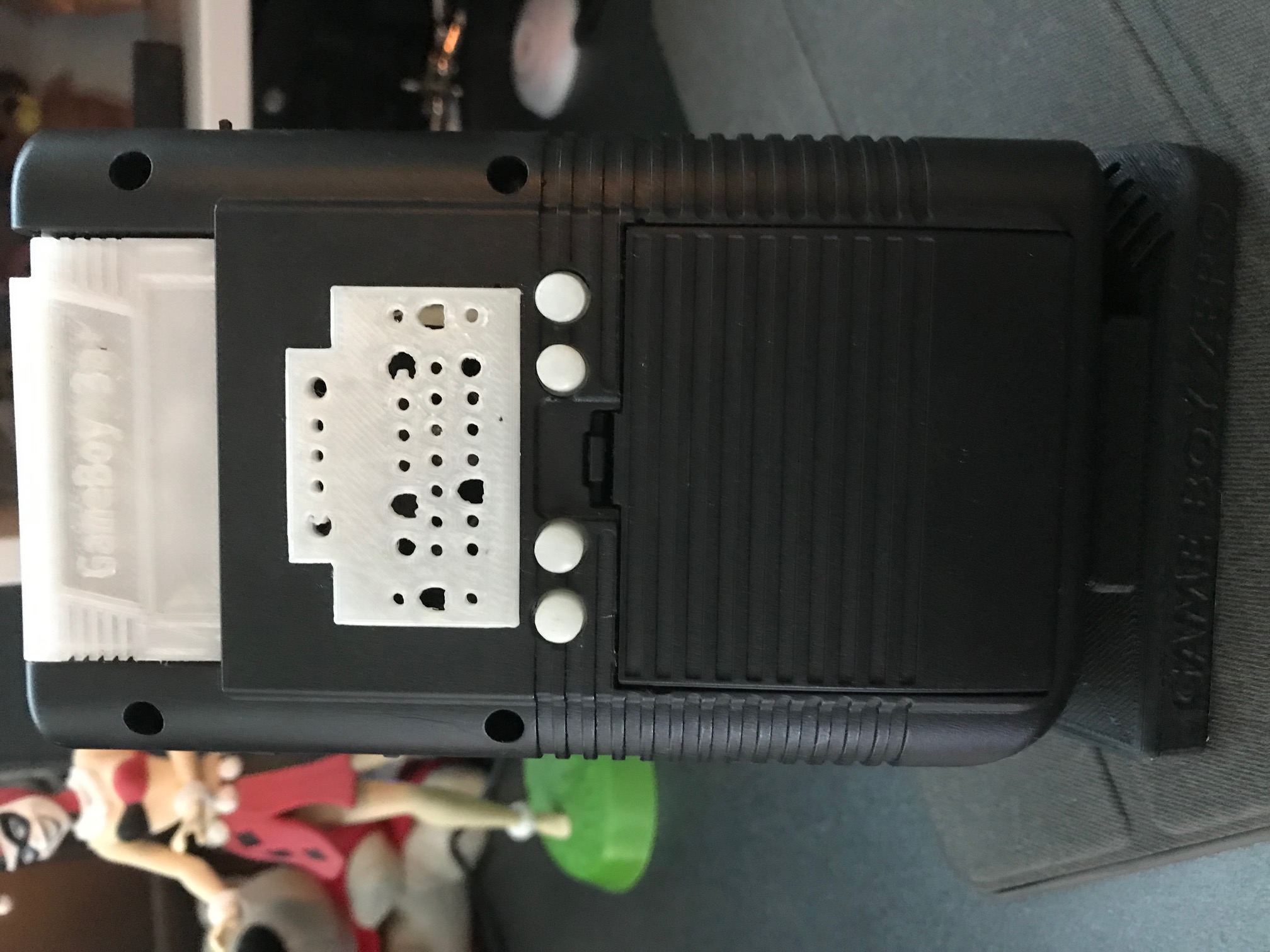

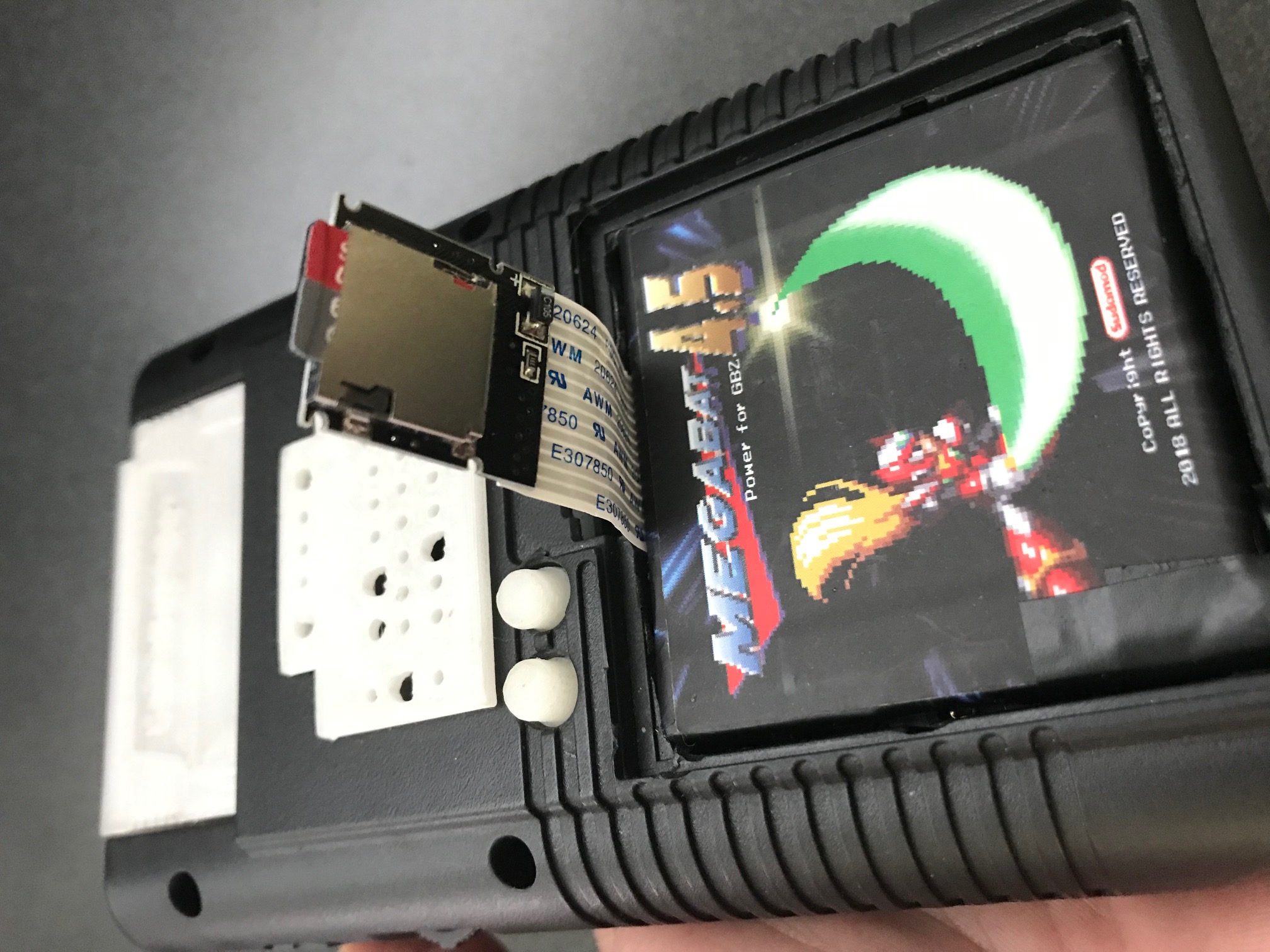

Originally, I was trying to fit HoolyHoo's Bracket in here, but my insistence on keeping the HDMI Out in the build conflicted with that, and I just couldn't make that work.
So, next I reworked a 3d model and made use of four tactile buttons on the sides in the rear, since the pi and the BW Screen variant I had in there took up most of the main area... but I wasn't very happy with the buttons, and that screen seemed to be a huge power drain for whatever reason, so I pulled that out and put a Gearbest in, and that was.. ok... a little better life, but it would get really hot, and I couldn't fit a fan in there with the control board for the screen and all.
And so, I thought an SPI screen would be ideal. Low power, (almost) no control board, good picture quality, and pretty cheap... but since I had no experience with doing SPI, I first opted to build some GBZs to get my feet wet. That went well, so I was able to come back to this one, pull out the GB screen, and start figuring out how to get the fan back in there.
I designed a holder that could fit in the rear, if you cut out the two spots where stickers normally went.. the models are here which fit really well above a Pocket Adventures rear bracket prototype that I had (I designed some buttons and wells for a four button layout). That worked ok but the buttons are pretty close together and not the most comfortable to use.
Using this guide as a starting point, and ab NPN transistor, I was able to control the fan turning on and off with software, based on the CPU temp.

I also opted for digital controls, so that I could use this Nav Toggle as a hotkey for the battery monitor and shutdown. I had to tweak the volume script that I wrote for my GBCZ build a little to get it working with USB audio...

For some reason, I could not get the on-board audio to work on the Tinkerboy board, which was very frustrating. Luckily there was still a free USB port on there to use, so I hooked in this tiny audio adapter and an audio amp for the speaker, which I got working pretty quickly, but I'm still bummed about having to stick those extra components in there, not to mention the extra power draw from them... but, oh well, "working" is better than not.
For the screen, I am using the JUJ ILI9341 Driver and I am also using Sixteenbit's fork of HoolyHoo's MintyBatteryMonitor but it took a little tweaking to get those two things to work together. Essentially, in MintyBatteryMonitor.py, "changeicon" method, I had to change the X/Y coordinates in the PngView call to be x=570, y=10.

Nice job! Does SPI screen work without tearing? 3,5" Waveshare?

how did you get working the mintybatterymonitor together with tinkerboy´s pcb, which is arduino based controls...? The mintybattery monitor need gpio input with adafuit retrogame...

thanks. it's a 3.2" ILI9341 screen, 18-pin flat cable (i used this adapter from Pocket Adventures to make hookup easier). i can't find the exact link. it was likely from aliexpress, i think.
i looked for one labelled "full angle" (aka "wide" angle) which looks a little better than other ones i've used. there isn't as much of an interlacing effect. (from what i understand, those screens were manufactured for vertical mounting, with the pixel alignment that way, which causes that interlacing when you are looking at them in horizontal mount)
I haven't seen any tearing at all using this setup. Some N64 games do not run at full speed, which is expected, but others run at around 55-60fps, and i haven't noticed any slowdown on other systems. PSX plays pretty great. :)
the minty monitor wouldn't work with the v3 board, directly. i used Helder's Retro PSU and its built-in ADS-1015.
to use the atmega one on the tinkerboy board, you would have to use the GBZ Battery Monitor. I believe you just need to edit the HHBatterymonitor.py file, and change ser.write('1') to ser.write('9') before running the install, but i know other people have issues with getting that working, and i actually prefer the minty one, since it has the option already to hide the icon with a hotkey, and sixteenbit's icons look really nice on the build. (at some point soon, i might fork it myself to incorporate some improvements and adjustments i've been making too).
(you do not need retrogame though, for the minty option - retrograme is a different overlay that maps GPIO to keyboard inputs. the minty battery monitor uses the SDA and SCL pins to read it's voltage output off of the analog input on the ADS).

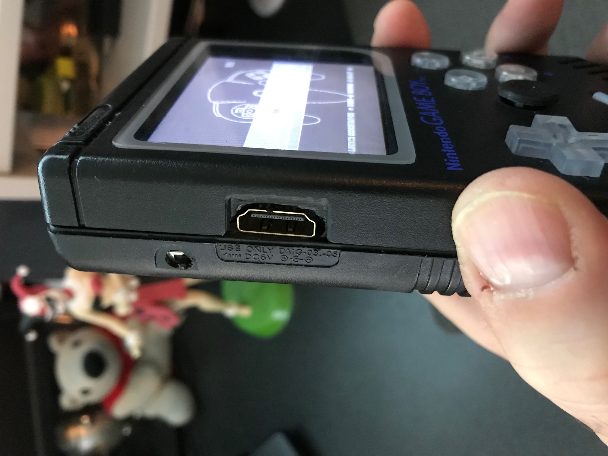

I just wanted to know how did you manage with the HDMI port to extend it ? I really want to have this feature on my build...
Thanks
i used this extender and just cracked apart the case of it.
look for one of these that can bend at a 90 degree angle and it should be similar to this, with the cables and not a circuit board.
there's also some flat cable stuff you can use if you need it longer. i've used these from adafruit but you can find them elsewhere too.
