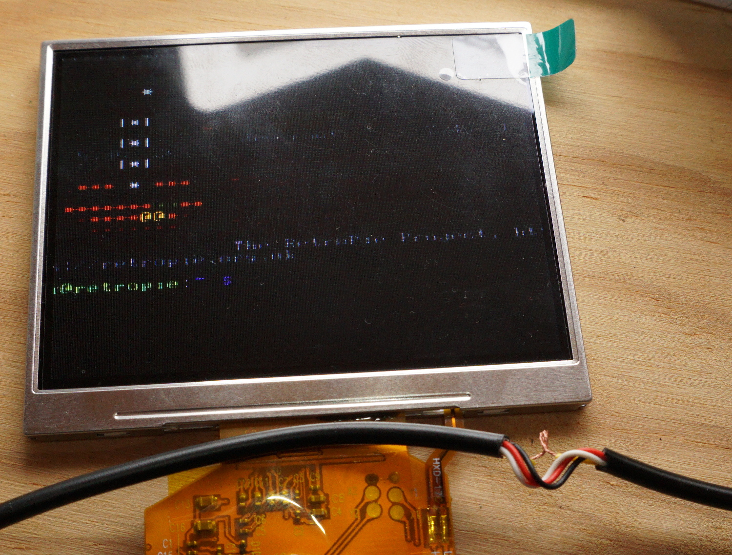

I'm just starting out my very first build but I would love some help with the screen connections.
I'm using a Raspberry Pi 3 and I soldered PP24 to the yellow cable of the screen. No output.
In an effort to debug it, I tested the connection with a Raspberry Pi 1 Model B (I only have a cable for the old Composite Video connection and not the new 3-way Audio+Video). It worked.

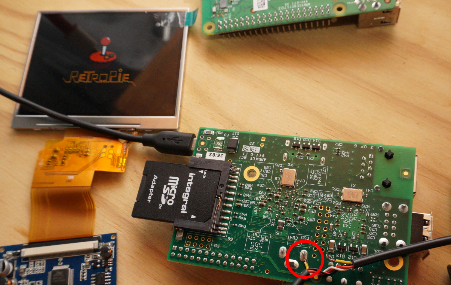

I then touched the Composite Video Out with the screen's yellow cable like so:
And it worked...... but only when I have the yellow RCA connector plugged in anyway!
Knowing that the yellow RCA plug usually has a grounded cable for shielding, I tested the Raspberry Pi 3 pin while connecting the yellow RCA cable to the RP1 Model B's plug (that should provide the ground but not the video). I got the same black screen as before.

Let me stress that I'm not using an RCA cable on the RPi3, I'm trying to connect PP24 from the RPi3 to the screen, is that what you're doing as well with your Pi3? Check the red circle in my photo for a RPi1B equivalent.
So right now my hypothesis is:
If the RPi1B composite pin doesn't work unless the real yellow RCA cable is connected (even if the yellow is cut off), I'll never get this to work in RPi3 without using a cable as well OR getting the RPi1B to work without the dummy cable. Could it be that the pin only outputs if the port has a cable OR the entire port is missing? That would mean this would never work without completely desoldering the port.

Post by 144TECH » Mon Aug 07, 2017 5:12 pm
Arlanthir wrote:
Mon Aug 07, 2017 4:01 pm
Here you go: https://cdn.instructables.com/FT9/38Q3/ ... MEDIUM.jpg
(it's not really pp24, but right below left) on pi3 it should be pp24 leading there anyway..
Anyway, you can touch the wire here to be sure if it works, see : https://cdn.instructables.com/F20/EET3/ ... MEDIUM.jpg
Boot it up it should work. otherwise there's something wrong.
Don't forget to connect ground also, not just the rca wire alone.
Let us know. :mrgreen: Greets 144Tech

Well this was a very newbie mistake. I was connecting the shielding ground of the yellow RCA to the RPi1B because I didn't have a plug for the RPi3 port. I didn't know it made a difference but the ground needs to be from the same Pi as the video signal. I improvised a connection between the yellow RCA and the RPi3 ground and it worked as expected.
I used port PP24 for the video signal and a GPIO pin for ground.
