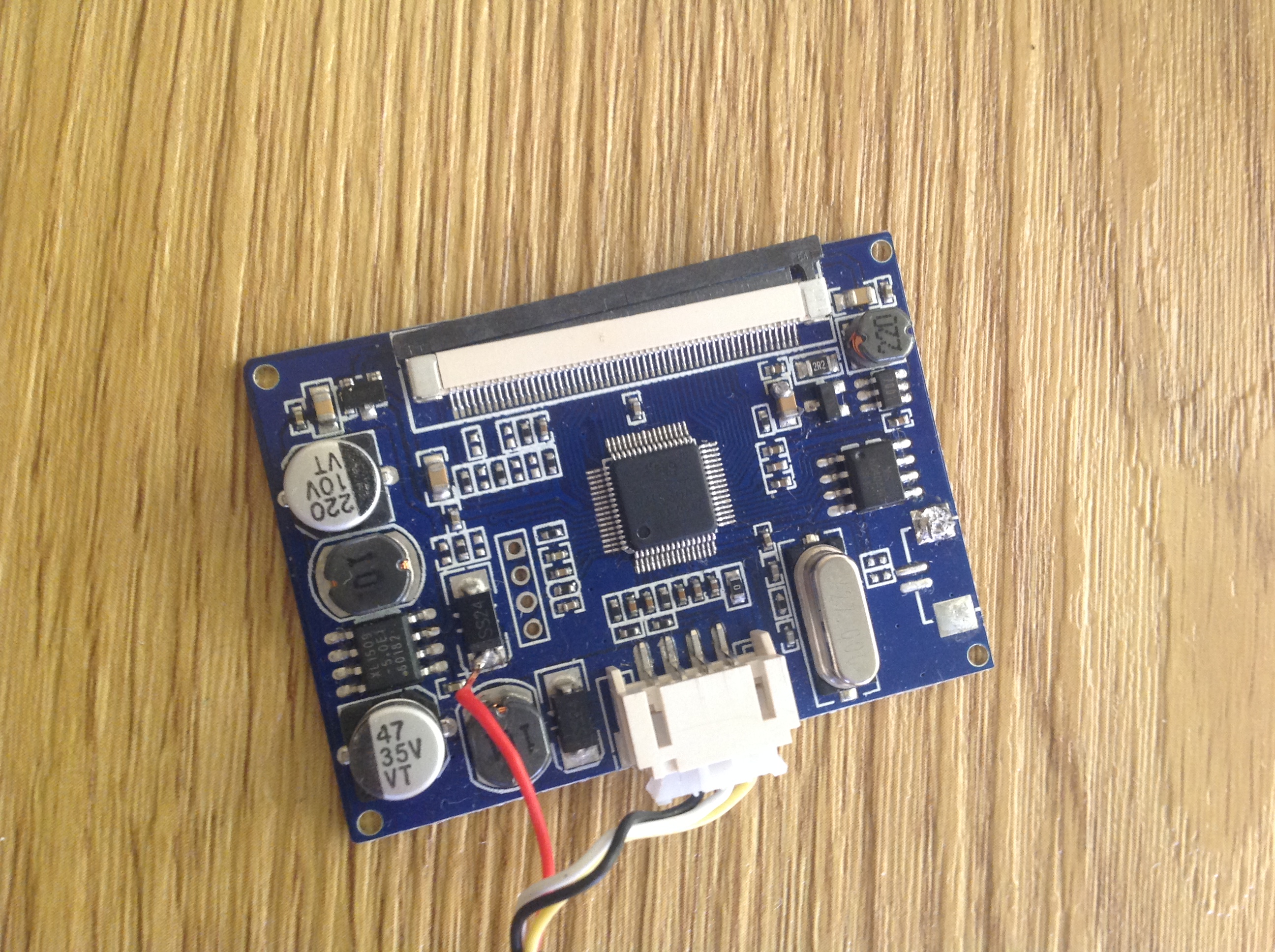

HI team, I finally picked up one of these screens for my project, but i cant seem to get any life out of it... can someone point me to where i need to stick my 5v?

the screen looks like a gearbest screen.....
just wire it up and see, i think it should work as it is (no modifications needed)
Try:
5v RED to PP2
GND Black to PP6
Composite Yellow to PP24
Also, even if your board looks slightly different on the back the test points should still be the same
(ie PP24 = composite PP25=audio left PP26=audio right and so on)....

I have the same lcd board. This one works on 5v-12v without any mod but isuggest you solder the red wire directly to a 5v if you're using a 5v power. Please see picture.

I have the same lcd board. This one works on 5v-12v without any mod but isuggest you solder the red wire directly to a 5v if you're using a 5v power. Please see picture. IMG_1611.JPG
I've never done that mod. What purposes does it serve?
