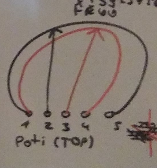

I may have used another Poti. I "destroyed" it, to see how it works and it looks like this:
However in the Link you Posted they placed the Pot after the Pam8403:
( My setting is Pi -> Pot -> Jack |
-> Pam8403 -> Speaker )
Could that be the Problem??

The "conventional" way is to place the pot before the amp. But I see people here put the pot after the amp.
There is a post here somewhere that discussed this...

I think it depends on the exact components you have and what they can handle. Personally, I used a second hand pot from an old device, and placed it after the amp. After a minute of use the pot was burning hot. It couldn't handle the current, so I placed it before the amp instead and had success.
