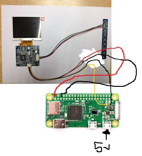

Meanwhile: DHL texted me to say that the Xianjie screen will be delivered at my home on monday.. I can't wait! But I'm thinking about the correct wiring to test it, as it comes with two connectors (one for the video input, one for the power) that do not match/connect with anything I have in my house. Is this wiring correct (sorry for the quality..)?
Also: from the pics Xianjie sent me it seems that they will send the screen with the board not already attached to the back of the screen: a little strip of double-sided foam (for general purpose) will be enough to keep it in place?

Pretty sure your wiring looks good.
As for attaching the board to the screen. Some double sided tape or hot glue will work fine.
