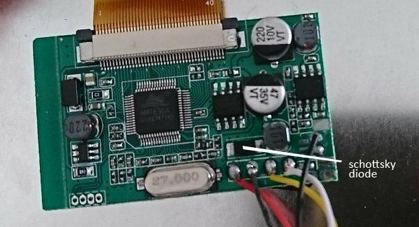

Hello there,
I have seen the beautiful work that this community has done and aswell seen the list of screens made to be used with 5 V. I ordered myself a 4.3" 480 x 272 px (I know it won't fit the regular Game Boy casing, but I have a 3D printed case I made myself. However it doesn't seem to want to work with 12V (Tested using a GameCube as a composite video signal) The board is quite small and my best guess is to solder positive and negative respectivly to the schottsky diode. However I am no expert and would like a second opinion, can anyone see a better way of making this board work with 5V?

Hello there,
you need to sort the image out....
either upload as an attachemnt...
or use the BBCode link to paste your image from imgur....
i've done it here for you....

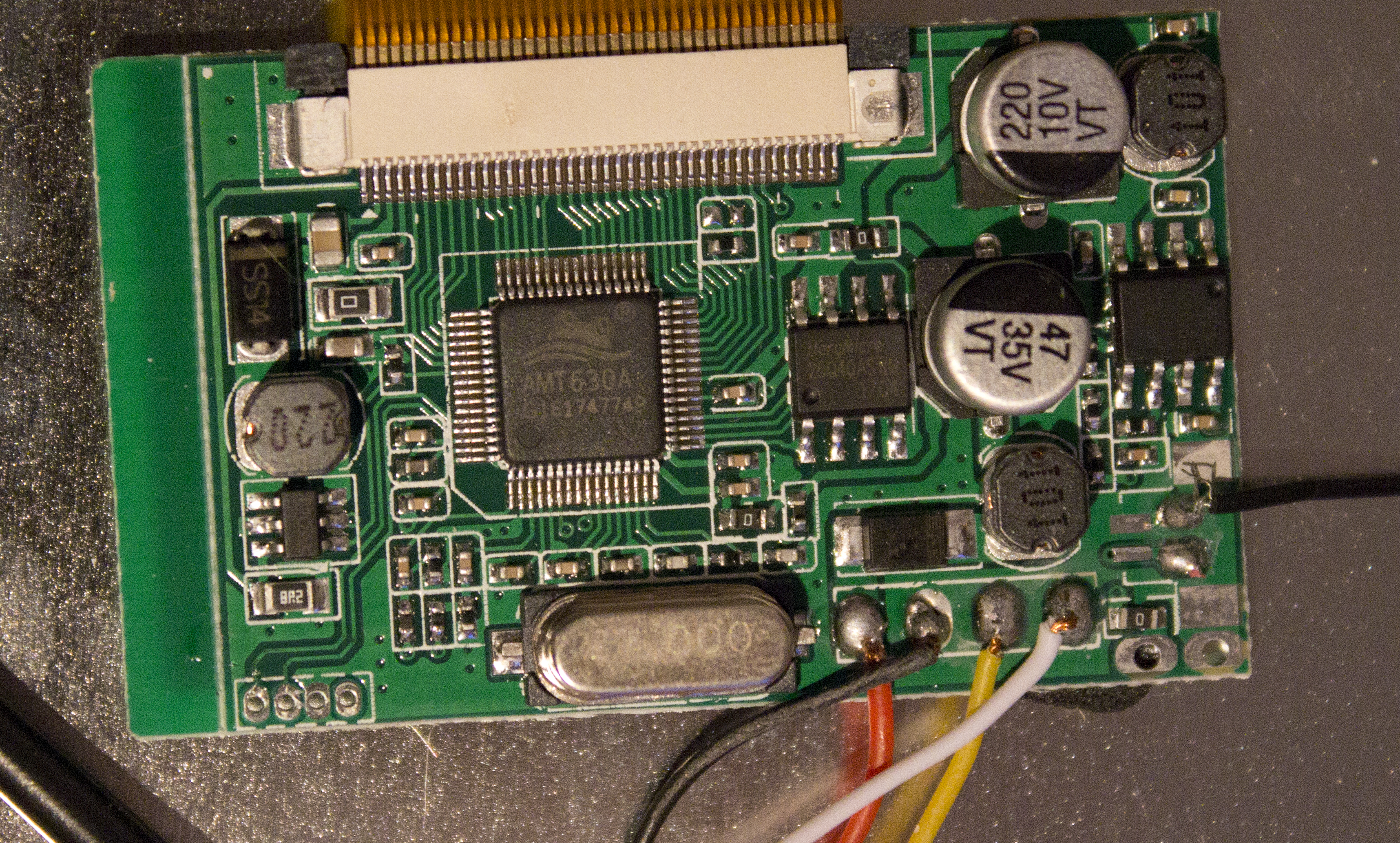

can you provide a clearer image of the board...
especially of the 2 chips located near the diode you highlighted....

Post by MrLuck » Thu Mar 01, 2018 9:50 am
Absolutley, here is a better image
The PNG version was to big to upload, but I hope this jpeg does the job aswell.
PS I know that there is a red wire missing on the right next to the black wire, they are the connections to the buttons for screen settings.

Post by jakejm79 » Thu Mar 01, 2018 12:39 pm
You'll need the test off the two 8 pin ICs, that said you could probably get away with soldering to the +ve side of the capacitor marked 10V.

Post by Hex » Thu Mar 08, 2018 2:53 pm
In case you are still looking for a solution:
See the 4 pads on the bottom left corner? the first pin from right is 3.3V and the second is GND. those are the only 2 pins you need to power the display. Then just connect a yellow or white wire to the Pi and you will have a working lcd
Here is another board that has a similar IC and the 4 pin.
