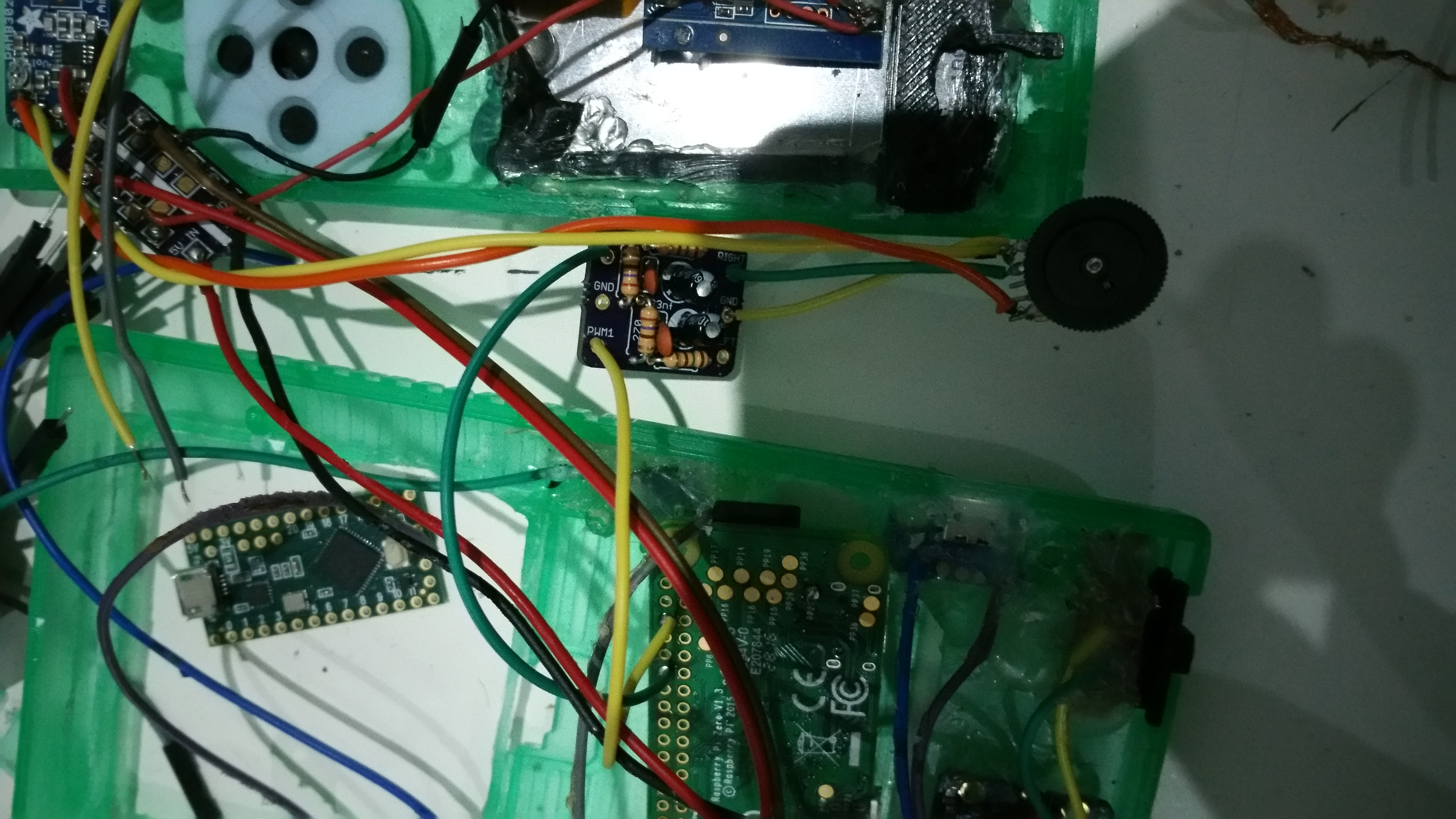

Following wermys guide I'm going for mono sound aswell so will I only need to connect the right channel output from the low pass filter.
I've soldered the resitors to the board. Ill attach a picture as I'm not too sure if what I've done is correct.
Any help is much appreciated.

Post by GunZi » Mon May 21, 2018 7:08 am
Looks pretty good to me if you're going for the right channel. But since you're doing mono sound you don't need both PWM0 and PWM1 at the input. As far as I can tell just by looking at the pcb, leaving either PWM0 or PWM1 should be ok.
