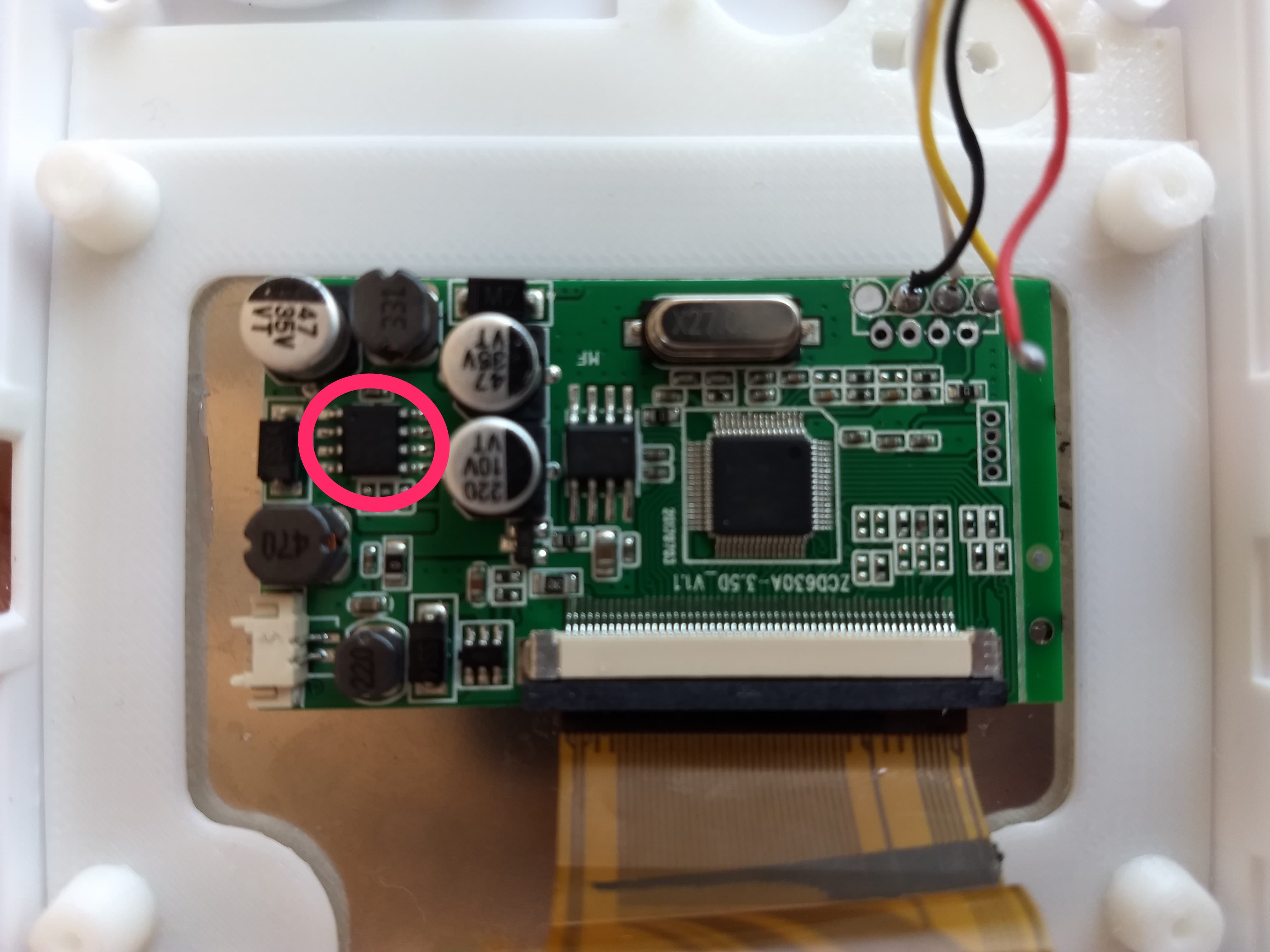

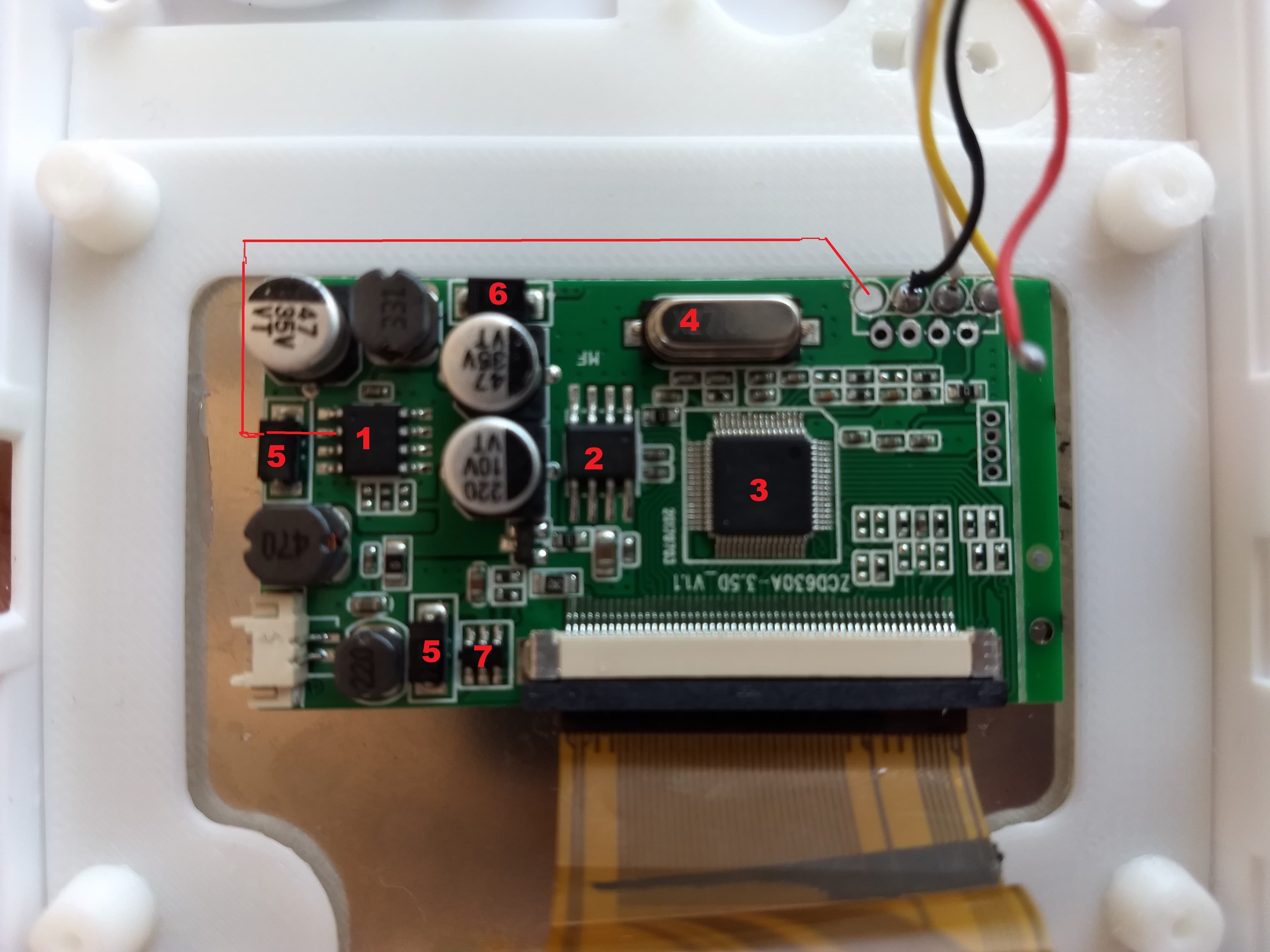

Hello,
I have a problem with my screen, the dirver is not on the Wiki Sudomod. This is the ZCD630A-3.5D_V1.1 driver. So I am stuck in the realization of my Game Boy Zero.
On the Wiki the variant n ° 7 is the closest one but it is not identical.
Here are my questions:
1 - Do you have any idea of the modification to bring to my screen to pass it in 5V?
2 - If I make a mistake in the connection (modification of variant 7 and it is not the correct change) my screen will die?
Thank you

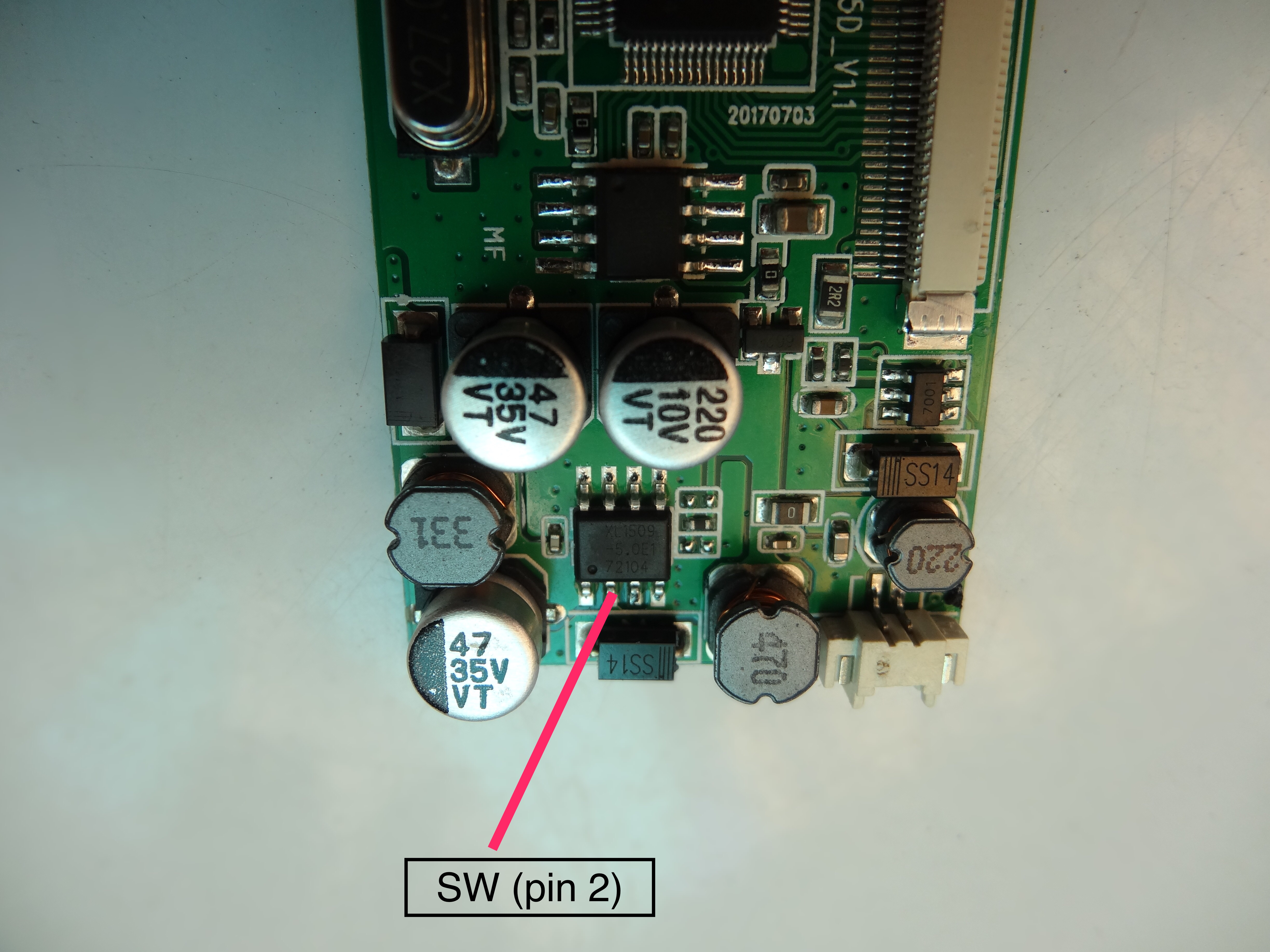

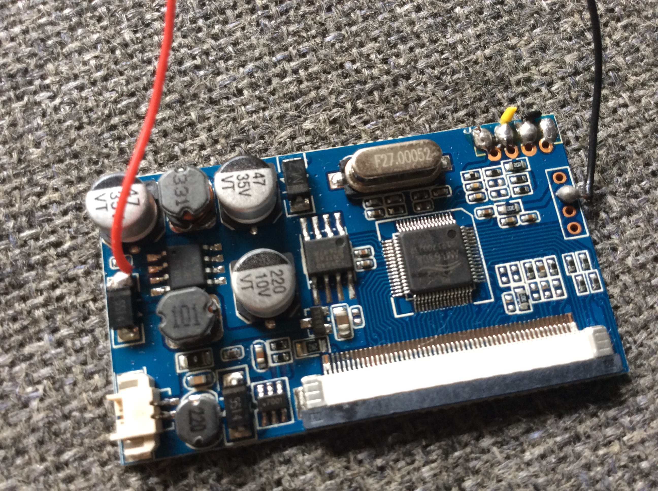

It looks similar to mine. Can you send another picture so I can clearly see the chip with the red circle:
Here's my screen board with the 5v wire directly soldered to a diode beside the XL1509 chip(5v regulator).

Post by Florian » Sun Jul 08, 2018 7:31 am
Hello, I looked at the chip you indicated on my publication.
on the one you have designated it is mentioned:
XL1509
-5.0E1
72104
tinkerBOY

Post by tinkerBOY » Sun Jul 08, 2018 7:45 am

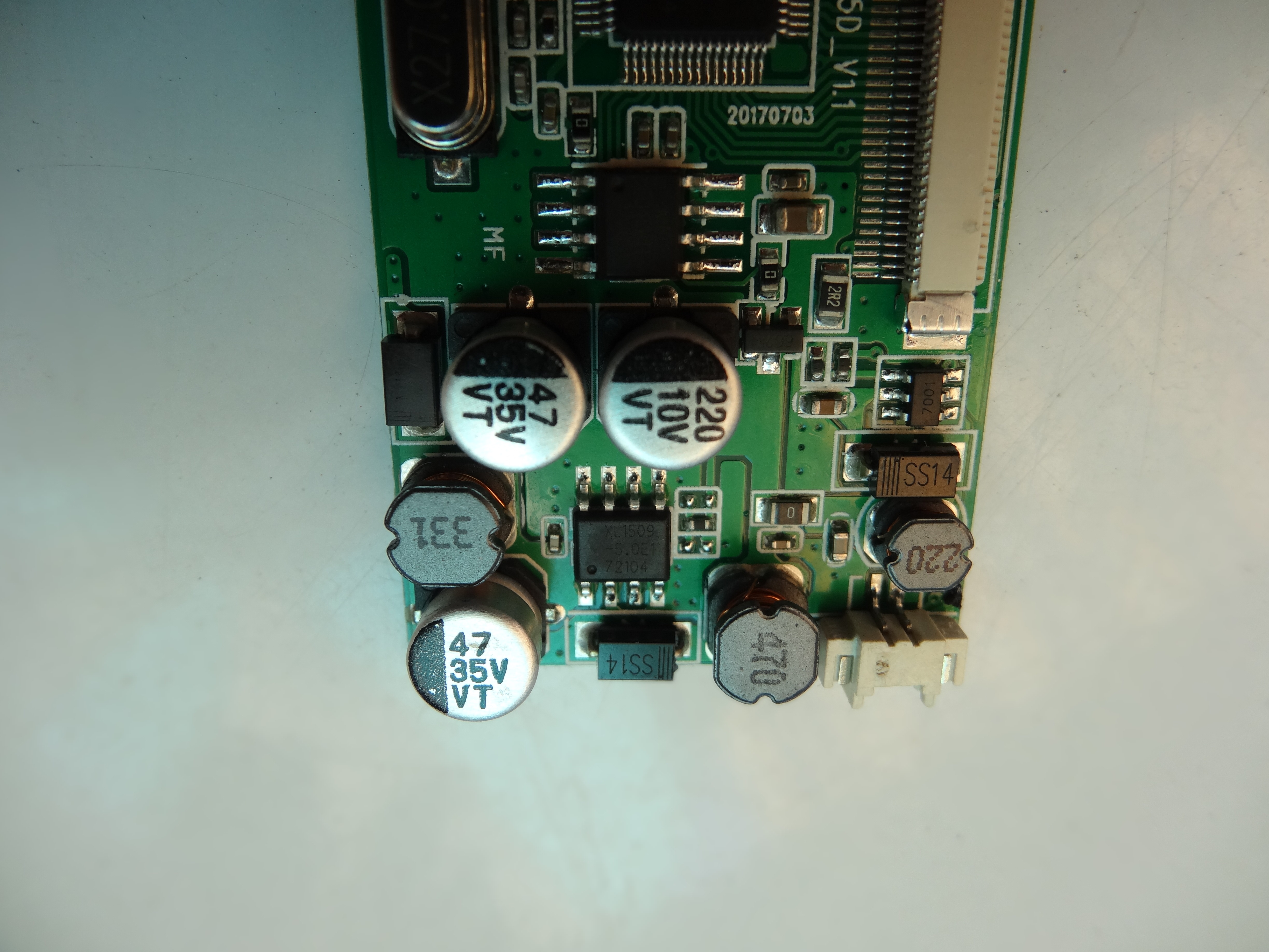

Most of these screens use that chip.
Here's how to directly wire the 5v wire:
Here:

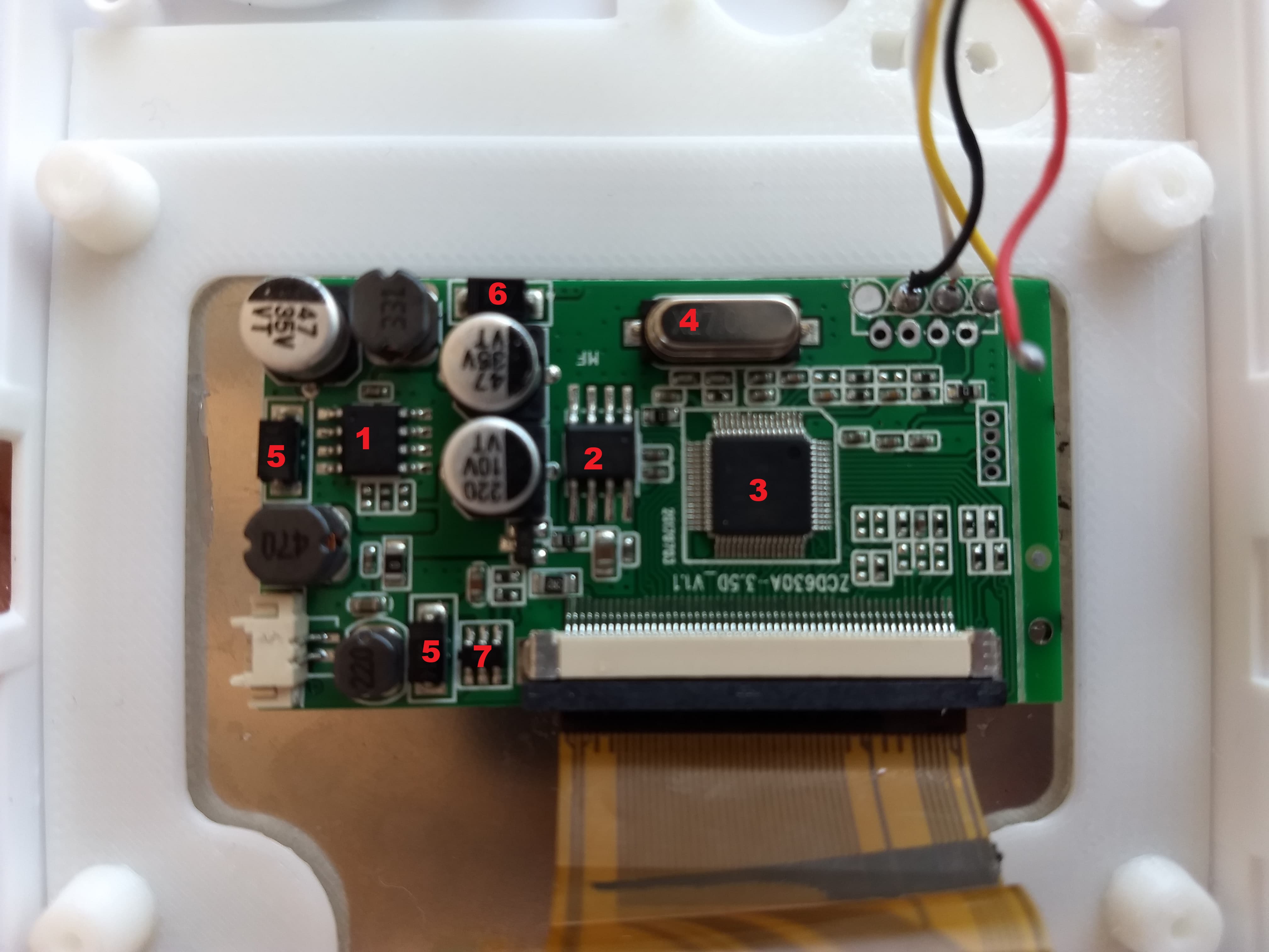

Post by Florian » Sun Jul 08, 2018 7:53 am
The components bear the following inscriptions:
1 -
XL1509
-5.0E1
72104
2 -
MK
25D403TiG
3 -
ATM 630A
G173460914
4 -
X27000
5 -
SS14
6 -
M7
7 -
7001
tinkerBOY
Posts: 710
Has thanked: 294 times
Been thanked: 206 times

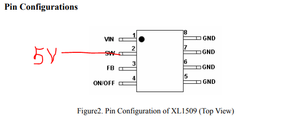

Re: [Help] Screen not on Wiki - ZCD630A-3.5D_V1.1
Post by tinkerBOY » Sun Jul 08, 2018 7:56 am
Read my previous reply above. That's where you connect the 5v, to the pin 2 of the XL1509 chip.
Post by Florian » Sun Jul 08, 2018 8:00 am
So in the end the modification must be done so, is it correct?
tinkerBOY
Posts: 710
Post by tinkerBOY » Sun Jul 08, 2018 8:11 am
Yes that's correct.
