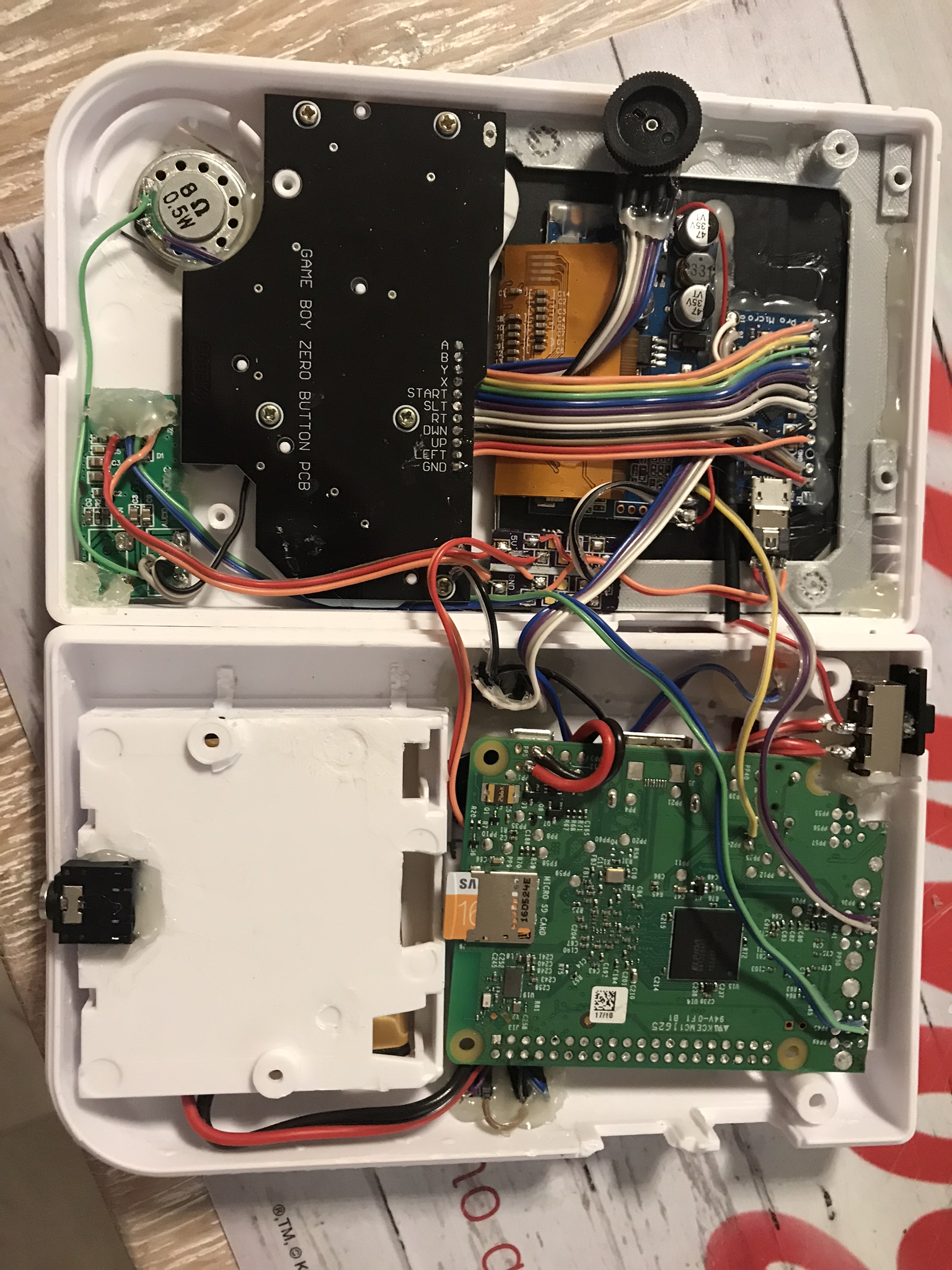

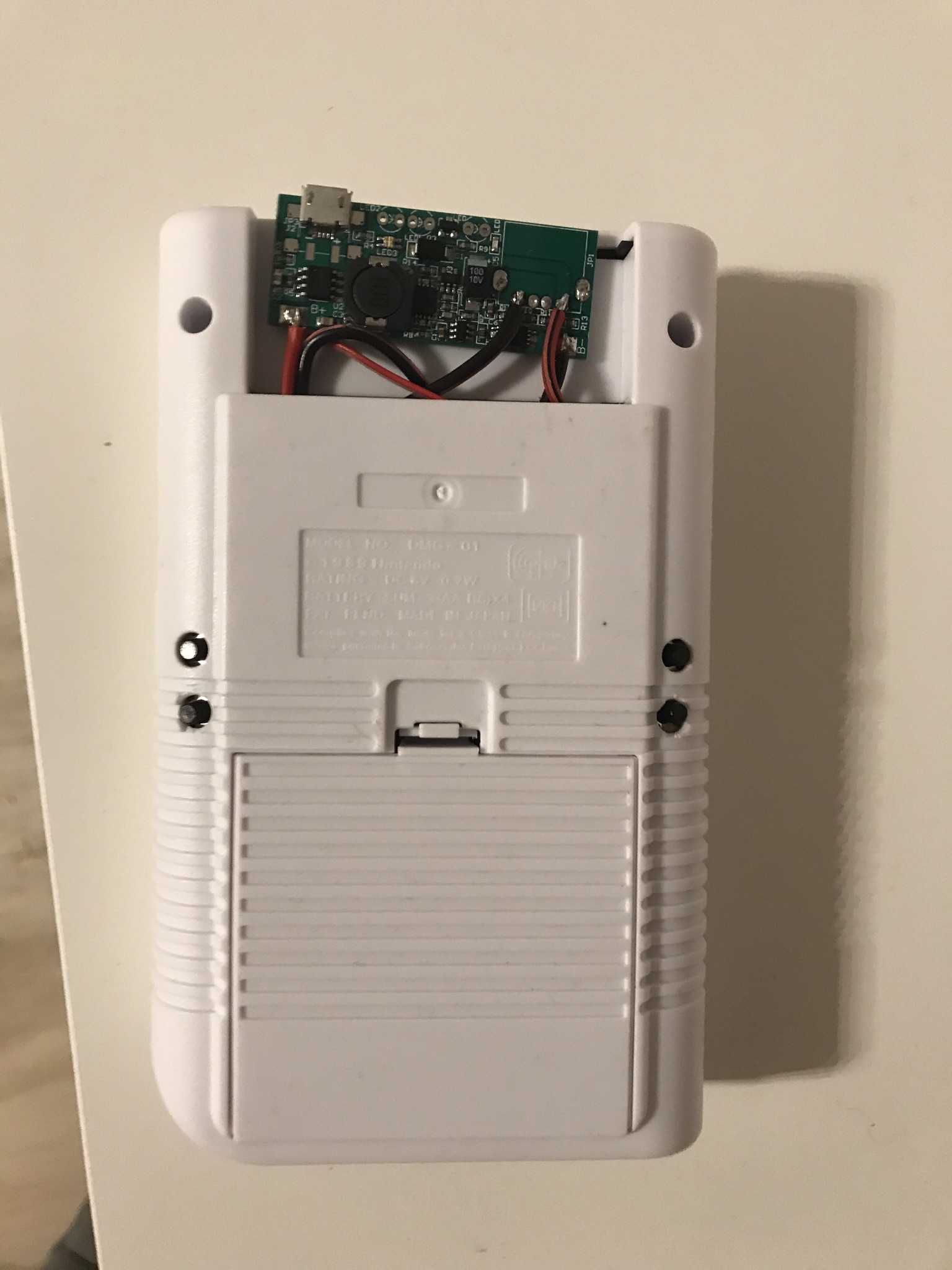

Hi i’m done with my third build and i can’t figure out this thing
I’m using the powerboost from gearbest with a galaxy s2 battery
All the system works perfectly while 5v charging input is connected but as soon as i remove the cable it shuts down
I changed the powerboost with a TP4056 and it works but the power is not enough so it shuts down or it goes realy slow, i bought a new powerboost from gearbest, a new battery, i put other 3 different batteries but i’m still having the same issue...
My build is made of:
Pi 3
Arduino pro micro
Usb amplifier
Pad board like this https://goo.gl/images/KUD8fQ
Rearview monitor modified for 5v
here a few images:
Can anybody help me?

Might not be enough to power a pi3? Could consider an adafruit 1000c (not sure it would be much better). But I'd assume it's not working since a pi3 needs 5v 2.5amp usually. While the powerboost you're using is only 5v 1amp.

First disconnect the powerboost and battery, connect a microusb cable from a good power adapter, turn it on, and play for a bit while. If everything works then you have problem with your boost or battery.
If the GearBest PowerBoost can deliver 1A then it should work fine but depends on how many devices you're using with your build.i have tested it with a couple of Pi3 but not with actual build. I use it for Pi zero builds most of the time.

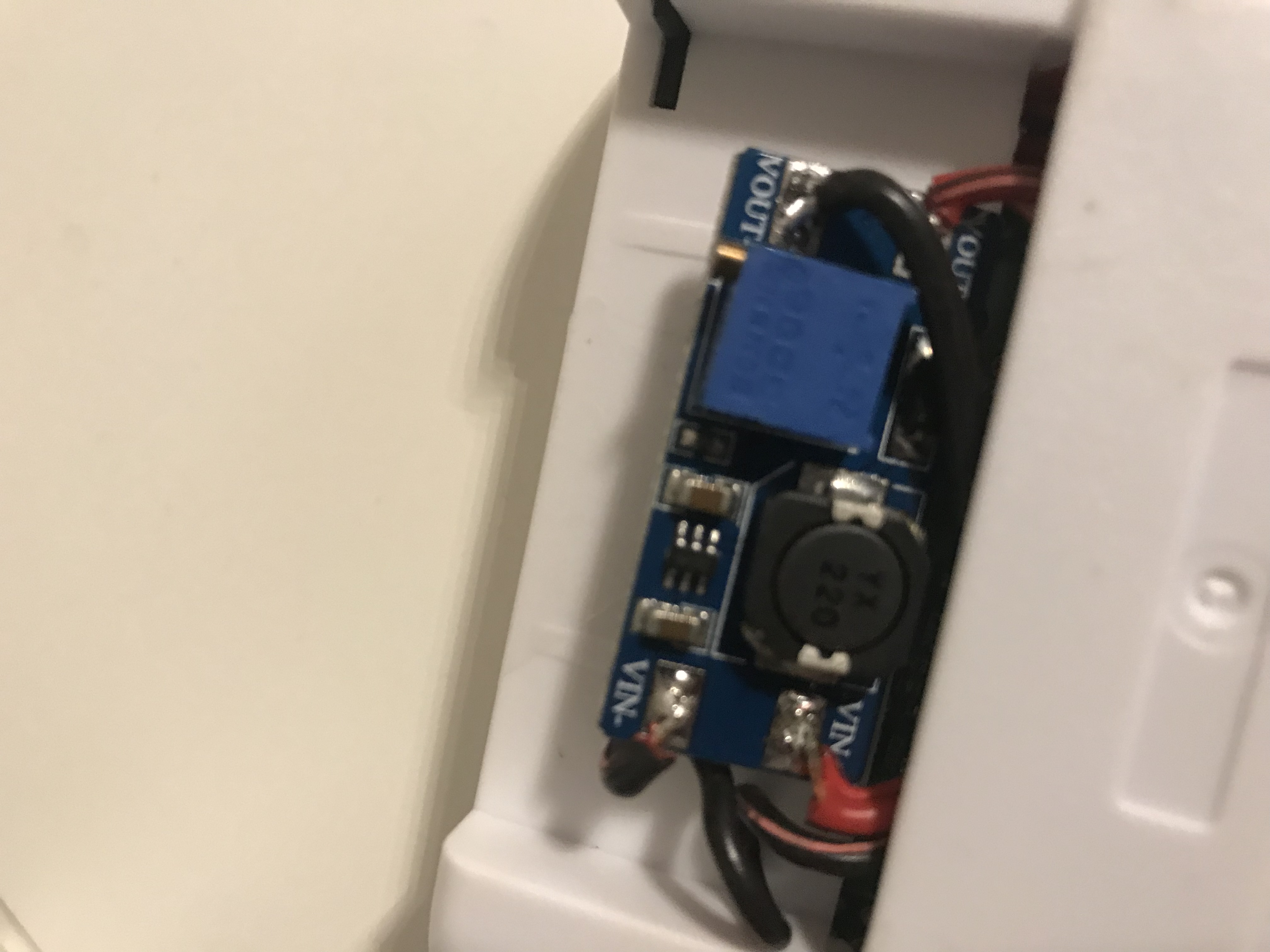

I often use this 5v Boost module for pi3 builds. Has nice heat dissipation pad at the bottom.

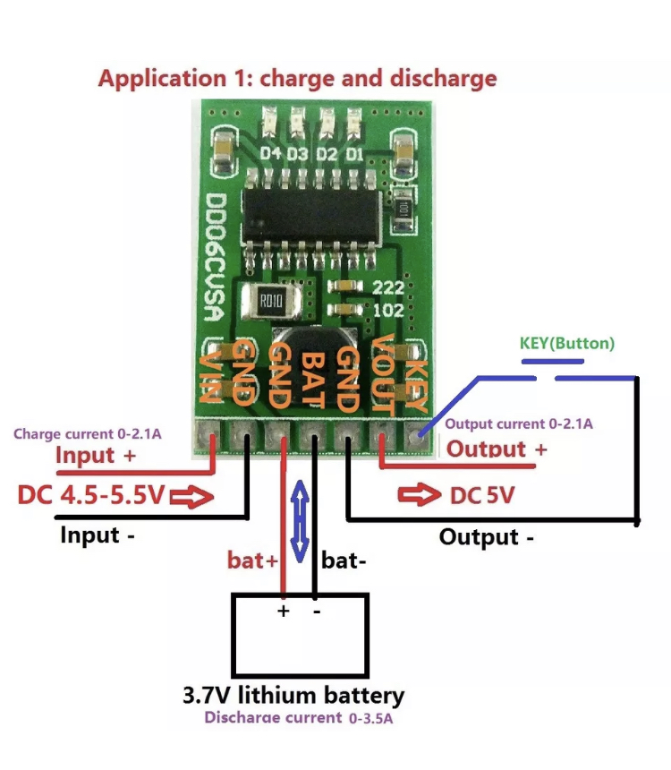

Thank you guys, i tried powering it up with just an ipad charging adapter that provides 2a without using the power boost and it works so i decided to try this
It s not the first time i see this, i remember someone in the forum used if in his builds
I ll let you know

yeah, i have some of those at home, they work fine, only problem I notice, is that when you have a micro usb plugged in to the input (charging), and unplug it, the power dips, and the pi shuts off. Not an issue if you don't unplug it, or if you unplug it when it's powered off.
I have not yet looked into a way to avoid that. But it would be nice to see how they work for you.

Today i tried with this
which gives 2A output and still nothing...

First problem solved using a 18650 battery
But now...
I think i really need more than 2A 😩
