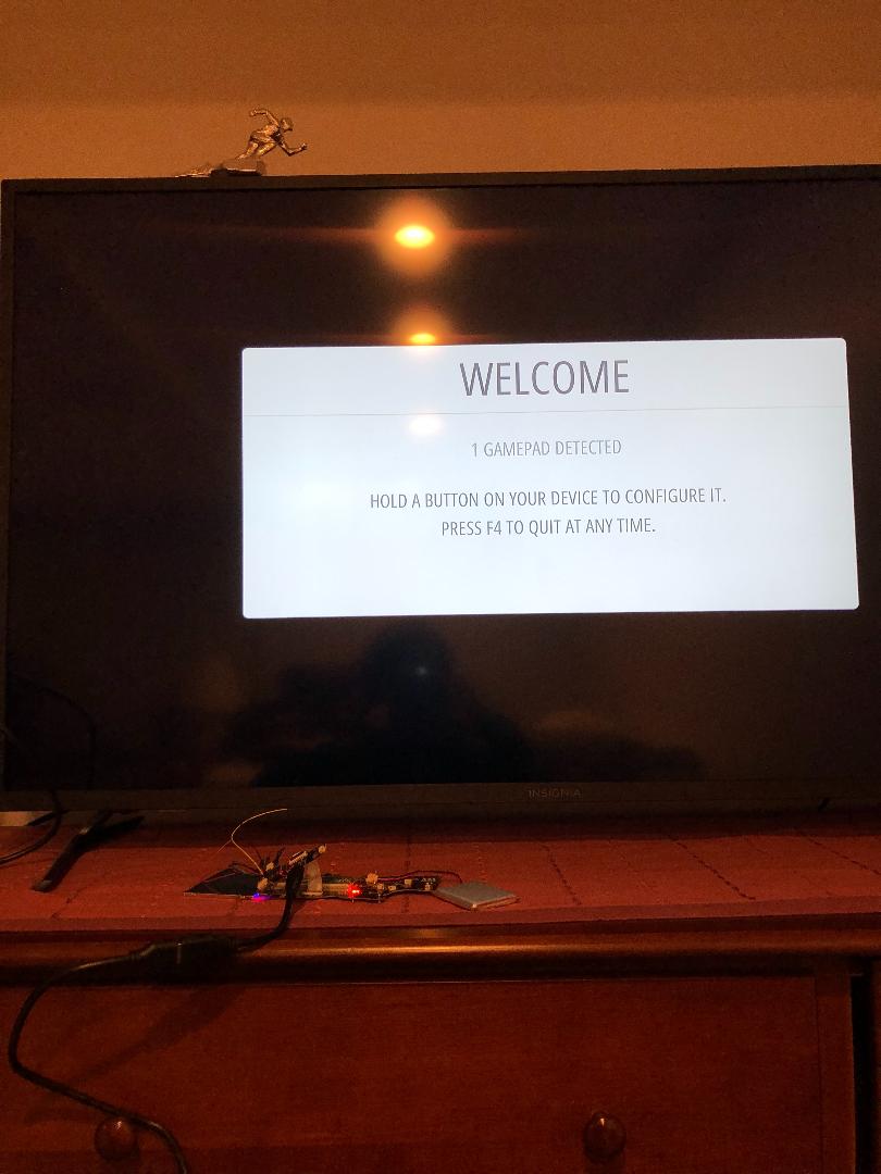

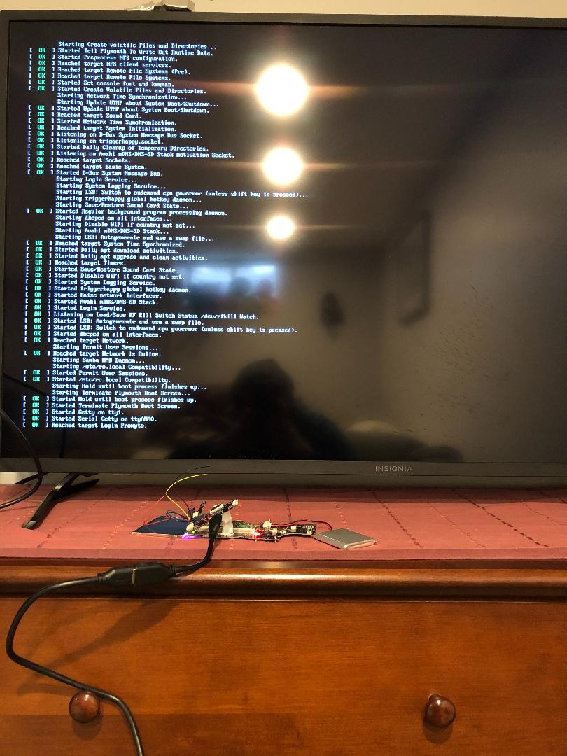

Hi everyone!
Sorry if this is a really stupid and simple question, but this is the first time I'm doing one of these builds.
So I downloaded the retropie 4.4 image (pi 2 and 3 version) and wrote it to my SD card, but it seems I'm only getting a display through my HDMI port and not my LCD when I boot up my board. My LCD is just a black screen with nothing happening. Is there some kind of coding I need to alter in the files? or did I just do something wrong?
I poked around on the forums but can't really seem to find an answer for this.
Thank you,
Jeff
