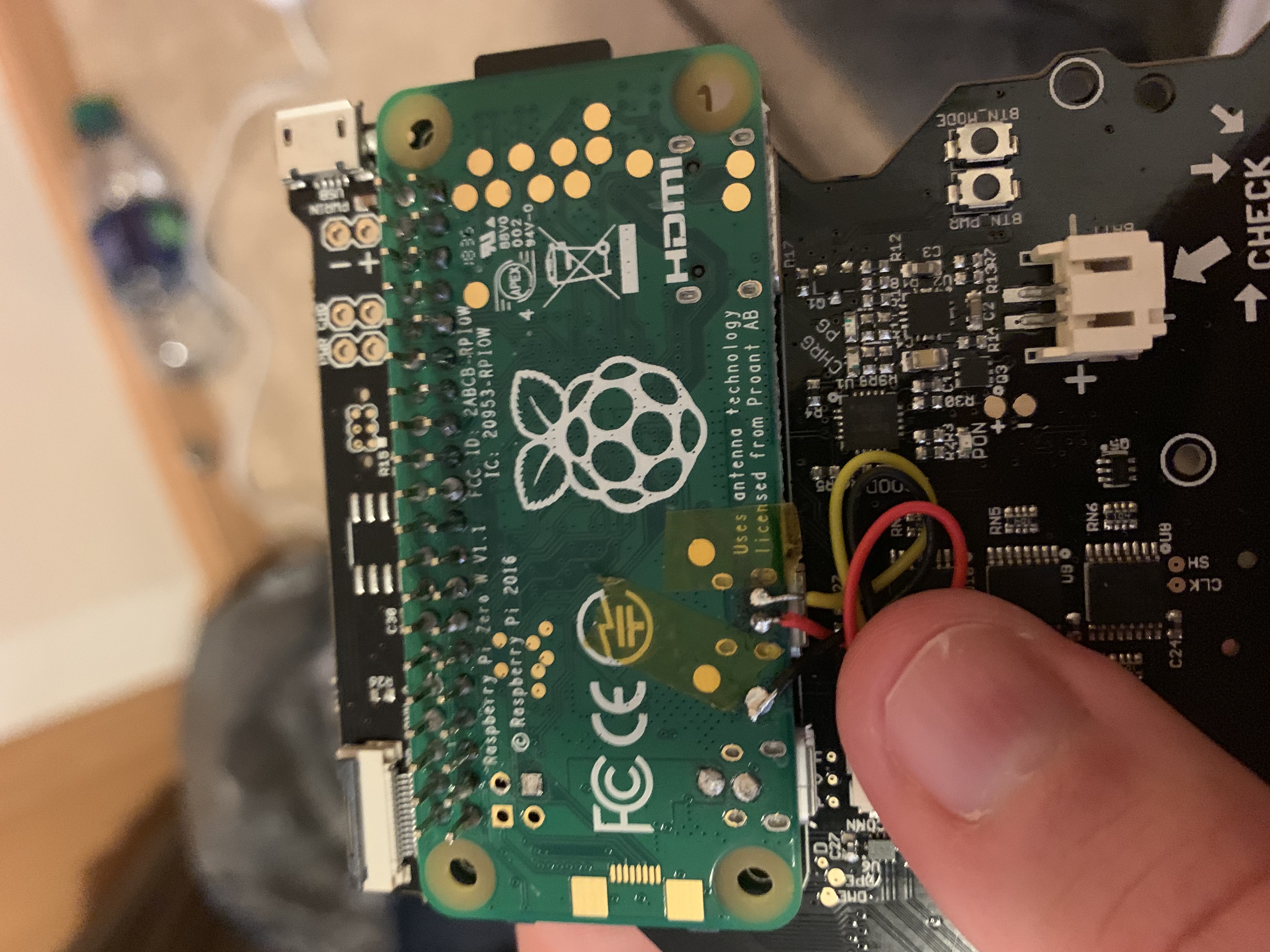

I am not sure what’s going on but I just completed a kite circuit sword lite build. Everything is fine except there are weird blue shadows all over the screen. Any ideas?![Image]()

Re: What’s wrong with screen
Check your soldering, it'll be one of the pins
Show pictures of your soldering on both sides
Not the best but here
Ok cool, could you run it in tester mode and show a picture of all the colour bars please?
Ok there is def one pin of blue not soldered, you can see it by the blue bar having 'blocks' on it.
This picture is of the bottom of the board, rework these (the ones highlighted in brighter green, there are 5x of them). Do the same for the other side of the Pi, but remember that the image will need to be flipped
