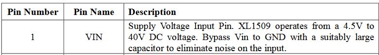

As for the screen, you need to post clear pics of the black 8 legged chips. So people can see the numbers. Or you can just look at the numbers on them and google search to find info on the chips and see if one of them have a 5v pin. If so solder a jumper to that.
Also, if you have a 12V power source, and a multi meter, simply power the screen and then probe the chip legs and find one that is reading 5v.

Here is the screen chips I'm not sure what i should be looking for schematics or something? with the audio i'm not using an amp as i thought this usb card would be okay, should i just connect the audio output straight to the switch?
mk25q40AtiG
xl1509 -5.0e1

As for the chips you listed some information. Which is good, I see that the XL1509 is the buck converter, which is what you want. I see this after googling the XL1509.
I would attempt to run the jumper wire to pin 1 VCC on that chip.
