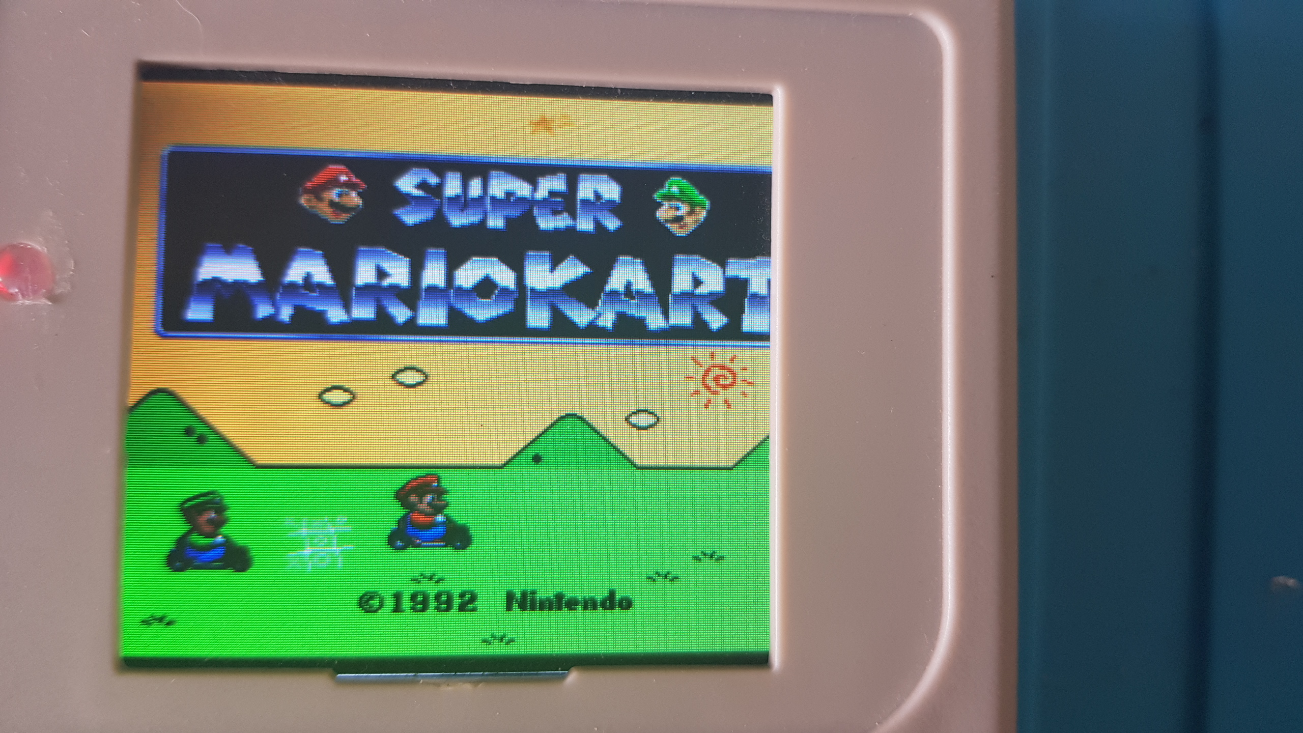

I have one last build I want to finish that was started a few years ago. It has an spi screen but the right hand side is cut off so can not been seen. The problem is with overscan within games.
I adjusted the overscan within the config text and this fixes the boot up text going off screen but once emulation station starts it goes back to normal and the screen goes off to the right.
The same happens when in a game, I have tried going into the settings on a game as it loads and there is an option to adjust to match the config but it makes no difference when the game loads it still goes off screen?

Right, I kept researching as this forum seems like a ghost town now?
The solution is actually very simple!?
There is another line within config.txt called
overscan_scale=1
It was hidden away with the audio on mine?
This needs to be unhashed.
Then it works!
overscan_scale=1
Then it works!

nice. yeah that one can trip you up (i never understood why they group it in the audio stuff by default), as well "disable_overscan".
