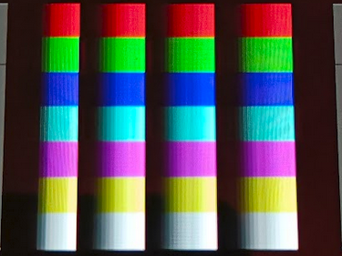

The odd thing is sometimes the screen looks fine when navigating the frontend. I get flashes of perfect colour. I ran the cs-tester.py provided by Kite and weirdly the COLOUR.png etc displays perfectly. https://github.com/kiteretro/Circuit-Sw ... /cs-tester
Also if I load each individual test PNG (BLUE.png, RED.png etc.) from that directory linked above using the command
./pngview -l 99999 RGB.png
they all load with no issue. But underneath the emulationstation screen is whacked out grey and distorted text.
Pictures: https://drive.google.com/drive/folders/ ... sp=sharing

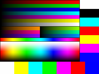

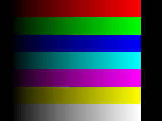

I think you are on the right way. But the test images are not displayed correctly:
should be
And
should be
There are still some problems with color gradients which you also see in EmulationStation. But so far I have no idea what is wrong. It must be the configuration, not the display itself.

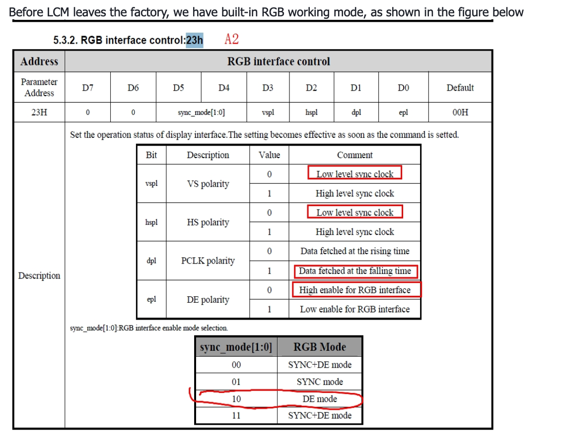

Interesting re: the micro controller, I assume that passes the display to the CM3? Although I have some experience with arduino, I'm not sure what's going on in Kites code. I have emailed him asking for any pointers to get the display running.
I had also contacted the email address on the data sheet asking for more information about the dpi_output_format stats.
They have provided this responce – any idea how this translates? :)
Screenshot 2021-10-18 at 09.39.05.png (369.81 KiB) Viewed 17218 times

This helps a little for the signal polarities. But the Raspberry Pi documentation doesn't really explain what it means with "polarity inverted"... is it high or low? We would need to confirm the timings with an oscilloscope. I have one here ;)
The microcontroller controls the SPI pins of the display and writes the panel controller registers. In Kite's public code, register 0x23 for RGB interface control is not written, so it should stay at the default value 0xA2. The remaining data pins of the display are directly connected to the Pi. The microcontroller wouldn't be fast enough to fill the screen with 60 Hz ;)
I find this display very interesting and I'm thinking about ordering one. But it would take weeks to arrive here in Germany. You don't happen to have a second display and live in Europe? ;)
