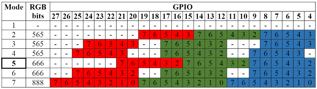

There are seven pin mappings for DPI:
DPI Pins.png (85.87 KiB) Viewed 18242 times
That's the parameter output_format you select in the DPI config generator. The Circuit Sword seems to use #5. Therefore you need dtoverlay=dpi18 in you config.txt to load the devicetree overlay for this pin mapping.
On my board I am using DPI mapping #6 because I need GPIOs 18 and 19 for audio output. Therefore I have compiled my own devicetree overlay for this pin mapping. That's dpi18_6.dtbo ;) I've attached it for reference but you don't need it.
You will need to use pin mapping #5 because you can't (easily) change the PCB layout of the Circuit Sword. Therefore this should work:

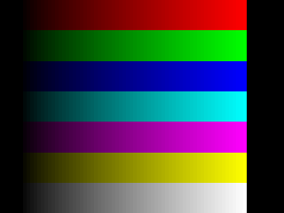

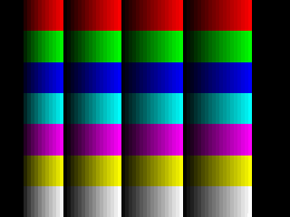

I wrote a small image manipulator to simulate RGB666. It turns out that when the colors are shifted left by two bits (D0 becomes D2, D1 -> D3 etc. and D6 + D7 are cut off), I get the same distortions you see:
Original:
Colors shifted left by two bits:
Original:
I am wondering how this shift is happening. Either your display has the signals on the cable configured differently, or it is applying the shift in its controller.

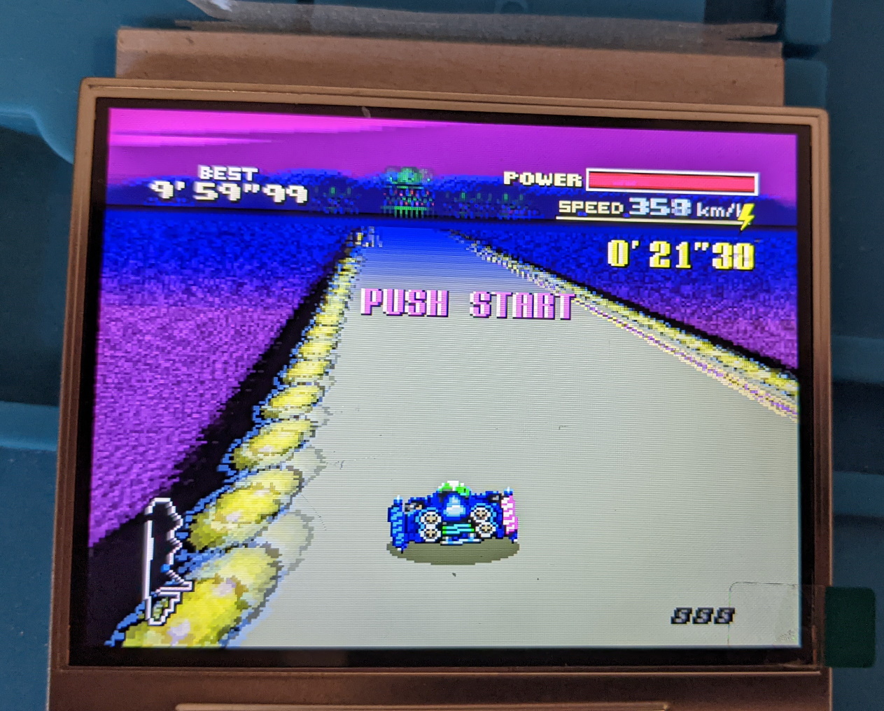

The first screen I recieved which has the weird colour shifting:
And the second screen I received from the same seller, same listing. The seller assures me it's the same, but it isn't! I can't find any timings for this one that give me a display. I've not spent much time looking, yet.

The first screen looks identical to mine, but I guess it has a different firmware. That's one of the imponderables we get with AliExpress :lol:
