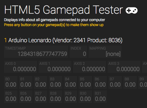

Post by 32teeth » Tue Aug 15, 2017 8:18 pm
An easy way to test the set up is plug your arduino into your pc (not your zero) and go here
http://html5gamepad.com/
You'll see your device show up as such
Screen Shot 2017-08-15 at 10.17.54 PM.png (45.53 KiB) Viewed 8749 times
Very nice tool! 👍
