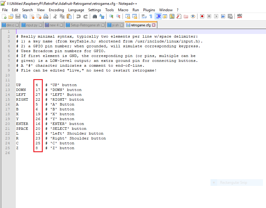

Re: tinkerboy 2.0.1
Post by tinkerBOY » Tue Feb 05, 2019 9:52 pm
Hi there again ToyRoBoHoBo!
You may have to edit the retrogame configuration file at
/boot/retrogame.cfg
You can edit the file on a Windows machine.
The numbers in the red rectangle are the GPIO pins. You have to match those pin numbers to the ones you soldered on the Pi. You can check the pin numbering at www.pinout.xyz.
