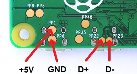

We're struggling to find out what pinouts on the RaspPi Zero that we should use when connecting the USB end of the pcm2704 to the Pi itself? There are 4 cables needed (Ground, 5v, D+ and D-) but where do those end up on the Pi?
Thanks again!

D+ and - are the "Data" in and out for usb. you need to connect them to the usb pads, or use a hub. the 5v and ground go to your power (or to any 5v and ground on the pi).
Re: Need some advice about audio (...and maybe general build advice.) Help save our build!
Post by rodocop » Tue Apr 02, 2019 9:14 am
These are the data pads and power pads on the pi, you can wire the data pads to D+ and D-. I would wire the power and ground to the card from your power supply, not the pi itself.
