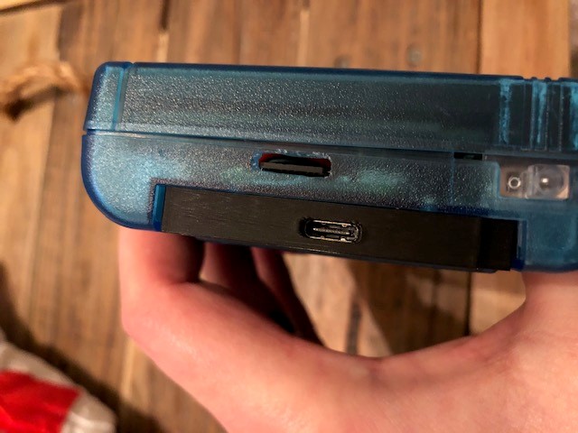

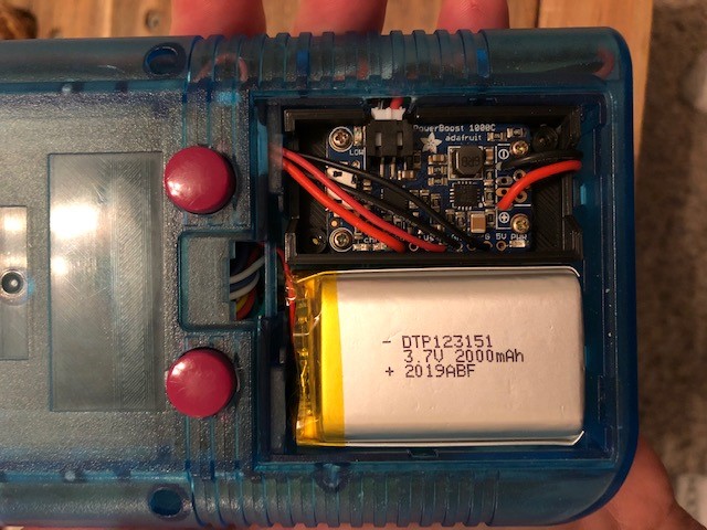

I apologize this took so long, but here are some pictures of my GBZ build
Notice the USB-C port
Might be hard to tell how I ran the wires, but I'll do my best to explain

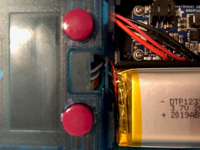

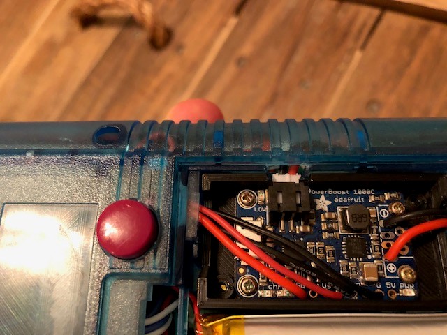

The red and black wires at the bottom of the powerboost I actually ran underneath the 3D compartment box I designed to hold the powerboost and are wired to the Pi Zero
The wires for the battery are run out through that center hole in the top of the battery compartment and then come back into the side where the powerboost JST connector is. (had to cut a hole in the battery compartment to do this)

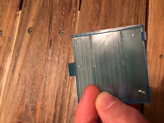

The battery compartment cover you have to trim those two lines on the inside on the side that has the battery in it, to get the cover to sit perfectly flush. If you don't, the battery cover will close, but it will be a little bowed
