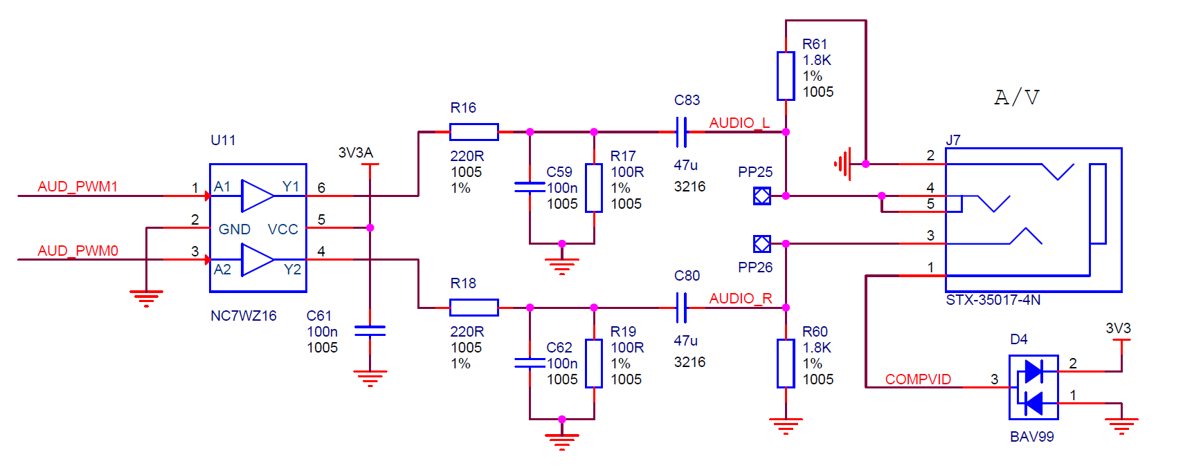

Digital logic creates noise on the power supply rail. Take a look at the schematic of the Raspberry Pi 3 and you will see that they have a separate 3.3 V power supply for audio (3V3A) from their PMIC (MxL7704). They use an NC7WZ16 buffer to decouple the audio signal:
Pi audio.png (66.14 KiB) Viewed 2371 times
You can use an NC7WZ16 together with a low noise voltage regulator for this.
Additionally, use star grounding for your analog signals.
