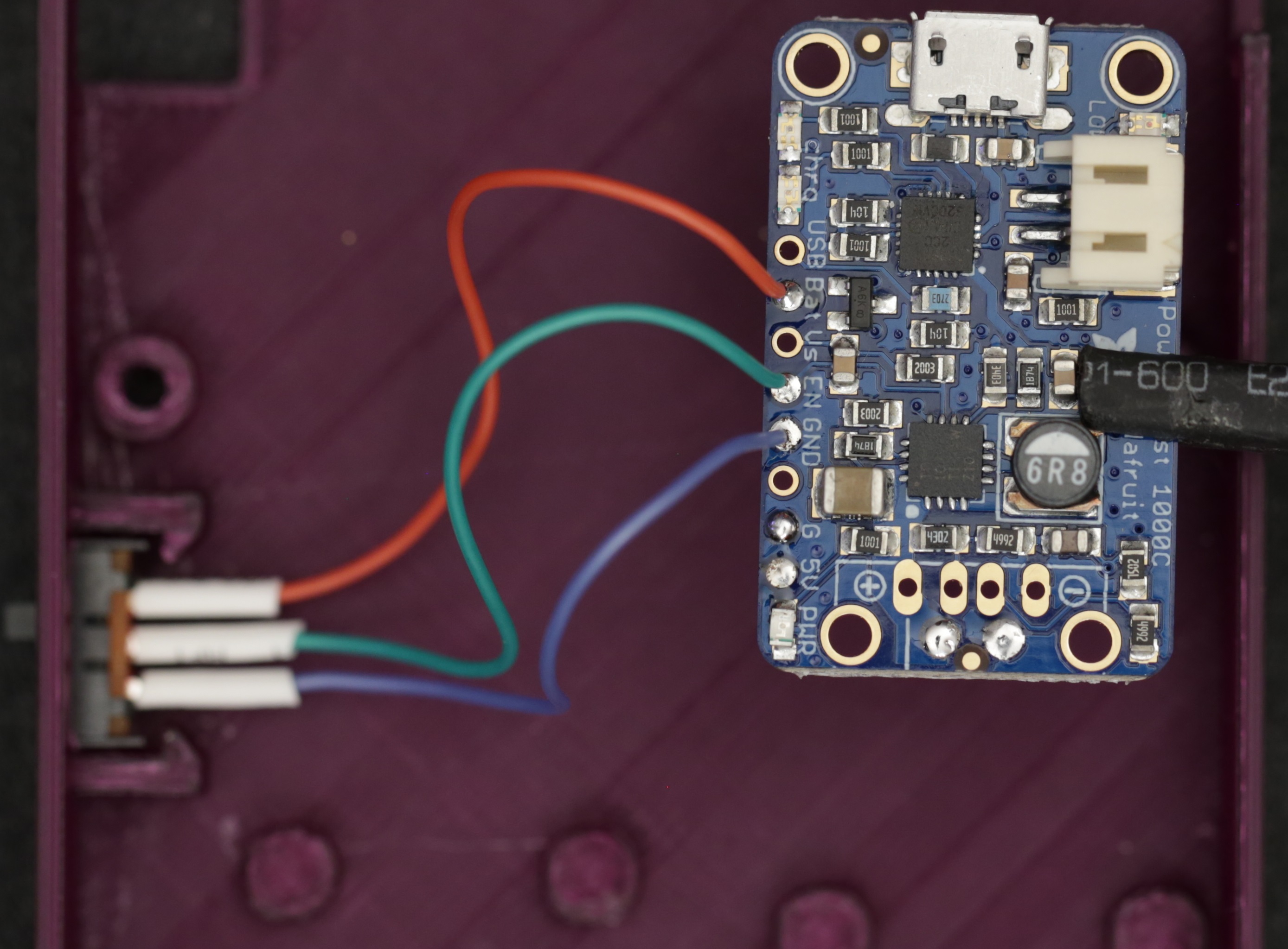

I took a look at a few other people projects and noticed that some people have 3 wires and some have 2 wires connected to switch. But is there a difference between the 2?
As seen here:
(2 wires)
and here:
(3 wires)

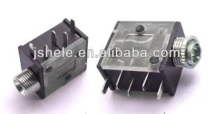

Also in terms of the audio jack I have is a mono phono jack with the 3 pins on it.
like this:
I was wondering 2 things which pins connect to the amp board and which to the speakers?

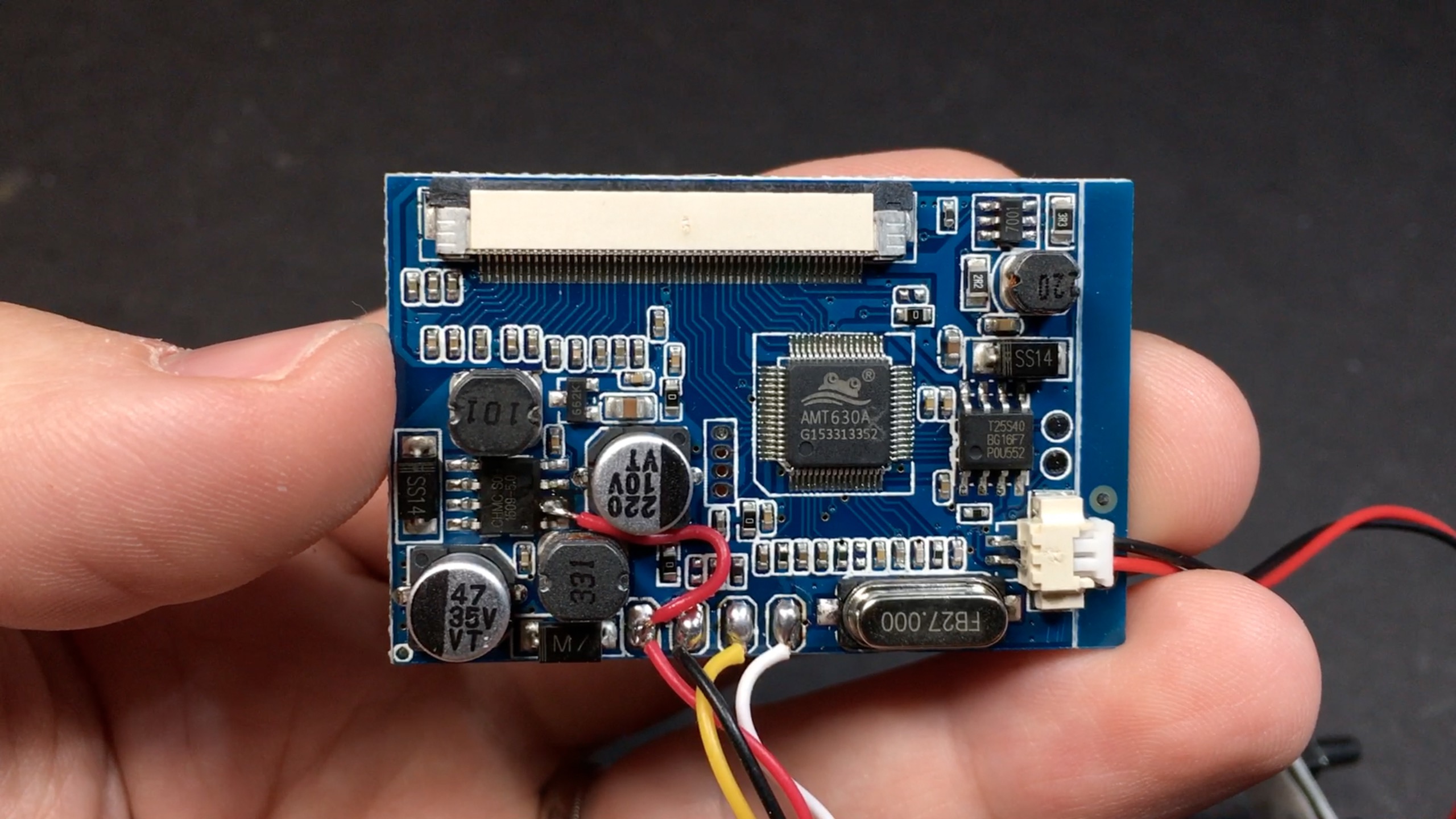

For my screen it is the one recommended off of the Game Boy Zero Custom Parts Guide Part 1 tutorials. The BW backup camera screen found here https://www.amazon.com/BW-3-5-Inch-Moni ... B0045IIZKU

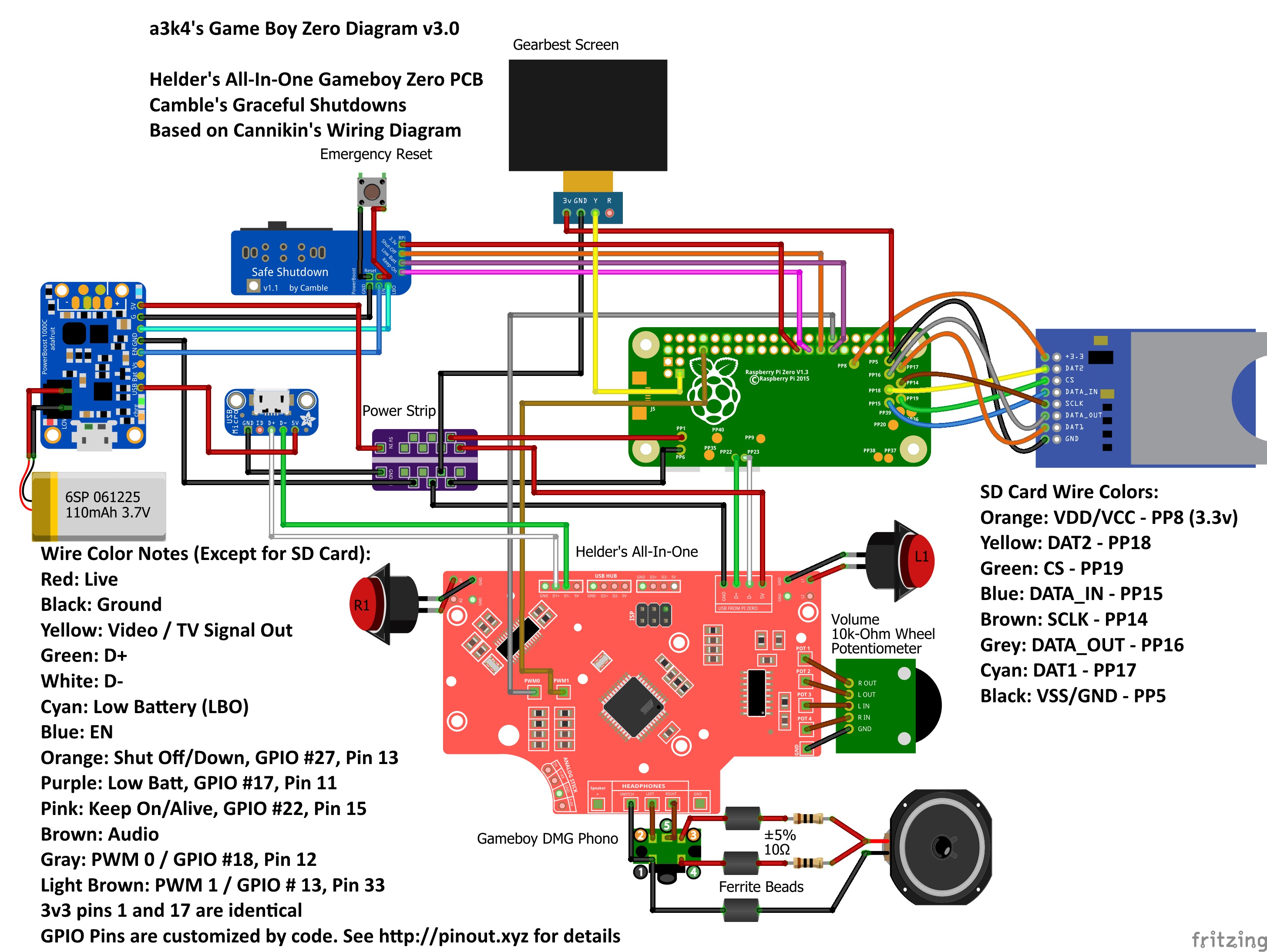

I have this diagram:
My question is: with the wiring to the power and pi zero should I follow this route in the above pic or how should the screen get wired?
I did the thing this red wire is doing in the following pic but just wondering where the red black yellow and white wires go from here?

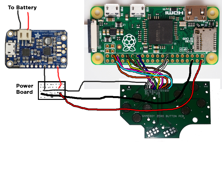

Post by lewsidius » Mon Aug 07, 2017 5:48 pm
Lol I keep replying to myself. But I'm still working on it, trying to get this thing going.

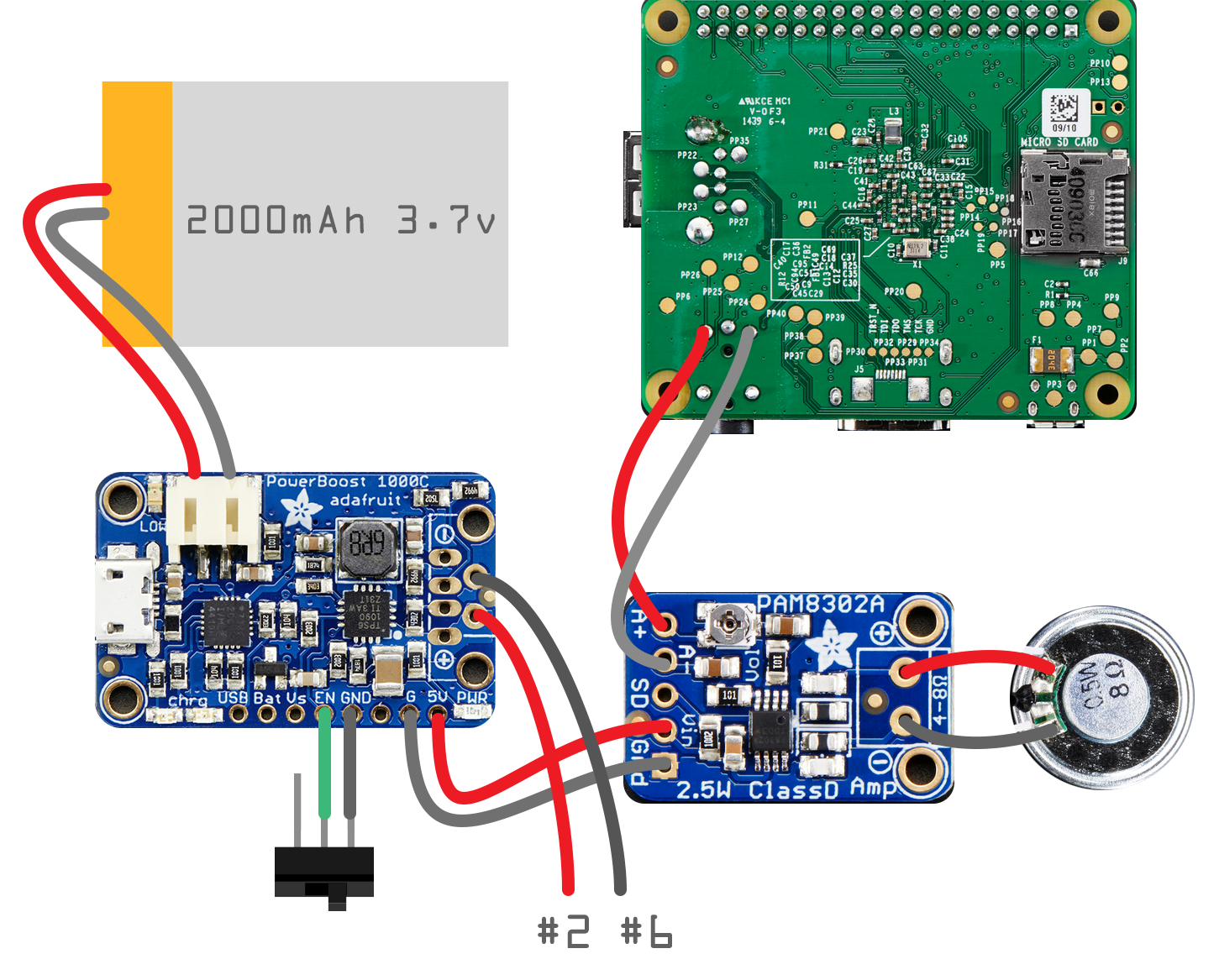

This is what I have wired so far :-)
I am going to try a fresh install of the retropie because I am not getting the buttons to sink.
I also for some reason am not getting the battery to hold a charge. I need it plugged in to work properly?
I just did a diagram of what I have wired so far. I also have the L and R buttons wired too.
Any Ideas?
power pi and button board.jpg (296.27 KiB) Viewed 5583 times
Re: Almost done! Just gotta to wire. any ideas?
Post by rodocop » Tue Aug 08, 2017 1:24 pm
This guide shows how to wire the screens too:
Red will go to 5V power, black will go to the GND rail, and yellow or white (not both) will go to the TV pin on the pi zero.
viewtopic.php?f=22&t=958
As for your powerboost wiring, I would wire the red and black coming from your power strip to the pp1 (5v) and pp6 (GND), below the power usb port.
Not sure why the battery isn't charging. When you plug the battery in does the orange charge light come on?
As for the switch, if you are using the powerboost 1000C I think you just need two wires. the EN and GND.

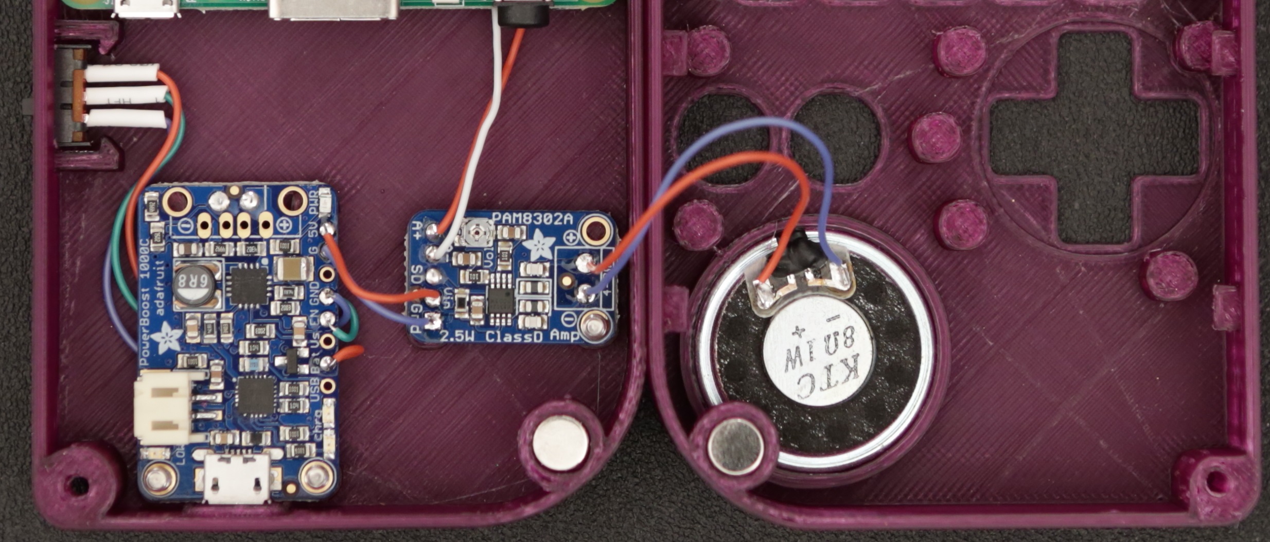

Audio stuff, here is the diagram I have made for my setup:
Purple is audio out from the pi's GPIO pin, I have wrapped it with a ground wire to help reduce static. The yellow wire is the output pin of the volume wheen, which goes to the amp, I have also wrapped it with a ground wire. You are using a different headphone jack but it should work pretty close, have a look at this link:
viewtopic.php?f=22&t=701
Your jack is the last on the list, and it shows what each pin does. I think your headphone would need to have '-' from the amp to '1' on the jack which then goes to the speaker, and the '+' would go to '2' or '5', and then from there you would wire '3' or '4' to the speaker...
you dont need ferrite beads or resistors, but they may help. You can also use a low pass filter to help reduce static.
audio diagramShow
Now, to wire your external USB, green and white (D+ and D-) will go to the pi zero pp22 and pp23, and the power and ground will go to your power strip.
Micro USB will be wired to the USB and GND on the power boost, you do not need to wire the D+ and D-
I tried to answer as best I could!
