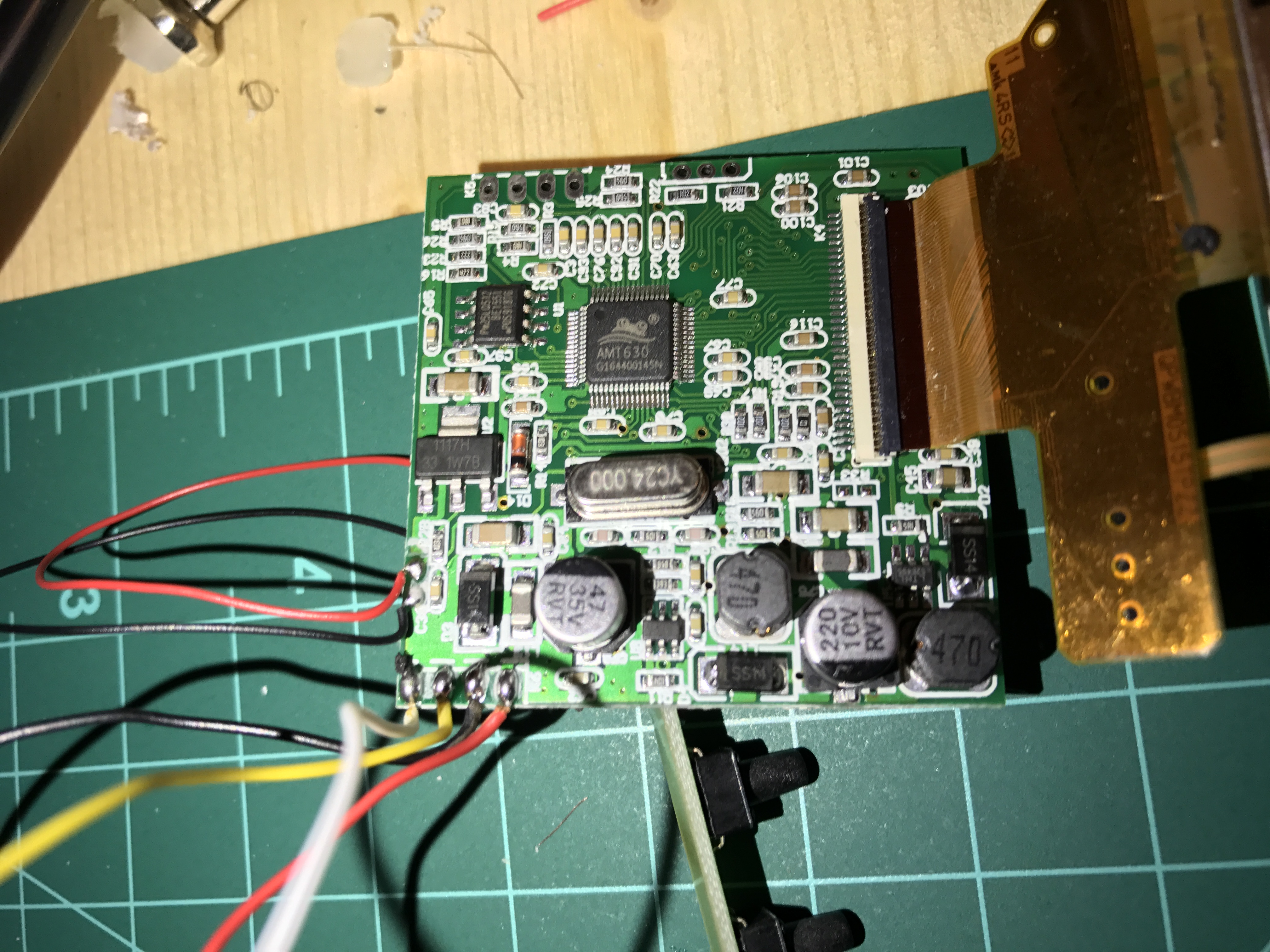

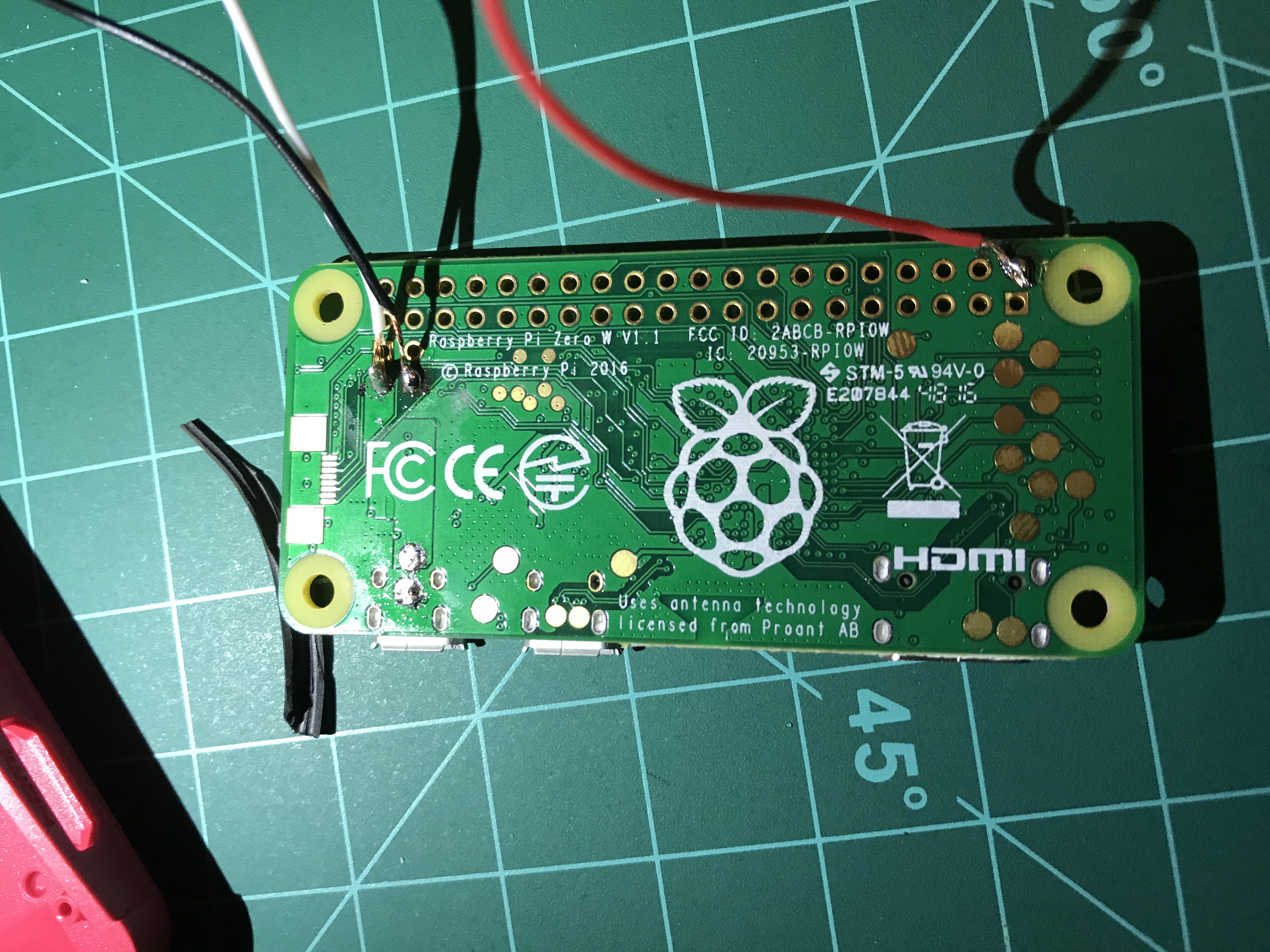

Hey everyone,
I had ordered this BW screen from amazon. Unfortunately the control board did not match up with wermy's guide and the raspberry Pi I am using for this build is a pi zero wireless which doesn't have the "PP" labels on it. I tried to connect the pi to the monitor regardless and had little success. I had found this post and had tried to solder the wires that way and.. there was a single flash of light on the monitor and nothing! The Pi is fine (I kept hooking it up to my tv every once in awhile just incase I had messed it up soldering). I have done a bit of searching all day today and had found on the BW wiki page that my monitor was variant 8 However, the 5v mod didn't give much detail. I had tried to match the photo and no luck not even a flicker. If anyone could point me in the right direction on building with the RPi zero wireless or just this BW screen issue alone that would be amazing.
thanks again,
Maury

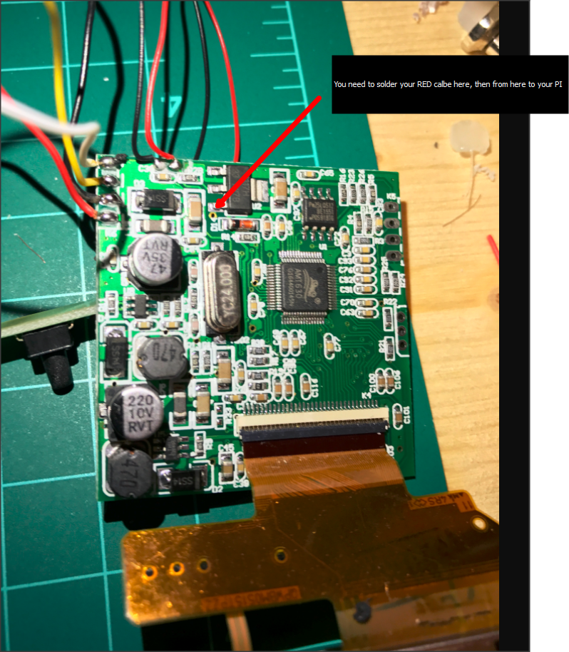

Post by Maury » Tue Sep 19, 2017 9:53 am
Snap 2017-09-19 at 10.52.39.png (1012.84 KiB) Viewed 3529 times

Re: display help (BW screen issues)
Post by Maury » Tue Sep 19, 2017 9:54 am
let me know how it goes.
