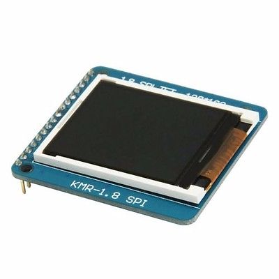

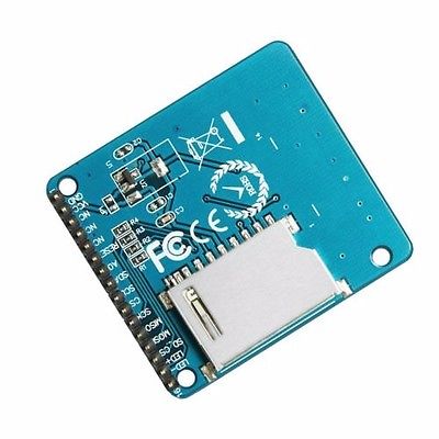

Hello im a little bit of a noob when it comes to working in the raspberry pi script and wiring up spi lcds
Ive been searching all over the internet on how to get this particular lcd to work with retropie and have not found .. only other 1.8 lcd screens
https://m.ebay.com/itm/201013797202?_tr ... mwBanner=1
If anyone can point me to a form i might not know about or help me out it would be awesome

moosepr
Posts: 524
Has thanked: 69 times
Been thanked: 241 times
Re: 1.8" inch ST7735R SPI 128*160 TFT LCD Display help
Post by moosepr » Fri Sep 22, 2017 8:35 am
If you use my guide as a starting point, but you will need to make some adjustments for the fact it is a different screen.
first off the pin names might be a bit different (but generally similar) try these
VCC - 3.3v
GND - gnd
CS - gpio 8 (pin 24)
RESET - gpio 25 (pin 22)
AO - gpio 24 (pin 18)
SDA - gpio 10 (pin 19)
SCK - gpio 11 (pin 23)
LED - 3.3v (can be the same as pin 1)
you will also need to change the fbtft.cfg compared to the one in my guide
have a look here https://hackaday.io/project/21553/instructions
