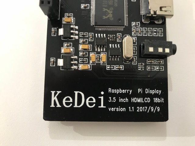

heres a comparison of two boards (different dates)
Version 1.1 2017/2/1
Version 1.1 2017/9/9
there are some noticeable differences between the boards....
(spot the differences)
i lack the technical know how to know if these are improvements in components for better/worst performance,
or complete changes to the board (scraping certain features)
i agree, they should have change the version numbers (that manufacturing in china for you :( )
