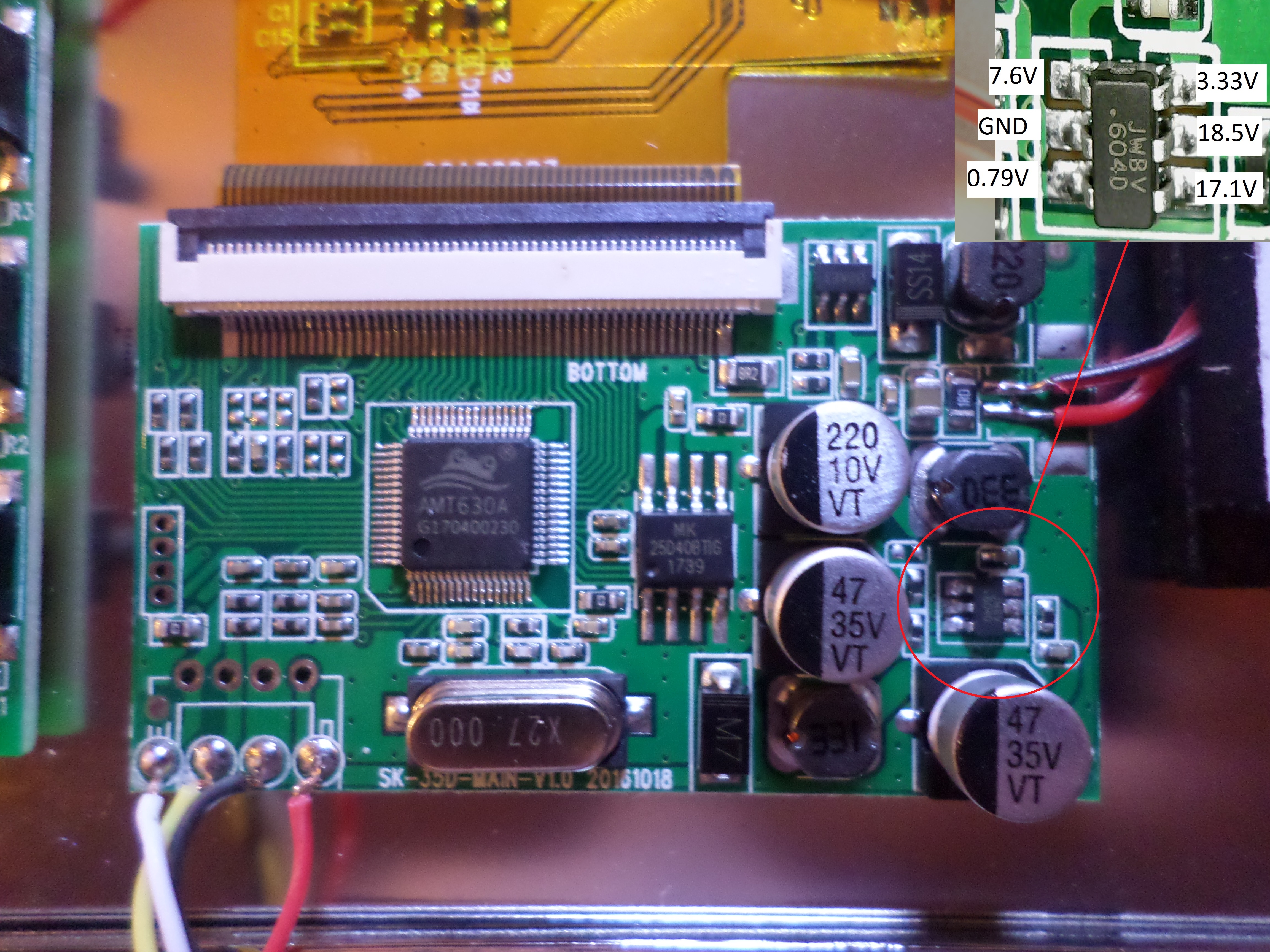

My board looks like the "Variant 10" in the wiki, but the voltage regulator is different (the one in the wiki is JWBV795D).
I checked the 6-pinned chip labelled "JWBV604D" on my board looking for the voltage regulator.
I searched online for the datasheets without success. I supplied the board with 19V and in the image I added the voltages that I measured on each pin.
In the wiki, the 5V was soldered to pin 6, but my pin 6 has an output of 3.3V.
Will the conversion work?
Any help is appreciated.
Thank you.

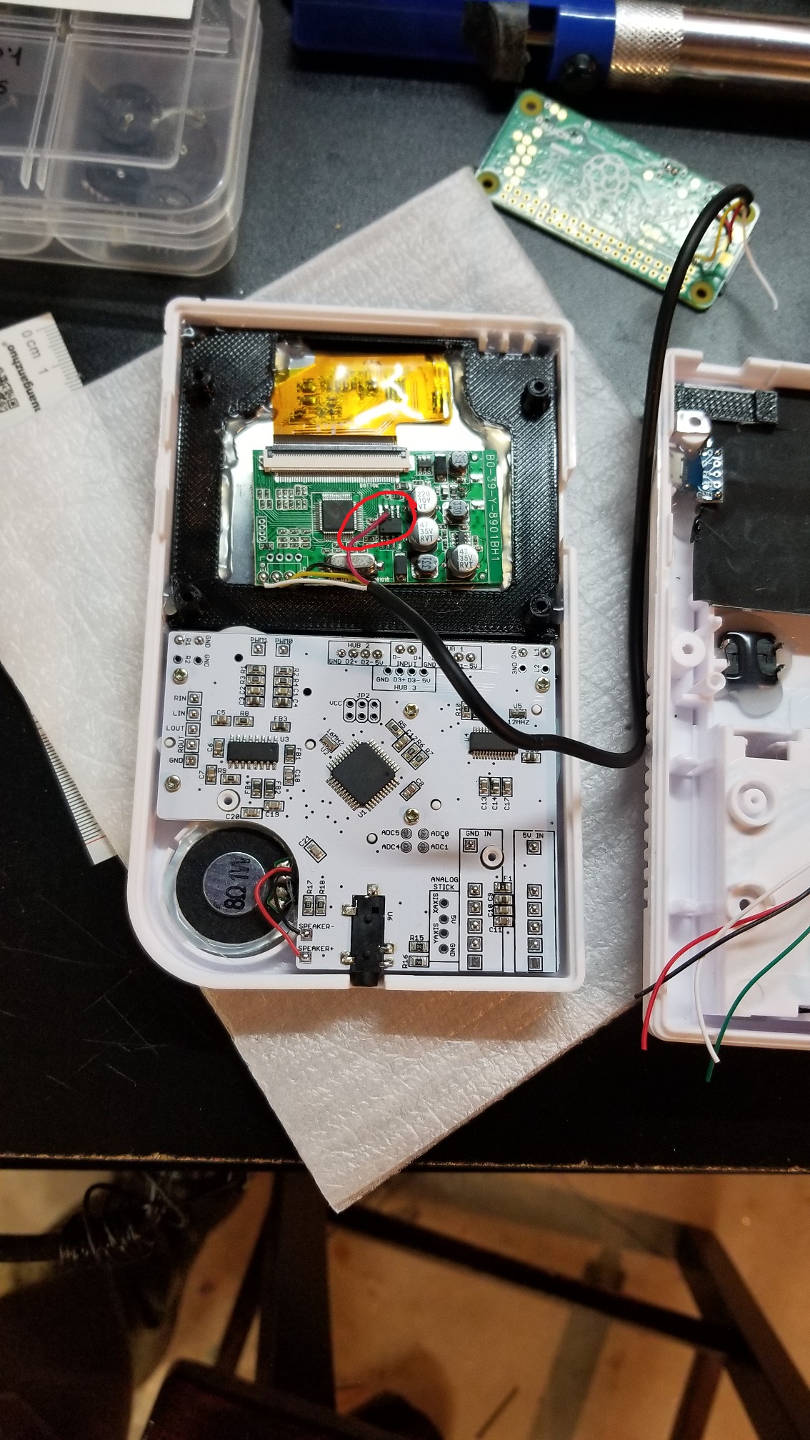

Hello, I believe its the same board I had on one of my builds, here is a pic to show where I connected the VCC, Hope this helps, let me know, good luck.
GBZ BW Screen.jpg (751.87 KiB) Viewed 7615 times
Gus 8-)

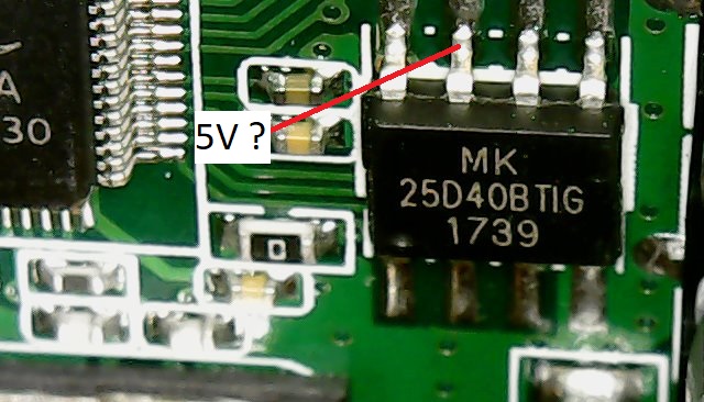

You soldered the 5V VCC wire to pin 7 on the MK25D40BTIG1739 chip?
Thank you for your help.

Post by Thump52 » Tue Mar 06, 2018 2:48 pm
I don't have a good pic of the chip number, but it looks very similar to the one you have, I would test it with a multi meter to make sure, but it does look like the one I had, good luck.

According to this site the chip in the picture (MK25D40BTIG1739) is a data storage chip and not the voltage regulator!
https://www.yoycart.com/Product/562466580239/
Are there any other chips on the board?
Maybe on the other side?
I think the 3.3v solution provided by hex would be beter to try out first, the video chip runs on 3.3v so beter be safe...
