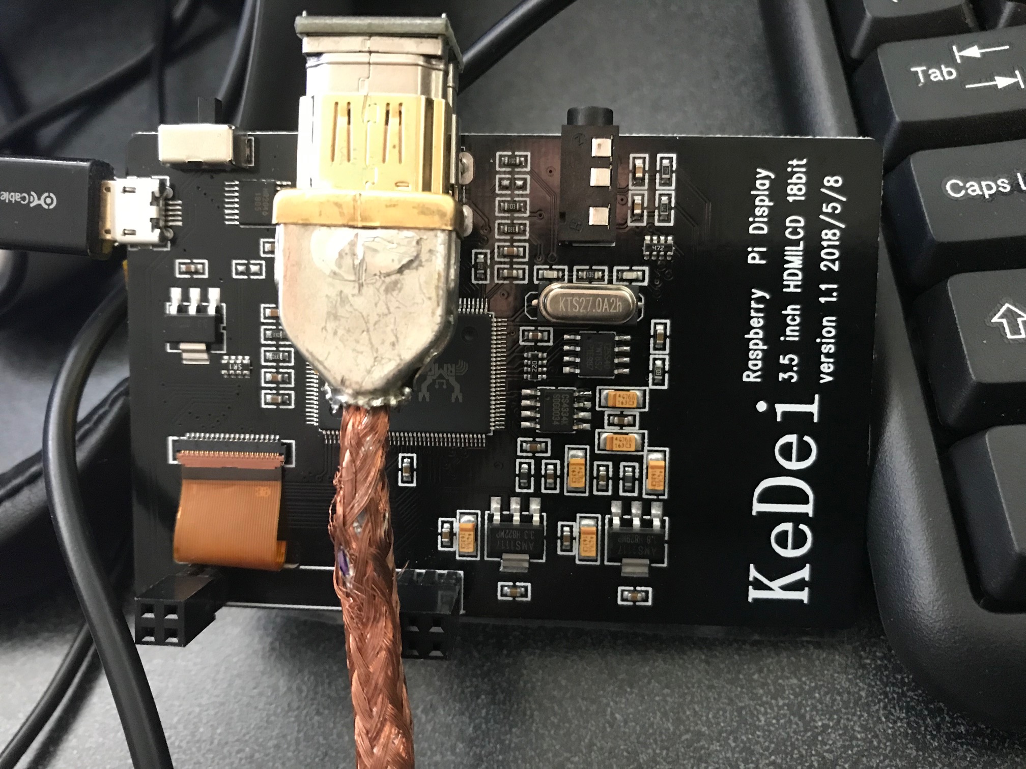

i had the screen and the pi plugged into an external powerbank separately, and just connected via a short hdmi cable, not the gpio
mine is v1.1, 2018/5/8 as well, but i think i've seen people pry the board away to get a more accurate model number on there.
here's a short video - sorry its so shakey :(
IMG_5118.MOV
(3.33 MiB) Downloaded 358 times
and the back:
here's genesis / sonic... but very hard to play with one hand, off-camera, on a keyboard :\
IMG_5122.MOV
(4.34 MiB) Downloaded 385 times
