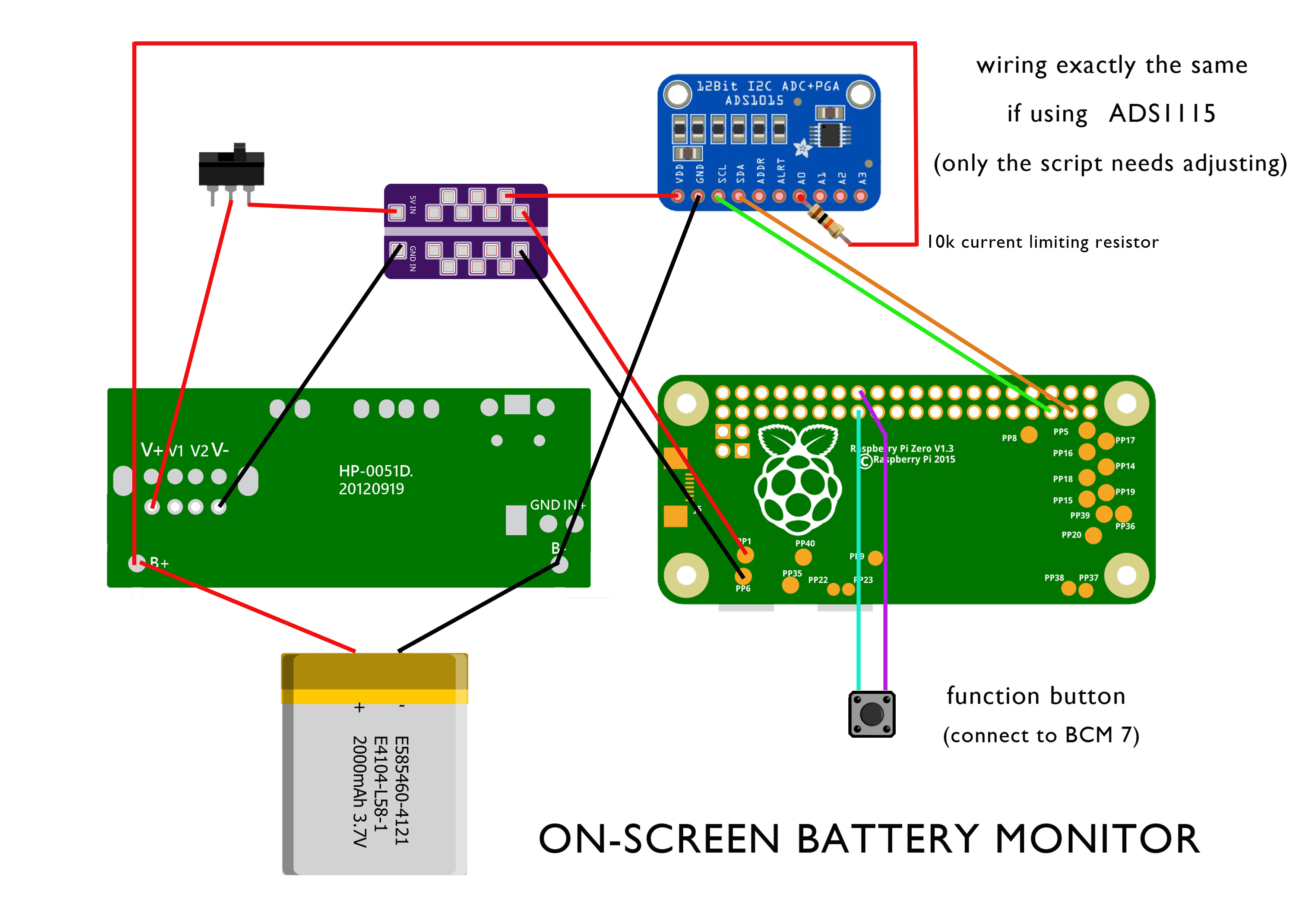

[*] 4000 maH Battery + Banggood PSU + ADS1015 for battery monitoring. Wired according to the following diagram:
The only difference is that I'm using a DPDT switch so I can disconnect Bat+ from the ADS1015 when power is turned off. Here's a picture of my wiring for reference:

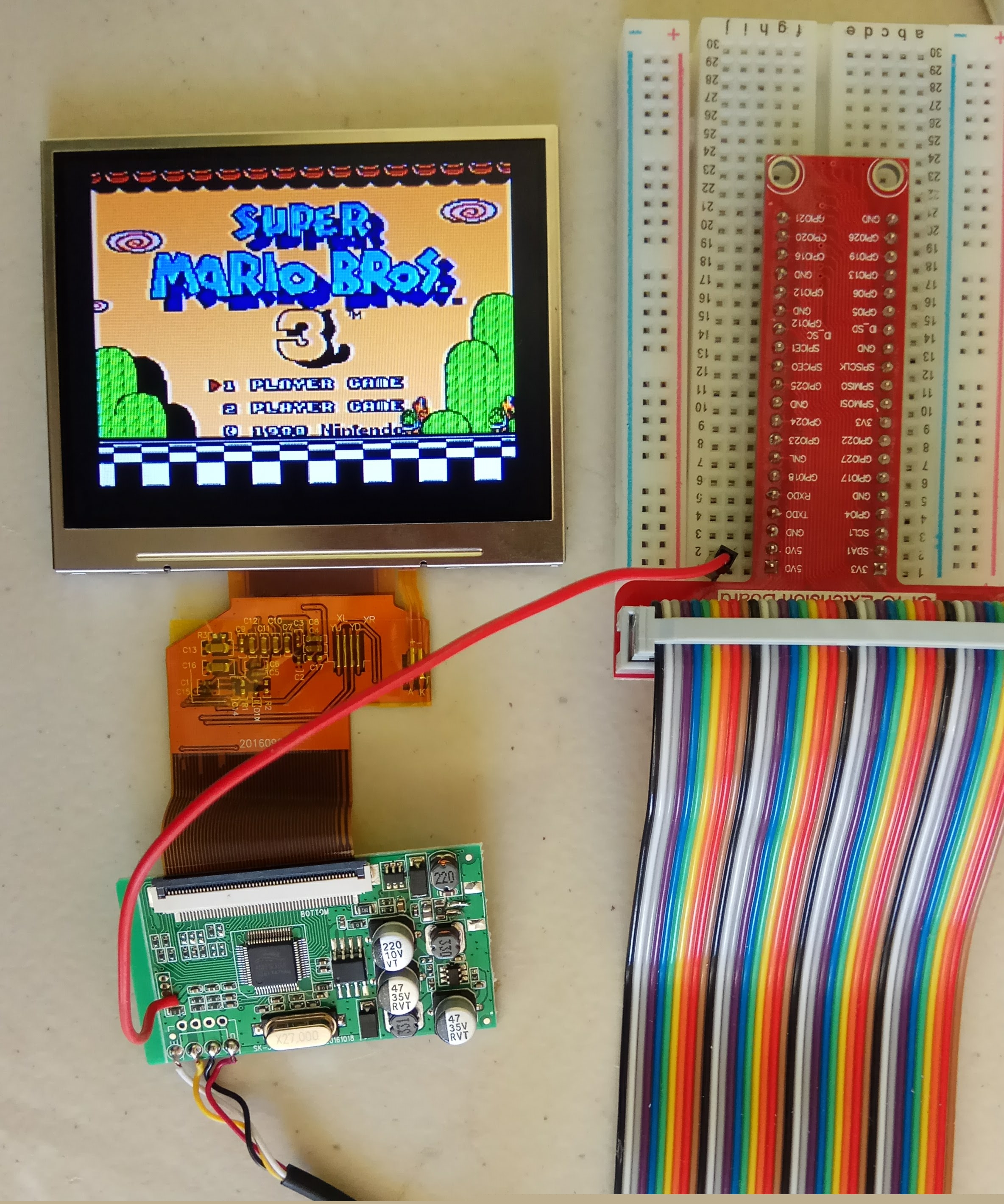

[*] BW Screen Variant 10. No 5v mod. Instead, power is routed to the 5v pin on the side.

hmm, I have had one similar issue on one of my builds, battery would last approx 1-1.5 hours. It did get warm, but no hotter than any other build (typically the pi sits at about 62 degrees (with a heatsink added). I attributed it to the screen board, since it was one I had never used before (Variant 11 that I added to the wiki). I had tested with different batteries and power boosts, which is why I assumed it was the screen itself. I always used the gearbest screen and usually get 3ish hours with those.

Can you access the HDMI port? Maybe disconnect the screen, and boot of the system on the tv. See how long the battery lasts without the composite screen. If you get a significant gain, the screen may be the issues as well.
You could also try the mod listed here, and see if it helps:
https://www.sudomod.com/wiki/index.php/ ... rd_Mod.jpg

I dont have the same screen as ypu but I have the Gearbest one. When I bypassed to 5V regulator on the display’s PCB I found a day and night difference. Before my build would get so hot that it could make all the hot glue soft and thus parts could come loose. And the battery didnt last long. I had also 4000mAh battery.
Now I rarely need to charge it and the gameboy case barely feels lukewarm to the touch.
I would thus recommend you check that your 5V input does not enter the 5V regulator on your screen.

Thanks for the feedback, guys. I performed the mod suggested in the wiki and routed the 5v wire directly to the highlighted pin on the IC. Unfortunately the battery life remains the same, approximately 1 hr.
I checked the battery voltage after the safe shutdown sequence and was getting 3.7v consistently, making me think that the script needs tweaking to read the voltage correctly.
For the purple board pictured above (labeled GY-ADS1115/ADS1015), what modifications if any should be made to the script?

kryan wrote:
Fri Apr 26, 2019 9:49 am
that depends on the battery - I don't think there is a universal answer. there are VOLT0 - VOLT100 variables in the script to set the levels of the indicator:
https://github.com/HoolyHoo/MintyComboS ... Monitor.py
i don't know if anyone else might have suggestions on the best or easiest way to figure out your numbers. my method when it seemed like it was way off was to manually check the voltage periodically with a multimeter from a full charge to where the pi would get a low volt indicator or just shut off.
have you tried disabling the monitor to see if it would last longer than that without the shutdown trigger?
