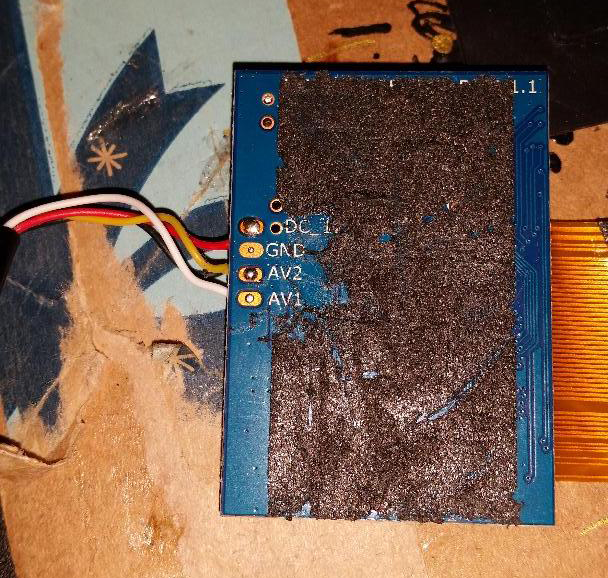

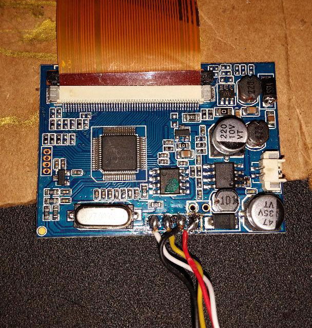

I'm pretty new to the forums and was hoping to handle my problem without having to reach out, but I'm at my wits end! I'm pretty new to the community and decided I wanted to learn soldering and making things. I've made a few projects without an problems, but I've run into snags attempting to build my own Gameboy Zero. Specifically, the screen. I guess I just don't know where the AV1/AV2/Ground/5V goes in regards to my project.

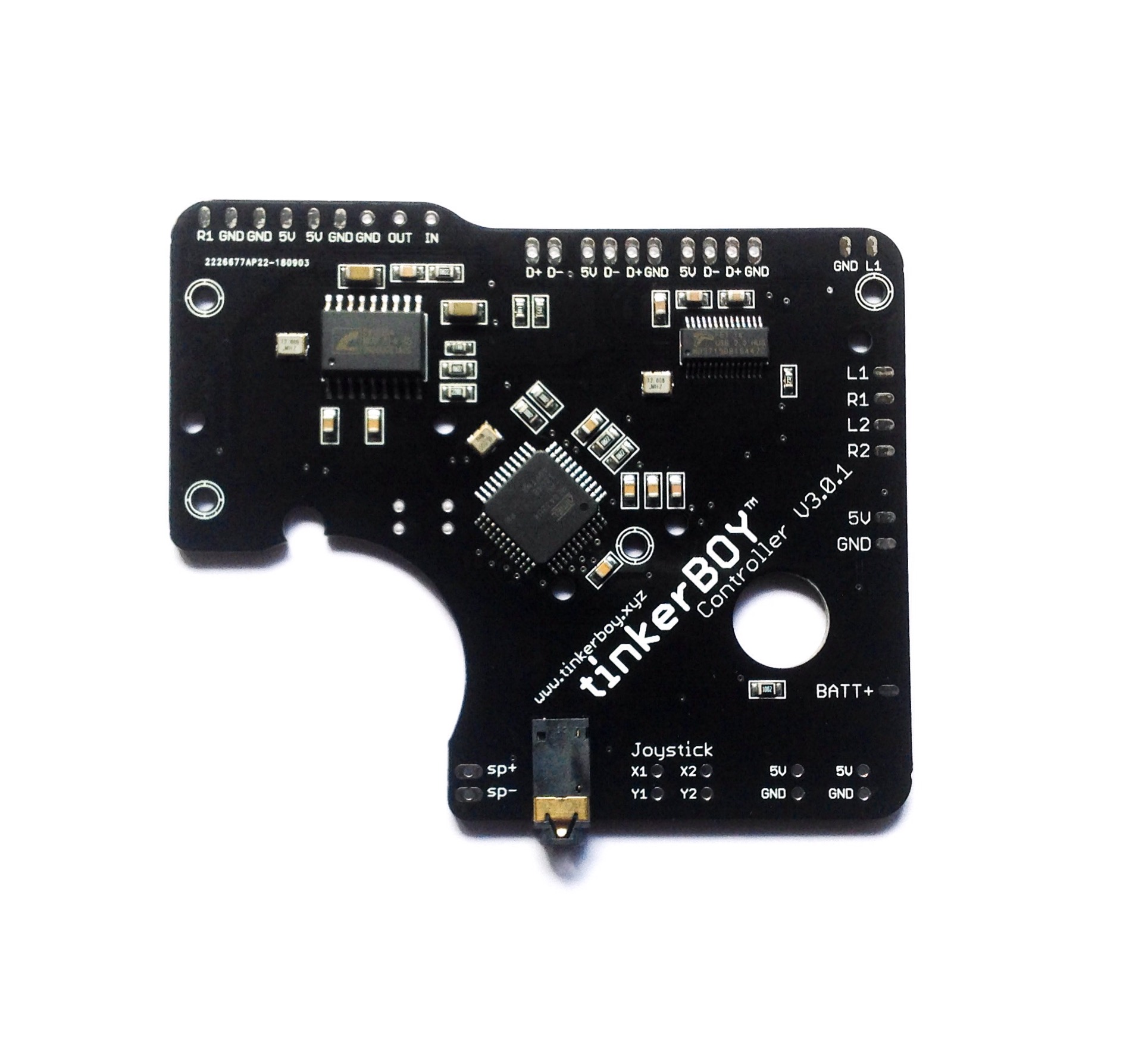

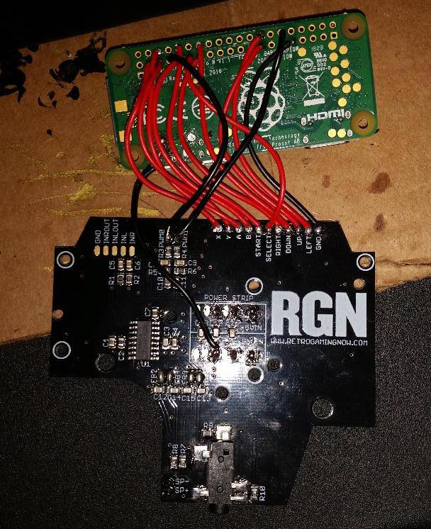

I've plugged both into a mini HDMI up to my monitor and they show working. I have a RetroGamingNow AIO board and the Tinkerboy 3.0.1, respectively.
Tinkerboy:
RGN:

Like, I'll hear the screen make noise, but nothing happens :/

The screen does not need to connect to the aio. Except if you choose to power it with the power strip on board (red wire).
Did you confirm the screens work before? They should just work. I see you have a jumper wire soldering in one screen. Is that a 5v mod? Ensure it is correct. What about the second screen. Check the wiki to see if the screens need 5v mods. The second screen also seems to have a 5v pad on the back. Could connect 5v power there likely.

First screen mod does not look right. Look at my green mark. Wire to that pin.
https://imgur.com/a/ytmZdnF

It seems that the 5v wiring is different on the tinkerboy website
https://www.tinkerboy.xyz/wiring-guide- ... ith-5v-mod
I think its also suggested to power the screen with the powerboost 5v and not with the tinkerboy board!
