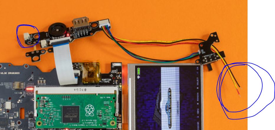

Use the existing wires that came from kites build for the shoulder buttons. Check out this pic from wermy's original guide.
https://sudomod.com/wp-content/uploads/ ... .08.53.jpg
The grey wires are ground, while the blue are the signal wires. I would use the existing wiring that came with kites board though, since it has the connector. If I recall, the wiring provided is yellow, red and black. Yellow to one button, red to the other, and black to one button, which bridges across to the second.

Check the picture, you could use those wires seen there circled in blue. (they are labelled L1 and L2 on the PCB, but that doesn't matter). Alternatively you could use the wiring meant for the connector on the other end, it is labelled as R1 and R2, but again that doesn't matter since you'll just map the controls in emulationstation anyway.
