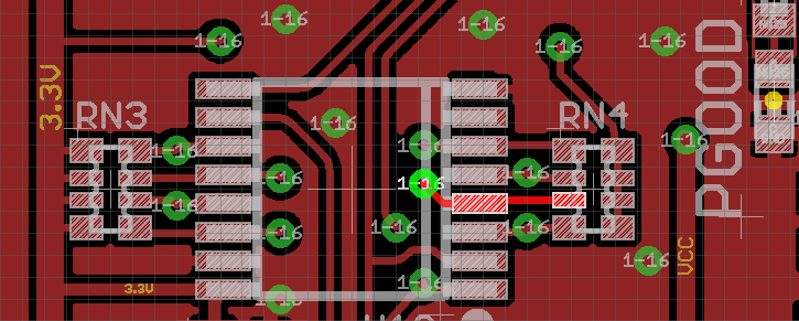

Ok cool, right so the pull up resistor on that pad is not soldered correctly. In the picture below the BRIGHT red parts of the picture are the traces for the DOWN button. You can see that it enter the IC but is also connected to the resistor network "RN4" (this is 4x individual resistors all packaged into that small component). This is the 100k resistor. You can see that on the RIGHT side of RN4, all the legs of it are connected together, this is the 3.3v side. The other side is then linked individually to each button pad.
Could you take a close inspection of this component? If you can take a macro picture of it in focus in bright light I can offer tips on what I can see (i have experience in this area!).
In order to fix, the solder needs to be applied to link it back together. IDEALLY if the 3.3v side is the side missing solder, it will be very easy (just apply a blob of solder to the RIGHT side only, doesn't matter if they all bridge together because they're MEANT to be connected together :) If it's the other side, it's a bit trickier.. you are welcome to give it to go, and/or you can send me an email and we'll sort out a return and I'll repair it for free. You could even have a go at doing it and STILL return it to me if you can't do it, it won't invalidate my offer at all, but might save some time :)
Let me know what you think or can see!
Alternatively if you have a 100k resistor, you can wire it up in any way to that signal (from the button pad area perhaps) to 3.3v
i will look at it. do you think i could get away with fluxing RN4 and reflowing the whole thing with hot air?
