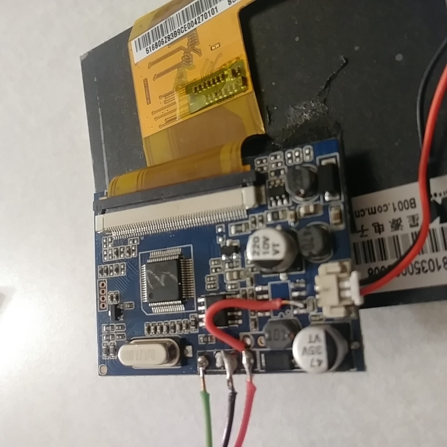

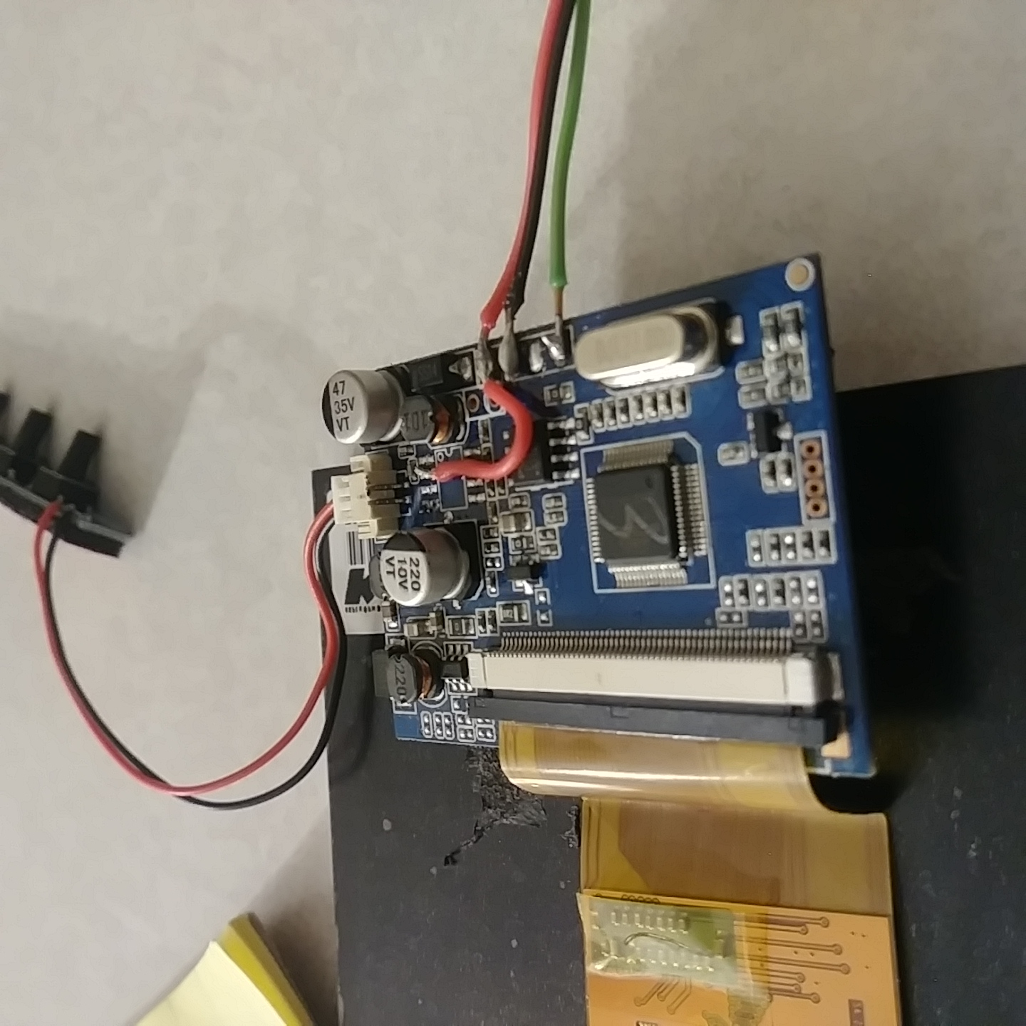

Hello,
I just modified my display and it is totally dead, no back light or image.....
I checked before hand and it was not 5v compatible out of the box.
I modified it according to this tutorial https://youtu.be/_MtN_s4tVK0?t=230
This was the same screen he used in the video.
Here is where i bought it https://www.amazon.com/gp/product/B0045 ... 1688c576f4 (this is the link he provides)
I tested my cable and am receiving power but nothing happens please help.
It is really not in the budget to replace this right :cry: now so if i can get it working it would be much appreciated.

How are you powering the screen then? There’s no power button on the screen (that three button breakout board is for adjusting contrast, brightness, etc). You’d need to run the 5v and ground to a power source too.
First - try running the power just to the pin on the chip you removed. You don’t have to bridge to the original spot. Second, I think you need to move the power up one more pin closer to the 220 cap.
