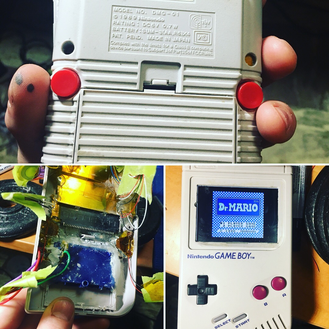

It is definitely possible. With enough time and patients anything is. I put the guts of an ags 101 into a dmg and into a gbc. It requires a lot of desoldering. Basically every component and attaching buttons and the components back into the shell where they work.
