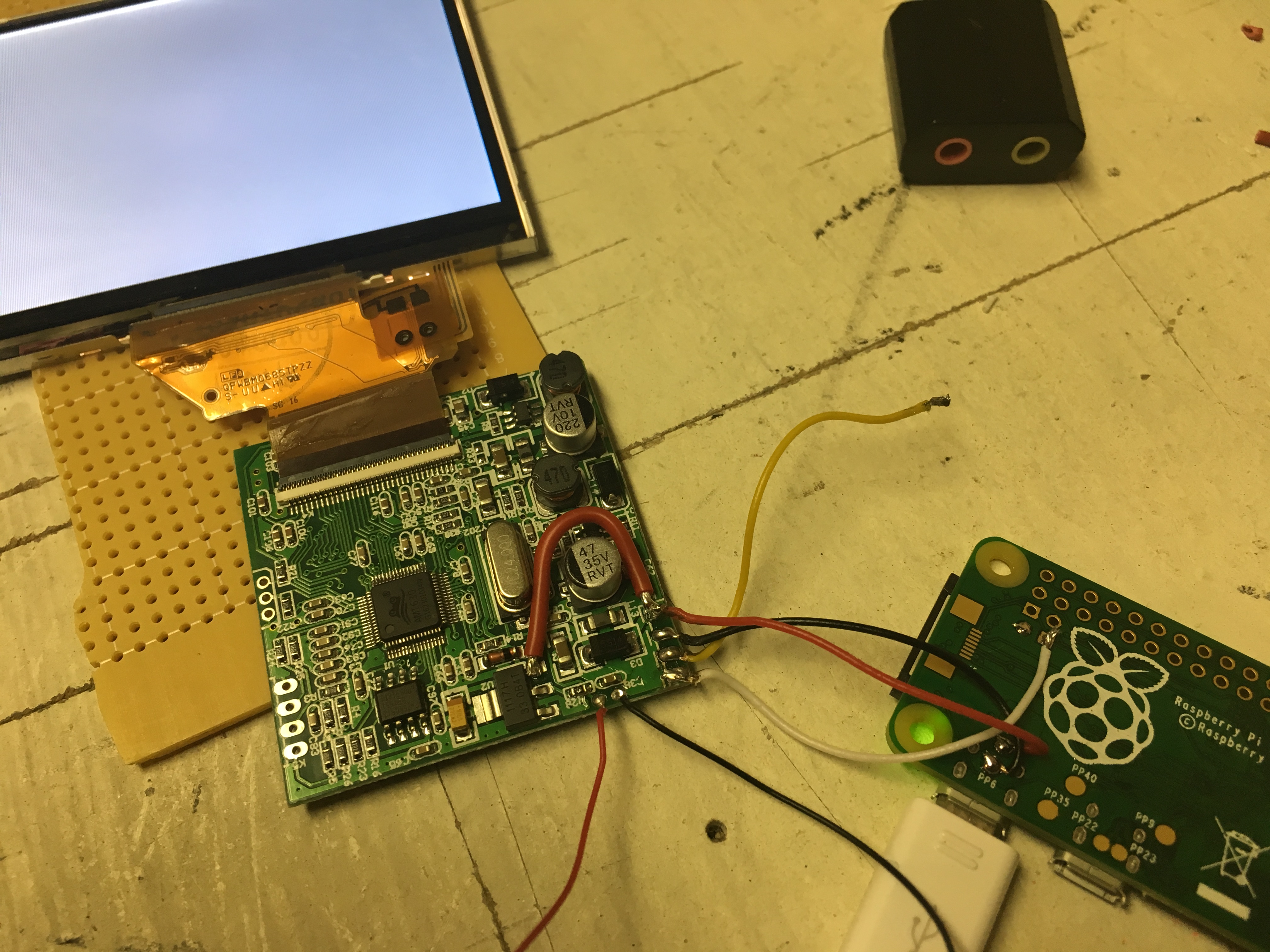

I can't seem to get away from the white screen of death. I have BW screen variant 8 as indicated by the wiki. I have completed the version two 5v modification. In this first pic, I have white only connected.

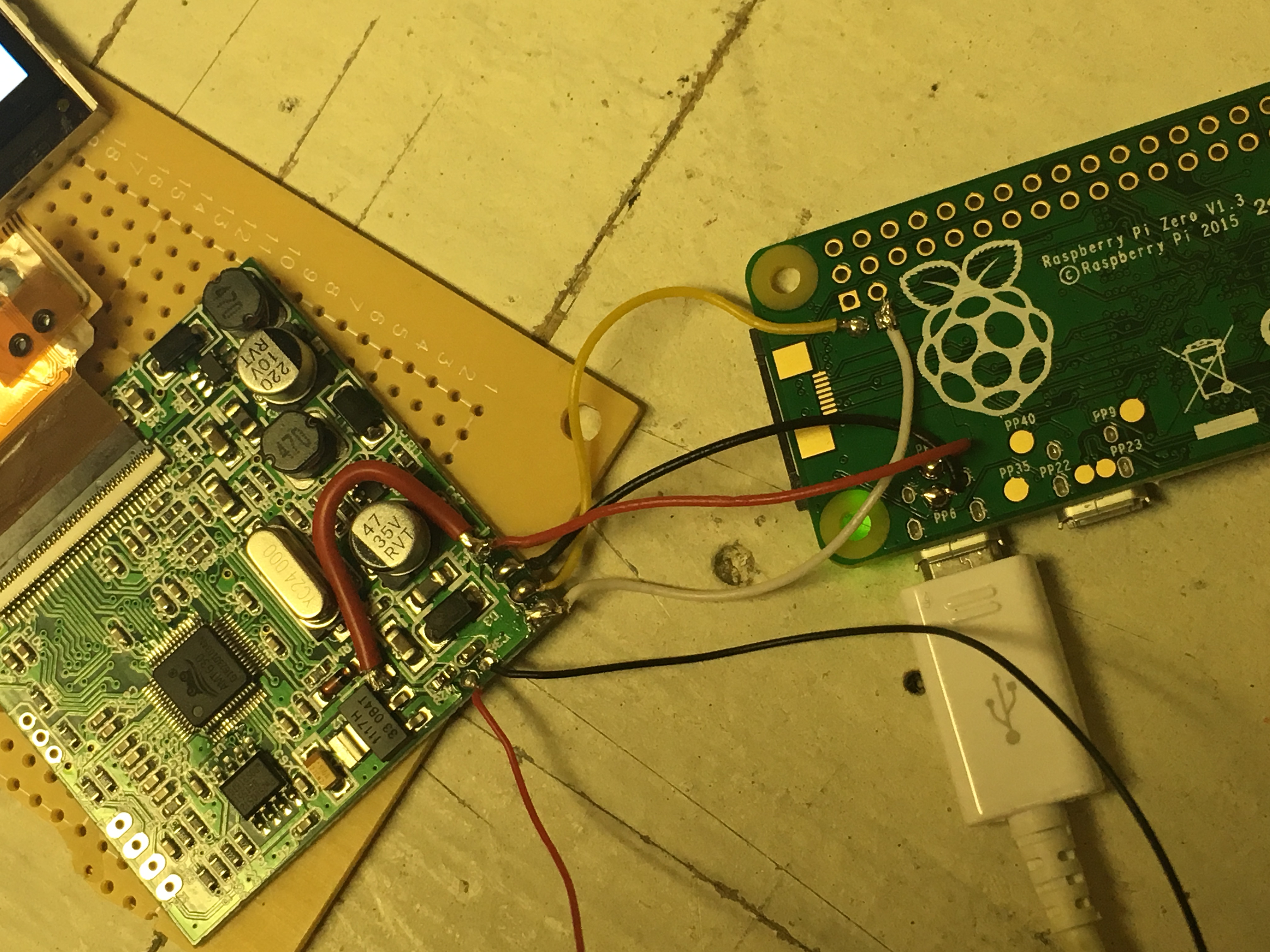

Both the yellow and the white provide the same thing. Just the white screen. As well as when I have both connected. Just the white screen. I know that they are 2 different inputs, but I thought I would try because of the 3rd photo in this post.
This photo I found on screen input request thread. This is why I also tried to have both the white and yellow connected at the same time. Seems to work for him, and in the other photos in his post (it's page 7 or 8) he seems to have the same variant of the BW screen that I do.
This really sucks. Haha. Broke the first screen, this one just came in and can't figure it out. I have tried disconnecting and reconnecting the ribbon cable as well. I can't find any other recommendations. Here's to hoping I don't have to buy a third screen.
Please HELP!!

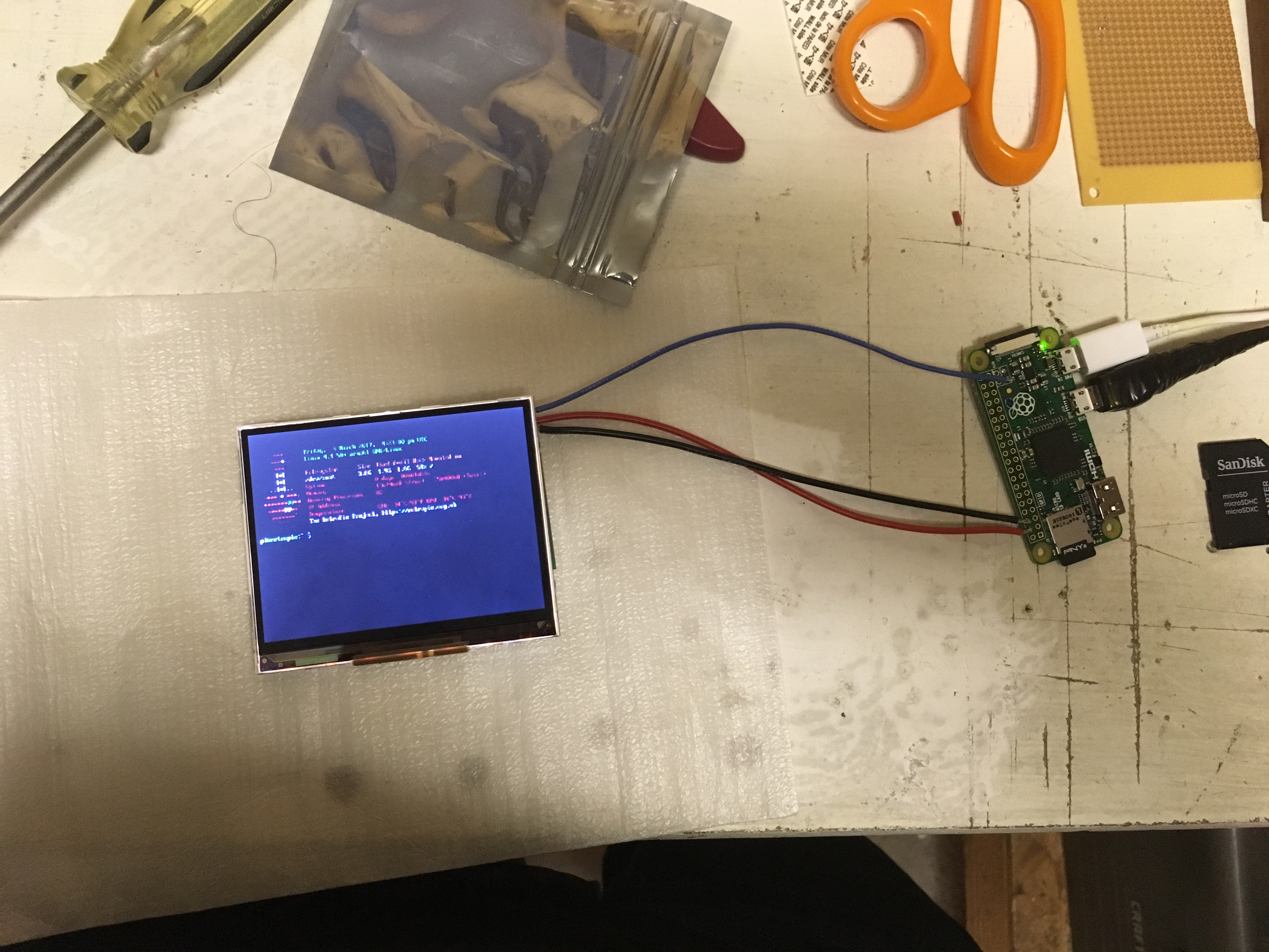

Post by negrete35 » Thu Apr 13, 2017 4:58 pm
Not sure how just folding the controller board back under the screen "fixed" it, but it is working now.

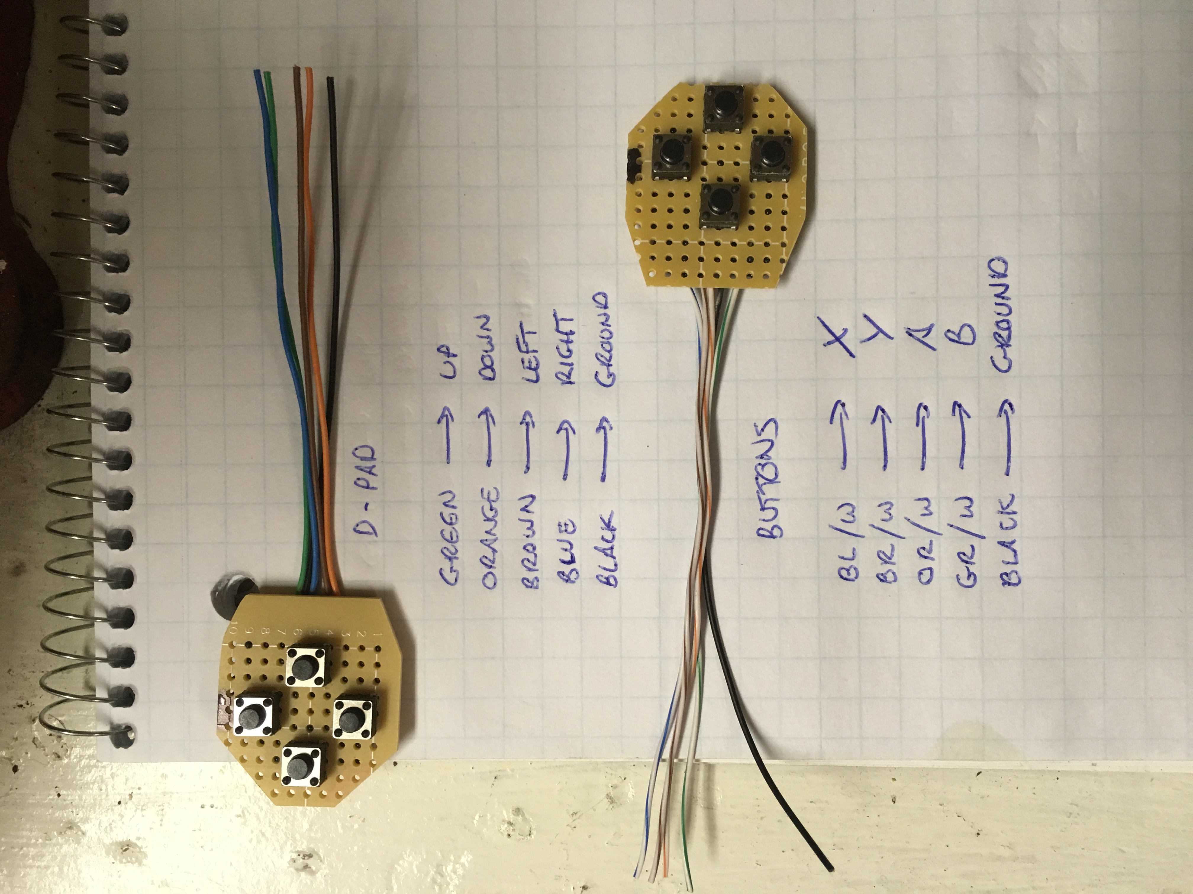

Post by negrete35 » Thu Apr 13, 2017 8:28 pm
Start of some controls!
