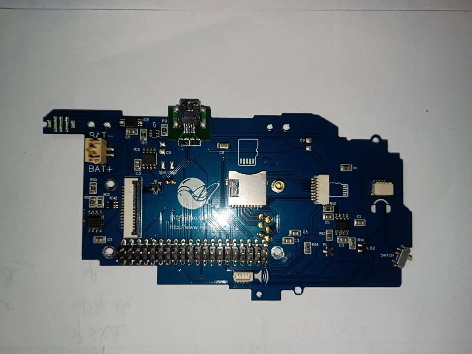

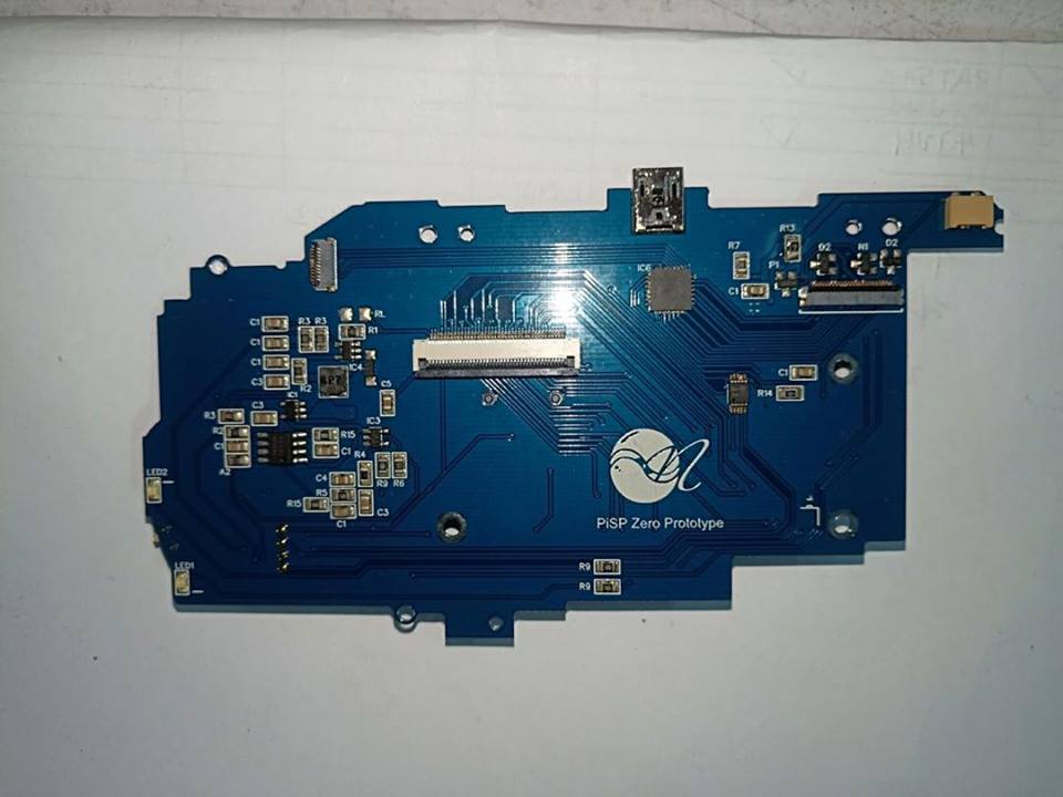

Re: Pi in a PSP
Thank you for accepting my post !
Here are some pictures of the actual PCB.
This is completely identical for the moment and the pcb is Blue in order to avoid confusing in term of support or bugs.. and also not to add overhead to othermod. But everything is compatible in term of image, drivers etc..
I want to put a female smt GPIO header for next iteration in order to avoid solder in the pcb. Rather solder the pin header on the Pi Zero.
My ultimate Goal will be to integrate a Compute Module 3 and use the Screen in 24 Bit DPI mode instead of 565 DPI mode.
I have decided also to name this project PiSP for "PI Systeme Portable" in French, because my aim is not only to play emulation, but also Pico8 or Lua / Love2d games, Python etc, so it can be a good system for developpers who want to share their code to others
Look at what this japanese guy have done in Love2d with the raspberry Pi Zero...
P.S : I May open a new post elsewhere in the forum
Neslou
