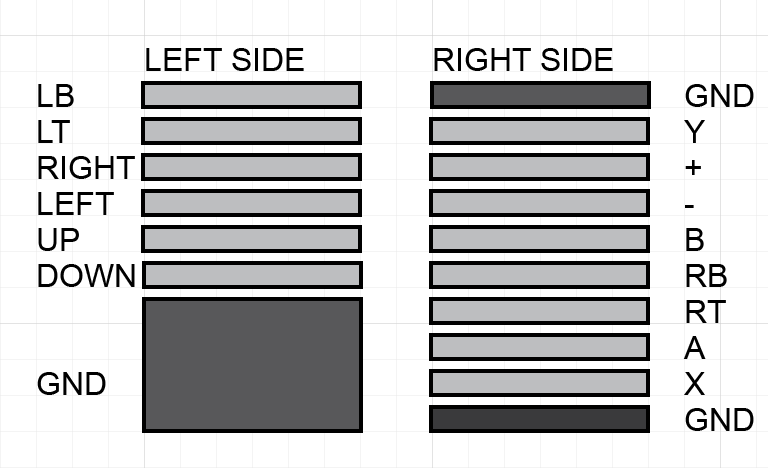

First up, is the pinouts for the controllers:

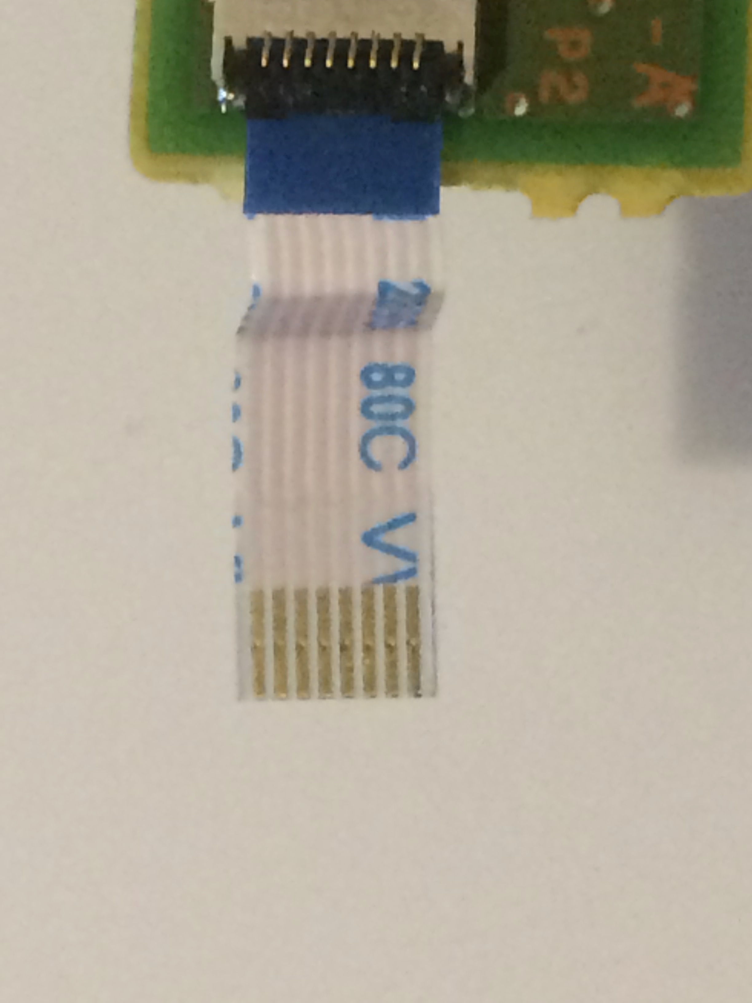

This leaves the little 8 pin guy that we don't know much about:
This 8 pin guy is believed to carry the charging LED signals. I believe it also carries the sync button signal but I would think it would also go through the 18 pin cable. If I knew how to figure out the pinouts I would. I'm betting it requires a multimeter which I don't have. I'll research it and see if I can figure out some of them. I mean, if I want to use them, I'll kind of have to, right? Anyway, I'm hoping that there are other people in the community that wants to get all of the pinouts in a single place.

The pins of the expansion port are the pins on the 8 pin flex ribbon plus three. The reset button falls to that as well. I've tested it and will get that pinout soon. Then, I'll put the two boards together and find where the 8 pin flex cable goes through the 18 pin cable.
