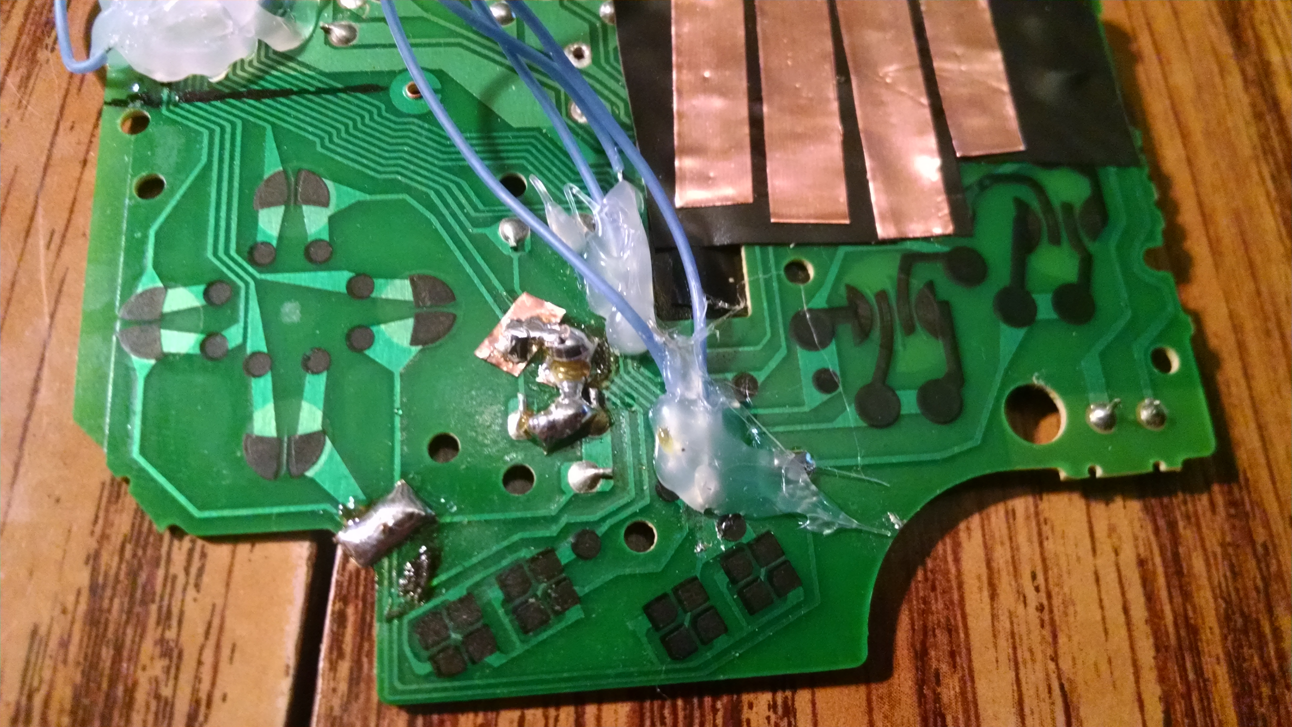

Ill post a Pic tomorrow morning of all the bridges and let me know what you think brotha.ktechelonbreak wrote:Your Teensy solder looks correct, I'd like to see the board solder though. My guess is your ground bridges are not solid enough.

Continuity check the pads to the Teensy is the best way to make sure a connection is established. Just find your solder point and trace it back to the appropriate pad, do it for each one that isn't working. From the looks of it, the bottom left ground might not be bridged although it doesn't explain why the UP button is not working..

Does this picture help?
The connection running to the tracer you connected to your teency should read less than 1.0. The other connection to your board should read greater than 1.0.
If you have a bad connection on your multimeter, then you WILL NOT get two different readings on your board (the up, down, left, right inputs) and you may get the same reading on both contacts, the input going to your teency and the ground connection which means you have a bad connection.
