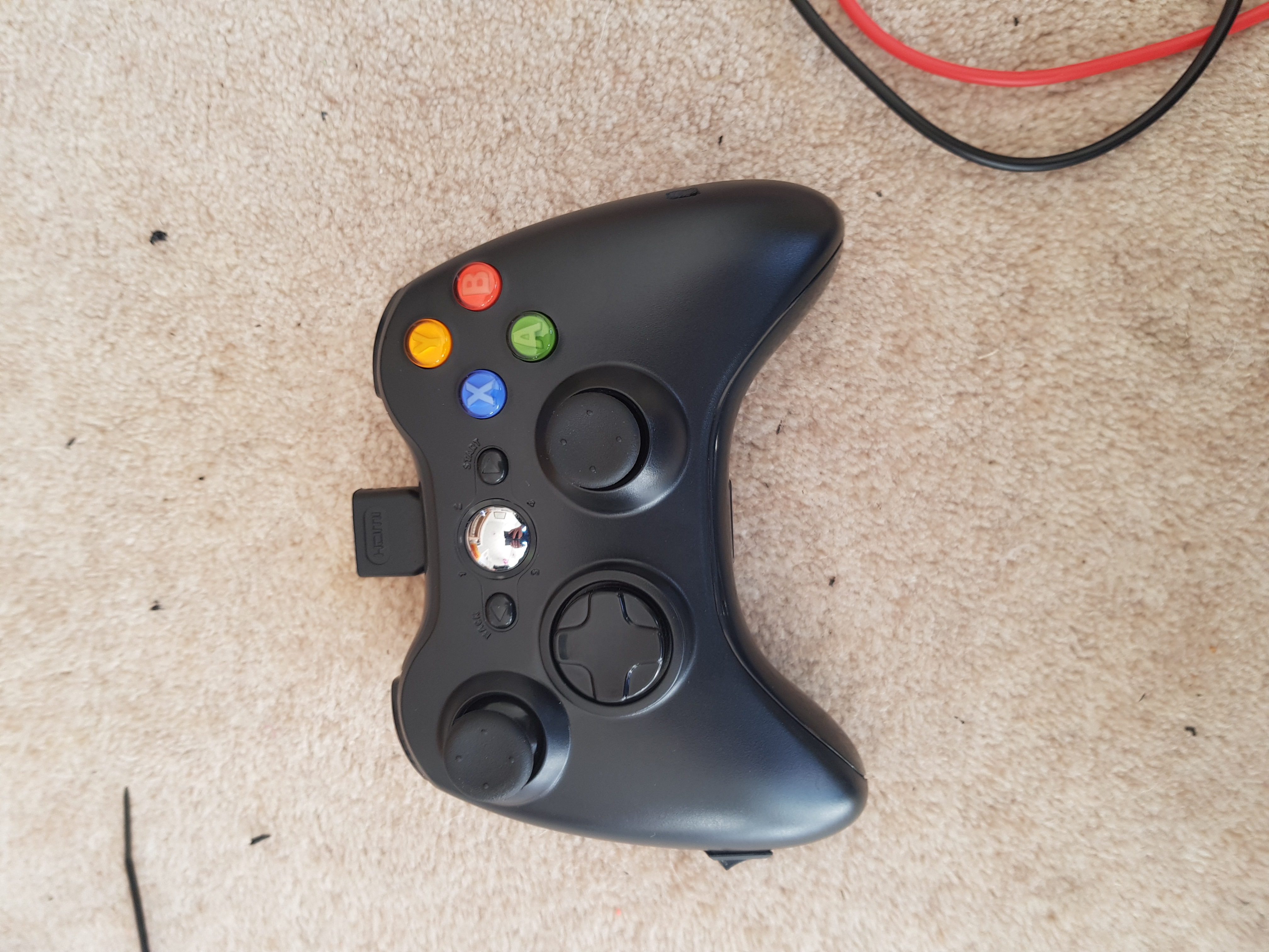

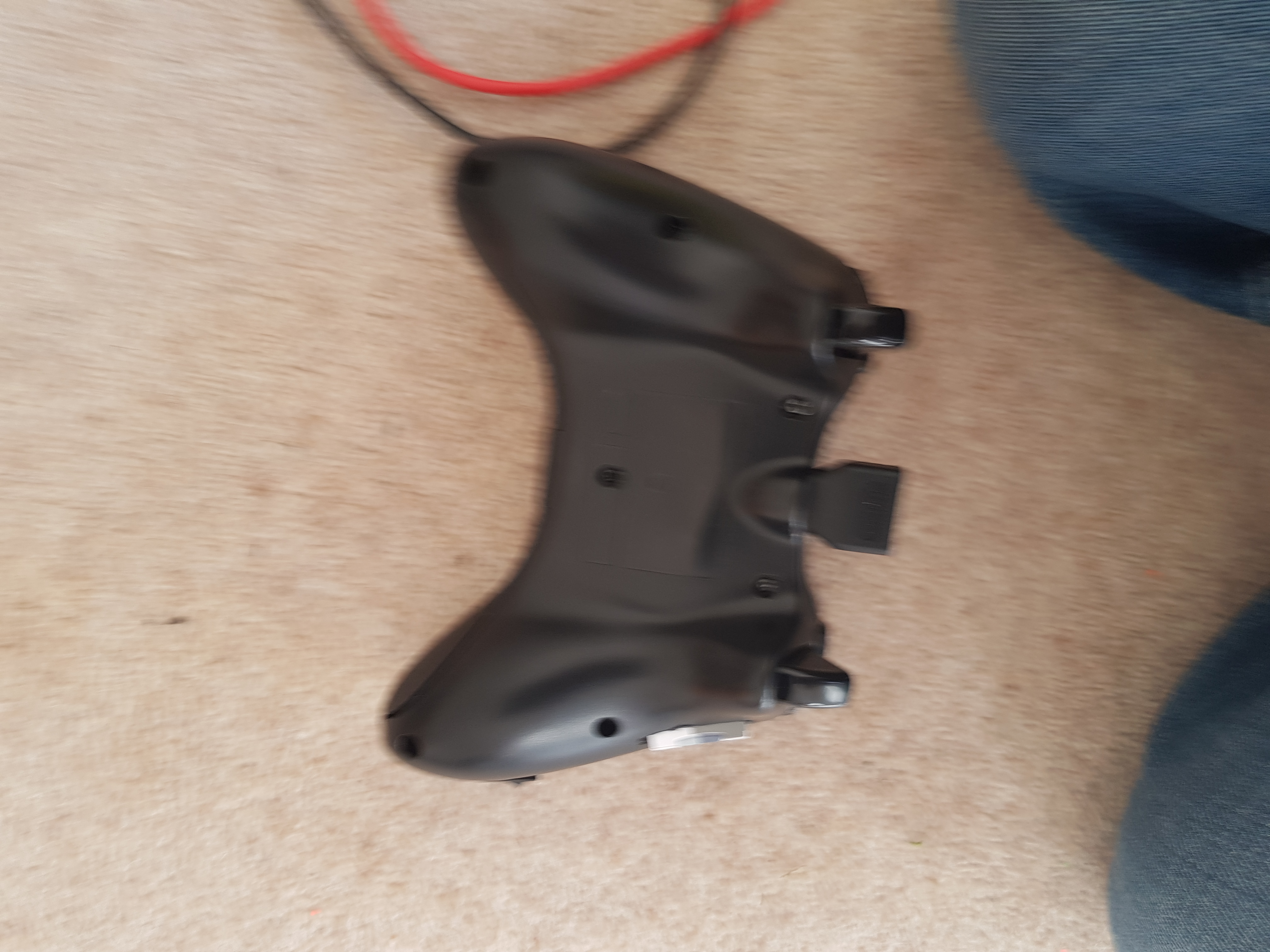

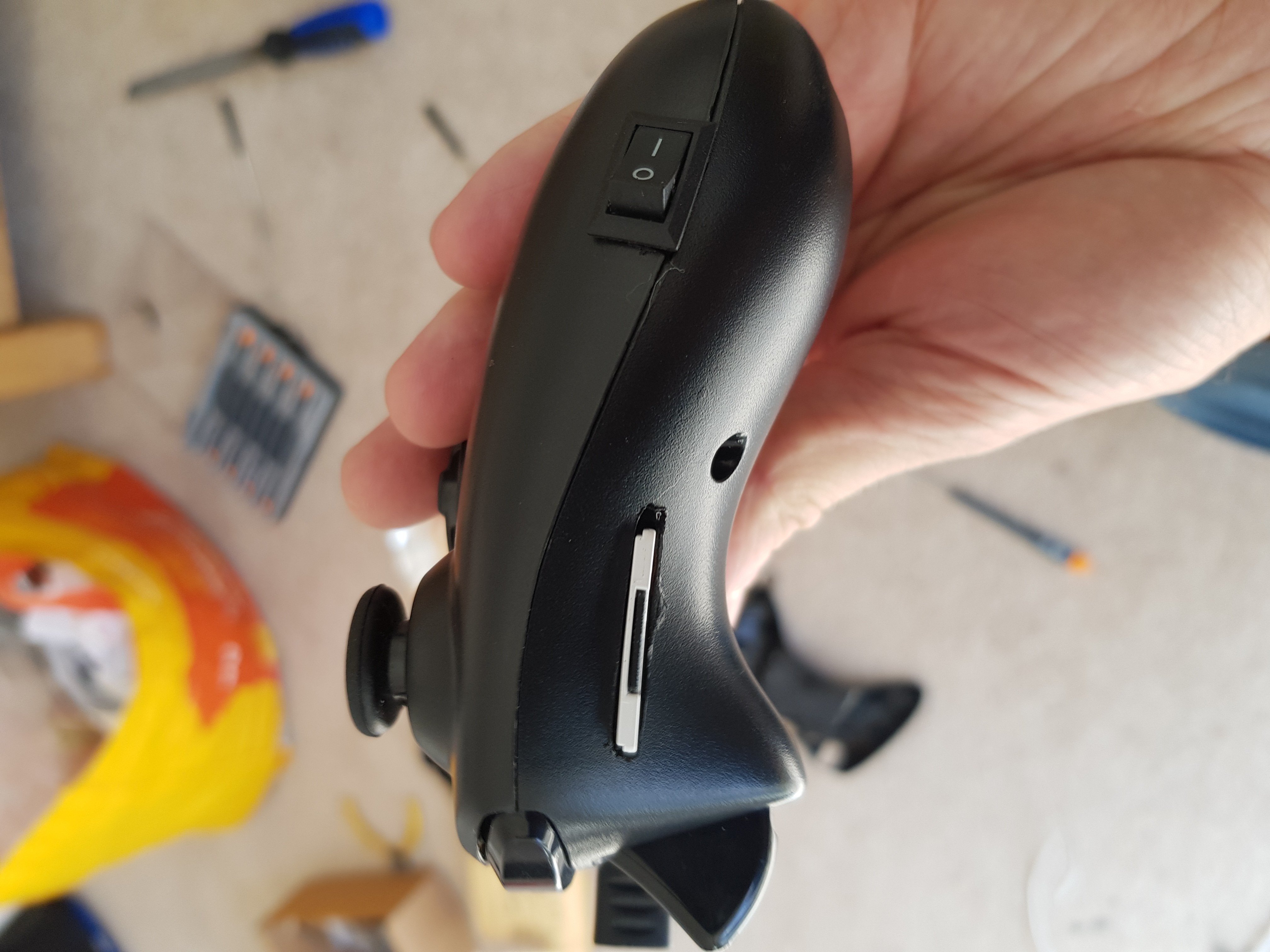

I'm new to the forums so besr with me. I'm also on mobile so sorry if the formatting is bad. So I got a cool idea for a raspberry pi project that I'll probably be posting when I have it all sorted, but I'm stuck with one detail.

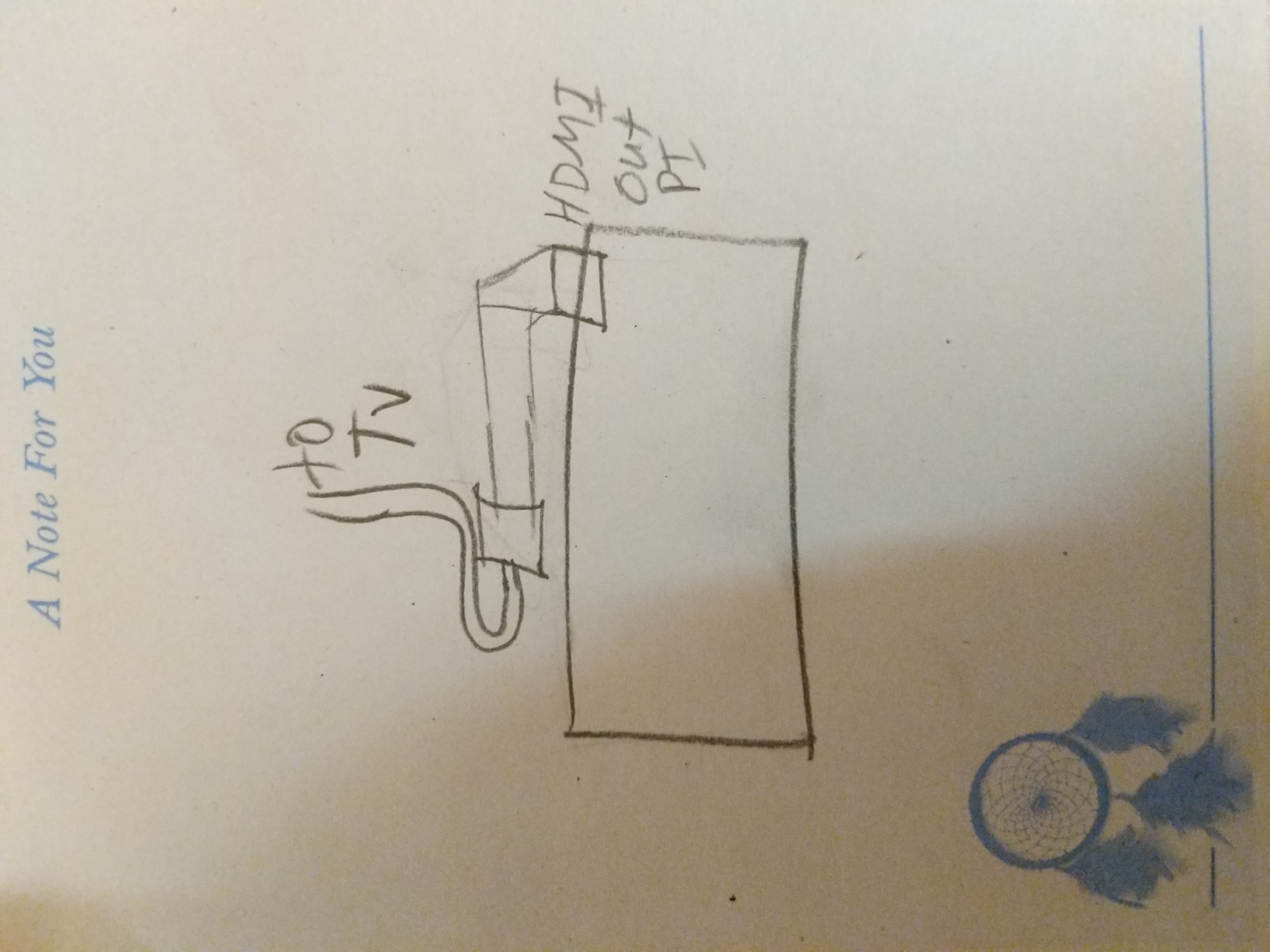

The mini HDMI cable I have for my pi zero sticks out too far, so I can't get it to fit in with the project. I want the HDMI cable sticking out the middle, but obviously there's no headroom to move the pi over. I'm thinking of using a ribbon cable with one of these connectable ends on it Kinda in this configuration To fold it over at a 45 degree angle so the mini HDMI would plug in sideways and I could route the wire around and up the middle. So in essence, I want the cable to plug in internally and stick out the controller like it's a normal wired controller, but be an HDMI cable instead of a usb one. This seems like a pretty horrible idea for a permanent solution, but it's the best I could come up with on the spot, and I would love some ideas if anyone's got one. If I need to explain it better, just let me know. Also sorry for my awful drawing skills. Thanks in advance.

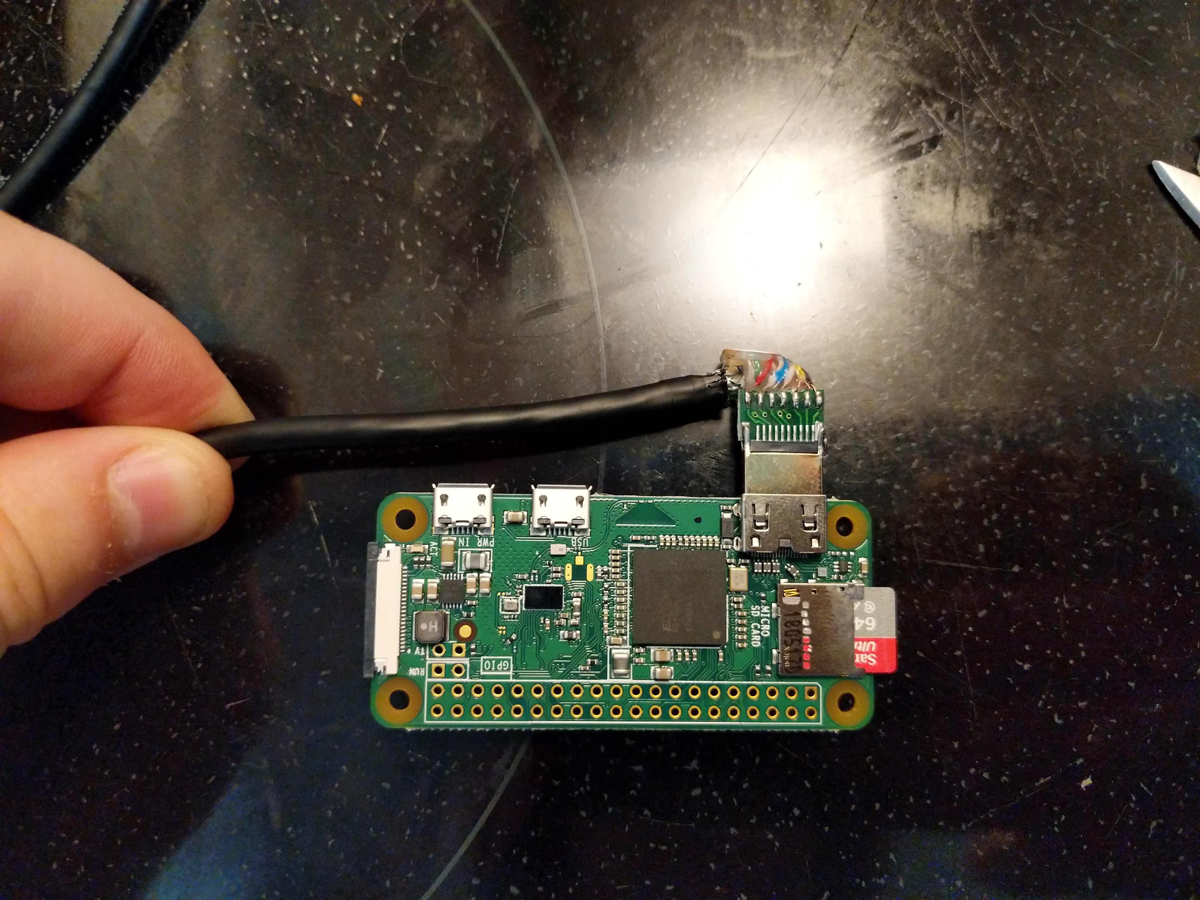

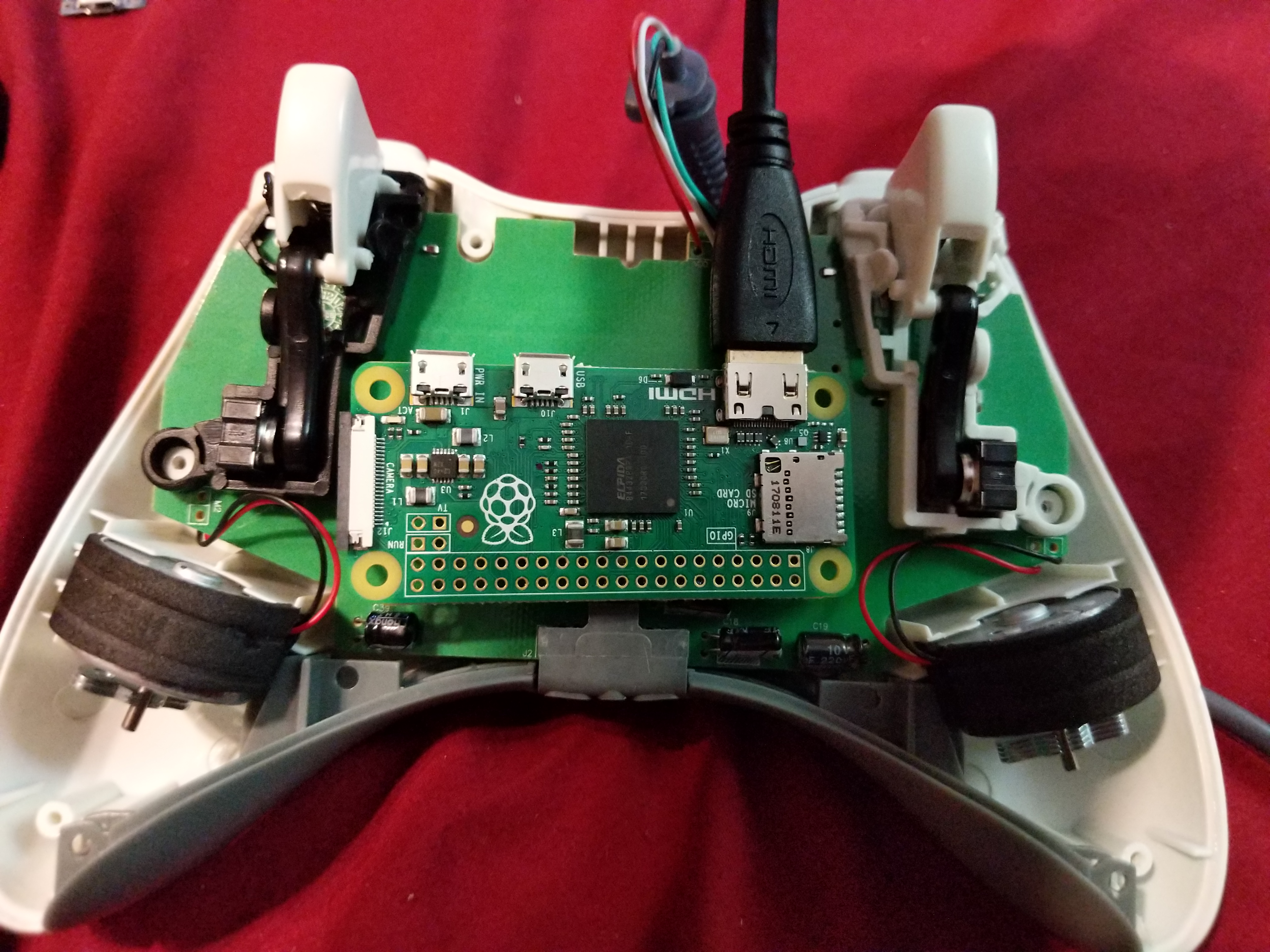

You can also just wire up an hdmi cable. it’s like 13 wires so it’s a bit of a pain, but definitely easier to work into tight spaces.
Check this out: https://www.zeroboy.eu/tutorial-self-ma ... l/?lang=en

Huh... I never would've thought of that. What I'm first gonna try and cutting that big piece of plastic around the connector off and seeing if it'll let me bend it closer to the connector. If not, that's what I'll get to doing. And yes, it's an Xbox 360 controller, generic as can be. I got it off Amazon for $15 just to try and stuff a raspberry pi into because why the hell not. I couldn't find anyone on else on the internet that's done it.infinitLoop wrote: ↑Tue Aug 20, 2019 5:37 amIs that an Xbox controller? Pretty neat

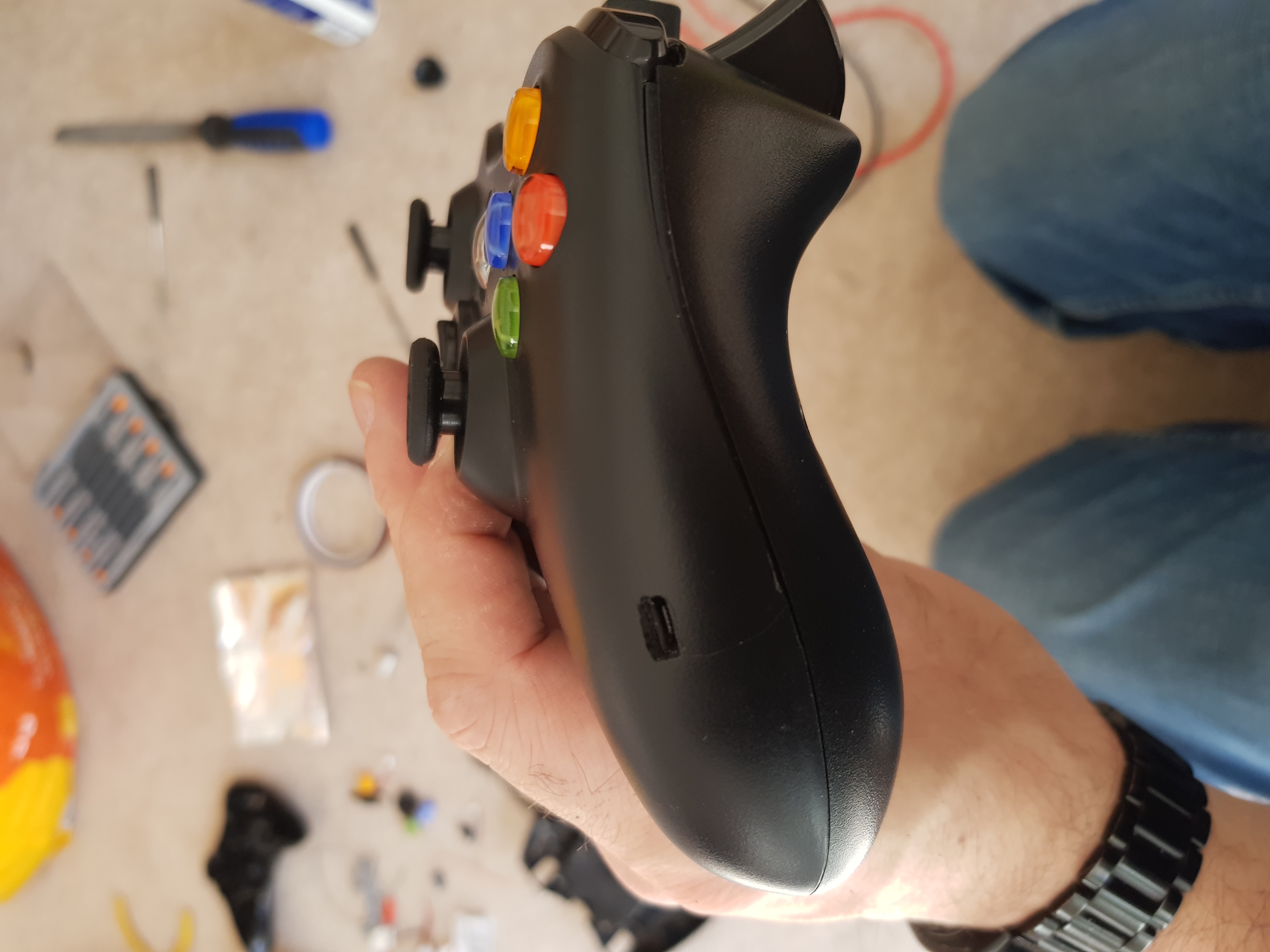

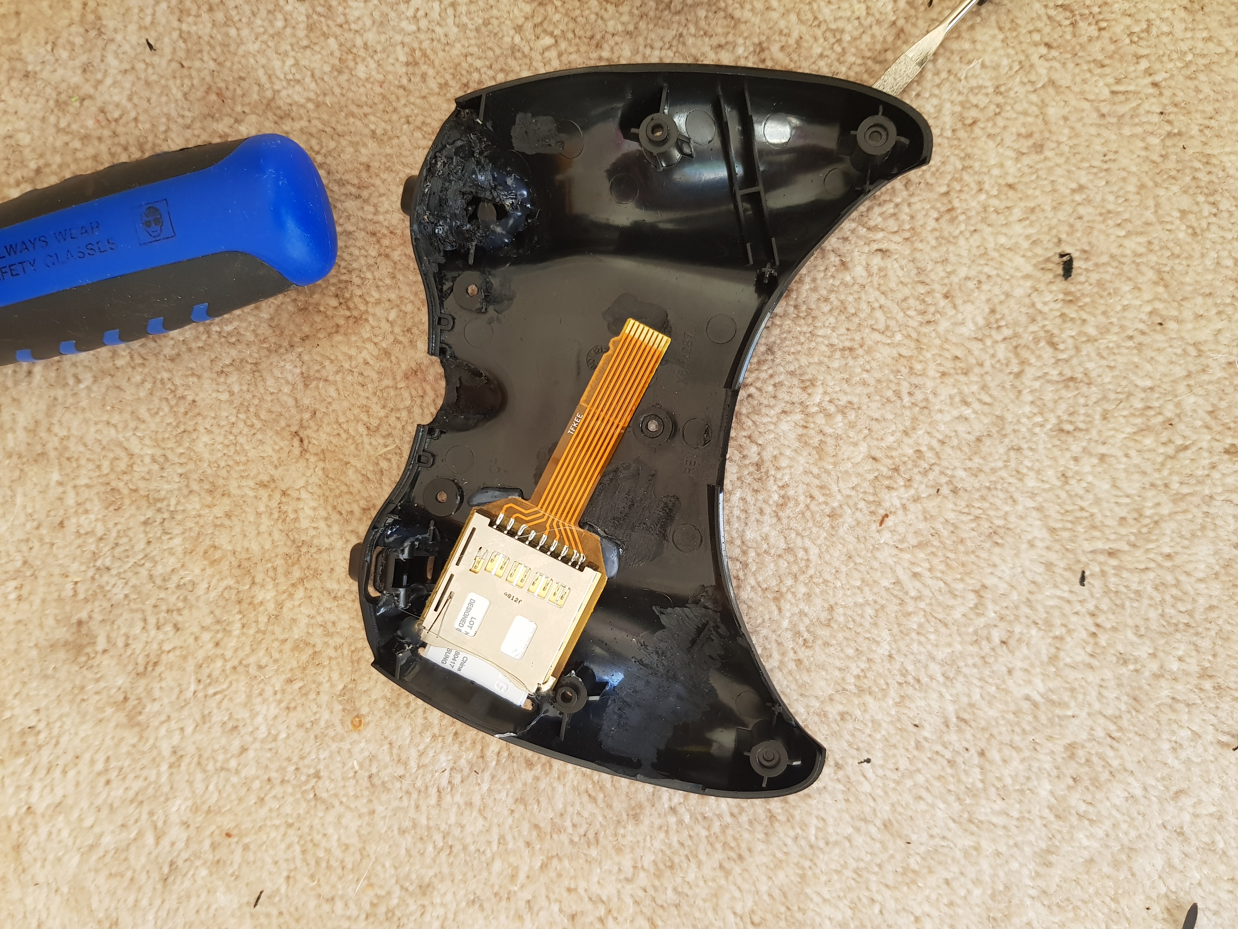

Well I might not even need to because I managed to cut away all the plastic around the HDMI connector and am trying to bend it sideways. It's held together by a lot of hot glue but I used a lighter to soften it and flex it. I'm gonna add more hot glue to reinforce it but all in all, seems to be just fine.infinitLoop wrote: ↑Tue Aug 20, 2019 4:31 pmwhen you get to powering the pi, check out the snes zero project, for doing it over the hdmi: https://www.sudomod.com/forum/viewtopic.php?f=22&t=2753

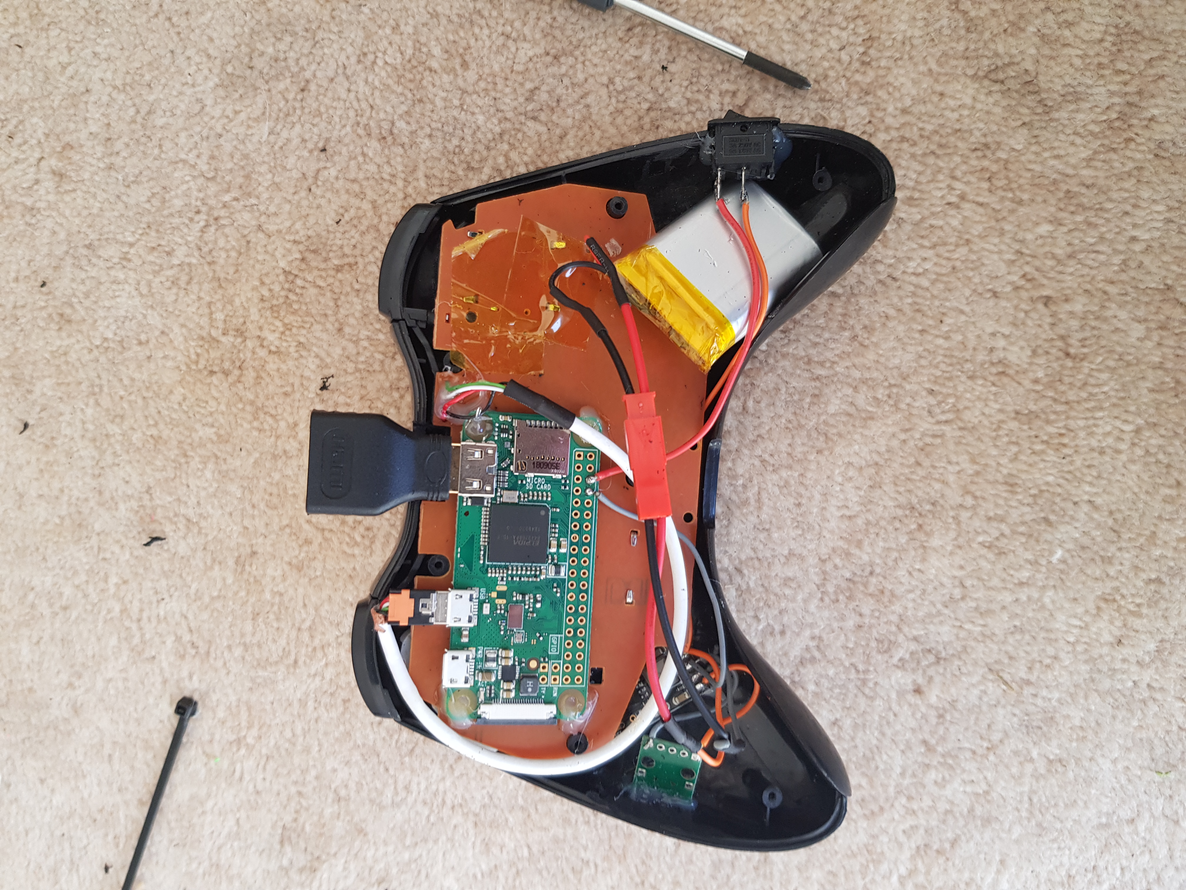

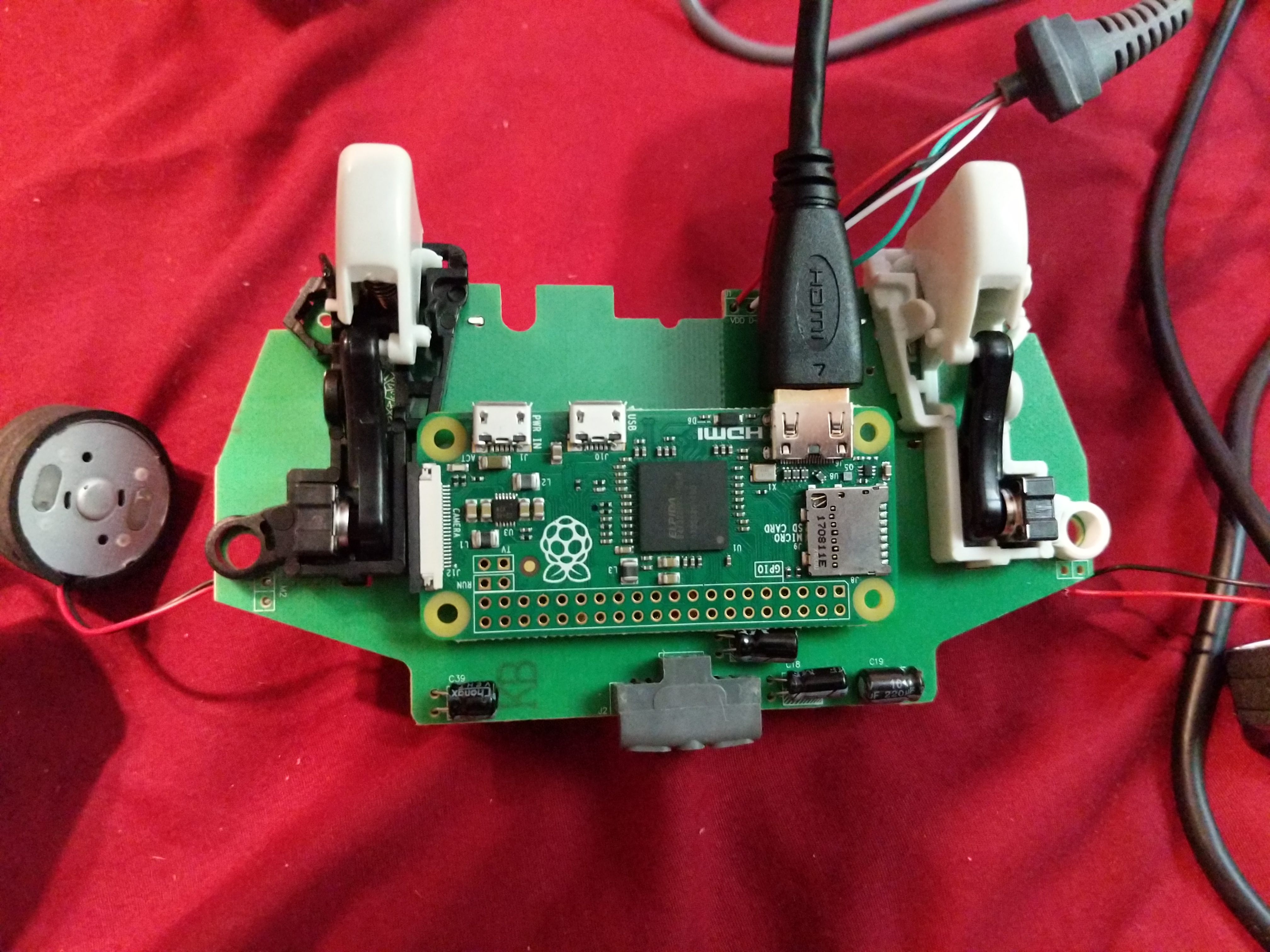

Well, spot the obvious mistake in my wiring to the pi.
Anyway spotted it, sorted it out, wired and put everything together and the USB is not detected so definitely needs 5v. I've got a power boost on order.
Fitment is pretty good otherwise considering everything I managed to squeeze into there.
