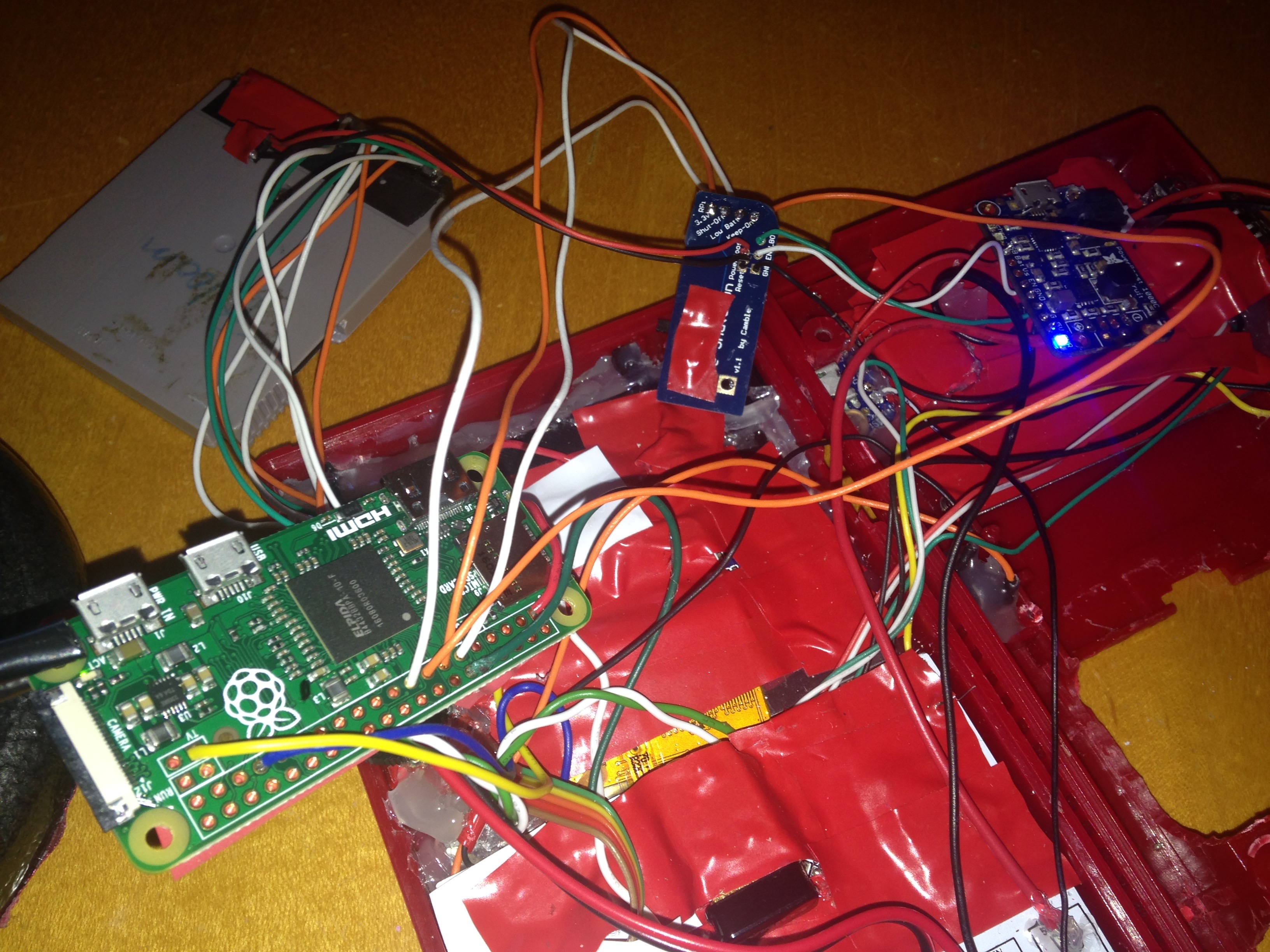

I've been trying for a while now and I can't seem to get my safe shutdown to work. When I run the python ~/GBZ-Power-Monitor_PB/gbz_power_monitor.py, it does nothing. I downloaded the monitor and video assets like instructed. Also, when I try to initiate a shutdown, I get a kernel panic that interrupts the shutdown. I am fairly certain that I have the wiring correct, based on the guides. Have you run into this problem before? If not, I can post some pictures. Thanks!

@Spruc3Moose When you run the python script manually, you won't see any output. It should shutdown when you flip the switch though. Please double-check you have everything wired up correctly. Post pictures of your wiring if you can, and I'll take a look.

Camble wrote:@Spruc3Moose When you run the python script manually, you won't see any output. It should shutdown when you flip the switch though. Please double-check you have everything wired up correctly. Post pictures of your wiring if you can, and I'll take a look.

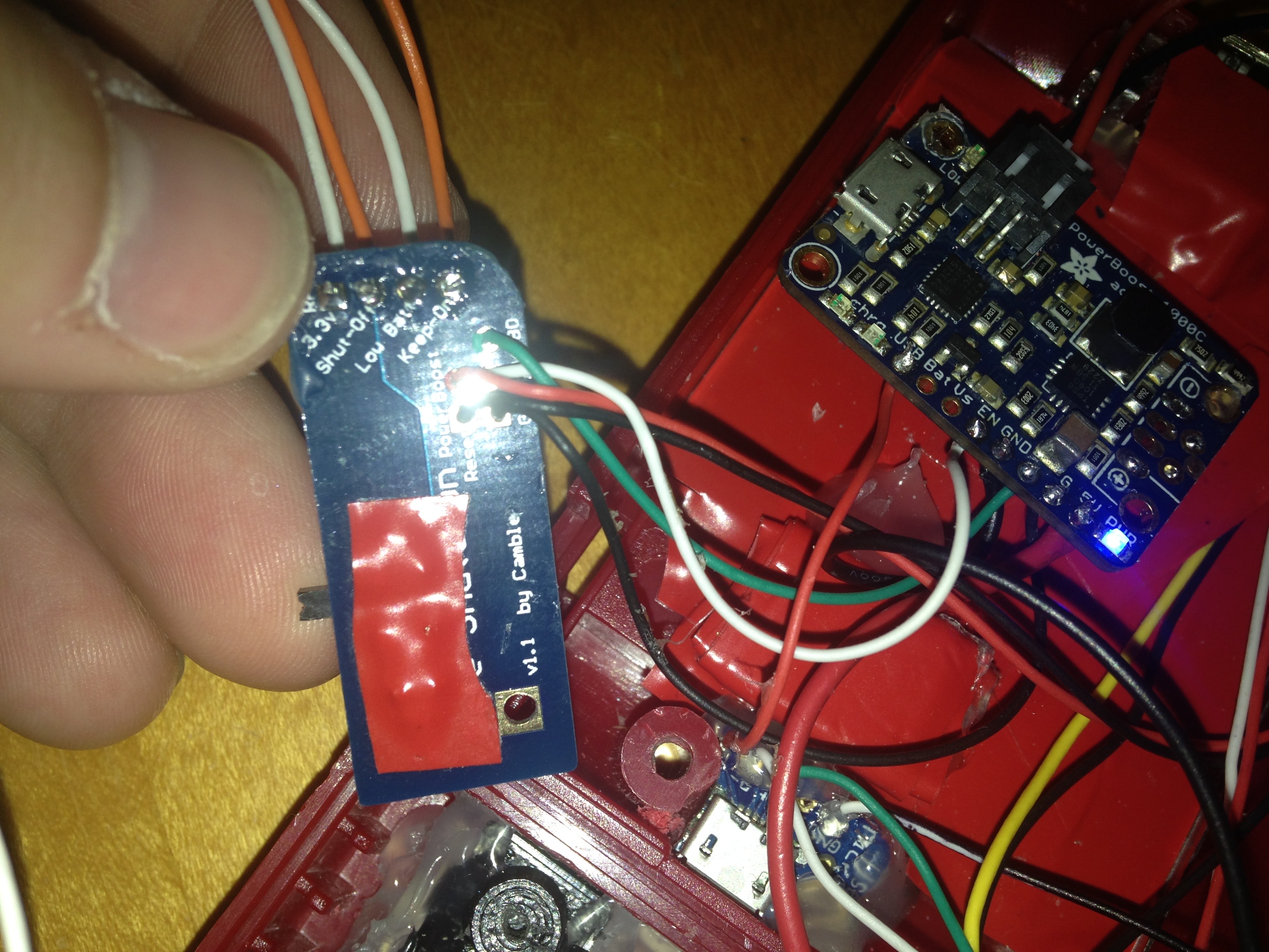

Ok, so when I run the python script in the terminal, nothing happens as far as output and I should just flip the switch to off and it should start a safe shutdown. I tried doing that and it just shutdown immediately. Here are some pictures of my wiring.

Your wiring to the Pi is incorrect.
3.3v is fine. Next should be Keep-on (BCM22), then Shutdown (BCM22) then low battery (BCM17)

Camble wrote:Your wiring to the Pi is incorrect.
sorry, I actually labeled my picture wrong...I have it like you say it should be.

@Spruc3Moose Have you amended your /boot/config.txt to include the following line:
dtoverlay=gpio-poweroff,gpiopin=22,active_low="y"
