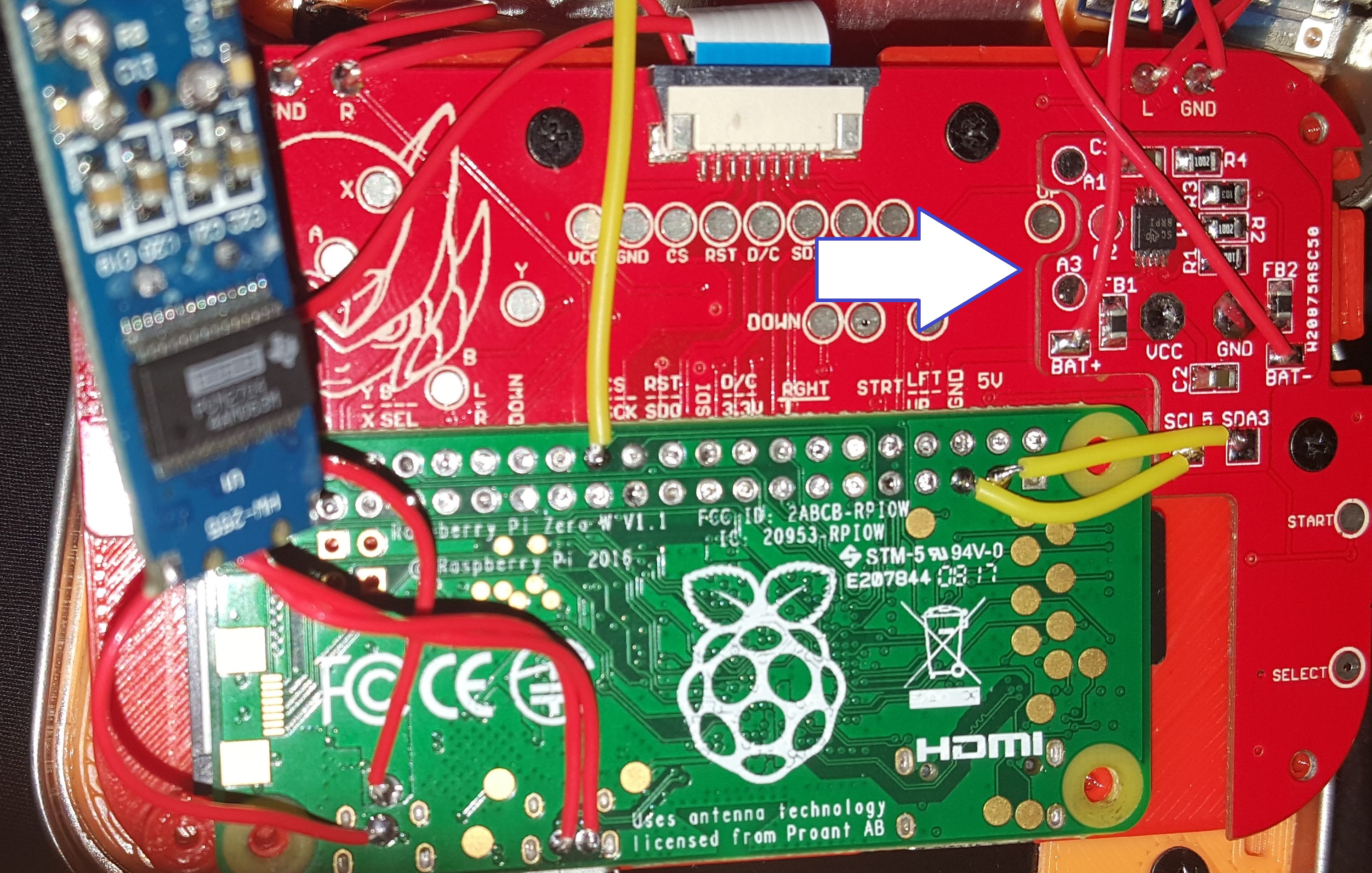

how do i wire this

You don't "wire" it. You solder it directly onto the mainboard, at the top left you have pads for this purpose.
You put the shutdown board on the main board, align the holes and the pads, then flow tint into the holes ---> done

peeweejedi wrote:
Fri Aug 18, 2017 3:08 pm
how do i wire this
Take a look at this photo from the very first post in this thread.
After soldering the battery monitoring board to the main board through the VCC and GND holes, attach two wires to SCL and SDA from the mini board to the pi GPIO's as shown. The battery plus and minus are soldered to the mini board Bat + and Bat - respectively. These use to be soldered to VCC and GND of the main board before addition of mini board.
Also, if you want to add a tact switch for on demand shutdown, then wire the tact with one wire to GPIO 7 of the pi and the other to any ground connection. Placement of the tact switch is up to you. ;)

what about the button and the wired yellow

nothing about the safe shutdown button
