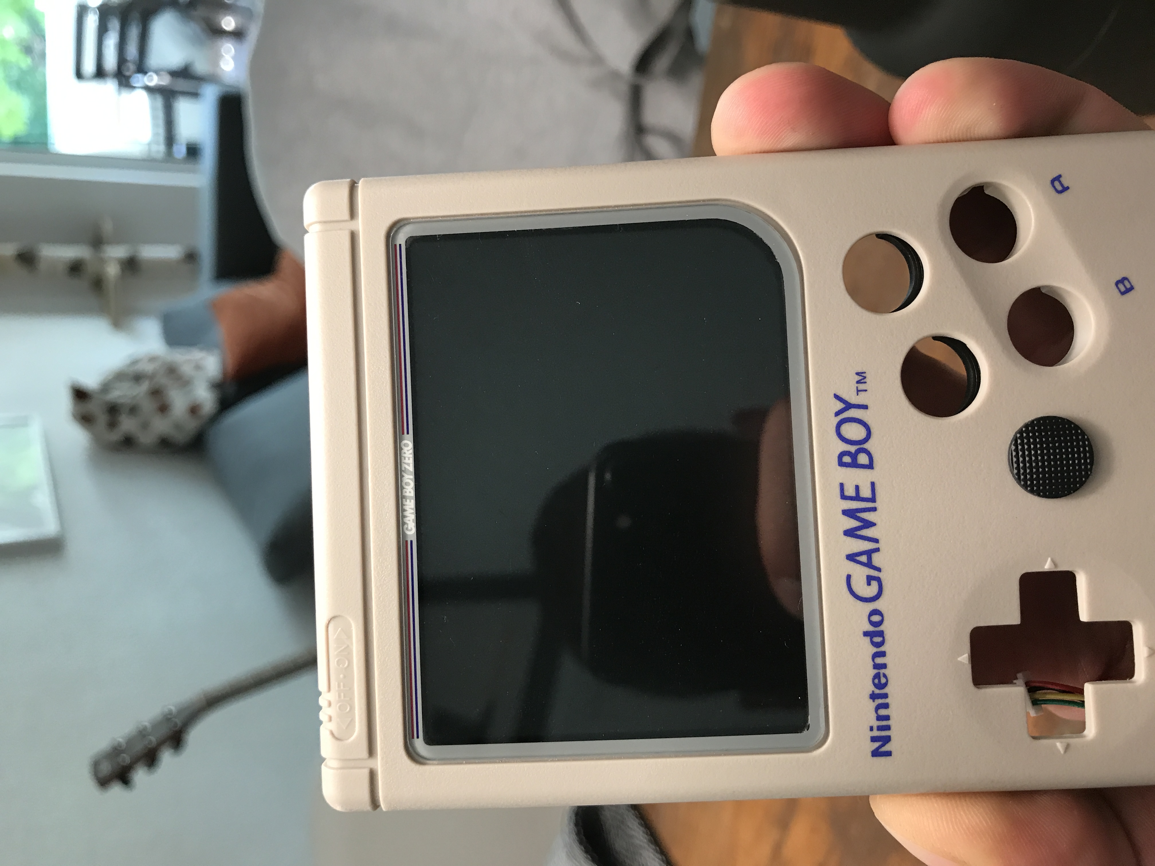

That 10mm tape is too wide.
I used double sided clear tape that was 2mm wide. It was from 3M. It is exactly the size of Day's boarder on the glass. It works well. Strong hold all the way around but I could still remove the glass if needed. Here is the eBay link: http://m.ebay.com/itm/Adhesive-Tape-3M- ... 2064342386
Picture of my screen. No tape shown but screen held on well.
PictureShow

I bought the same tape and look forward to using it. Btw love you build. The clear shell looks so dang good! I tempted to switch over lol.

I know. I was just gonna trim the excess with scissors but if they make it small enough to not jeed to that works too. Thanks!

2mm 3M Doubleside Tape works very well!

Nice !
Can I ask you where you bought your case, if it's an aftermarket one ;)
thanks
thanks
Not that i know, but it looks like the original mold. Which seems logical, since thats the one that has been noted to have the best fit with the screen.

That is crazy how well it fits and looks so good. Pretty sure it's a OG shell cause I tried the screen cover on a OG shell I have and it appeared to fit very similar. Almost a perfect fit.
