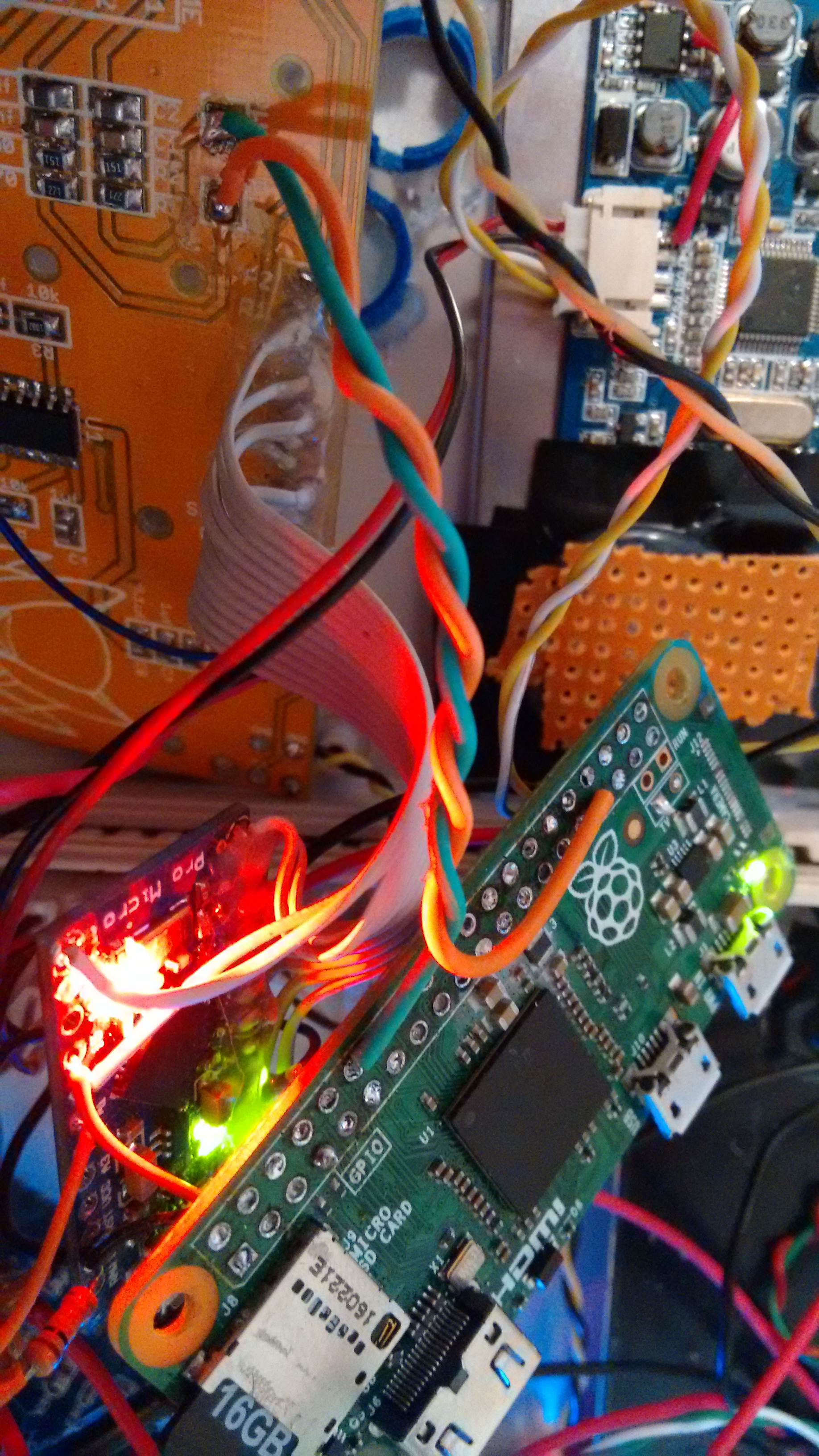

I have the controller with audio board (with built in headphone socket). The board was working OK (mostly it had a hiss I hadn't taken the time to eliminate yet) up until recently now the sound started acting up. As in... there is none :P. I checked all the wiring and it's OK (I'm enclosing a photo just in case)
The buttons work OK but there's no sound. The power and ground are connected properly and I added the correct lines to the config.txt file.
I tested it with a speakr and with headphones just to check if the speaker is busted. Non worked. Also in the retropie settings the sound is set to full. The only thing I didn't try yet is to change the pot. All the wired on it seem fine and I don't think it's broken.
EDIT: One thing I forgot to mention is that the problem didn't start comming up until I switched out the screen. First I used a GPIO screen bu then I switched to a composite screen. After the switch the audio just stopped working.
What could be the problem?
