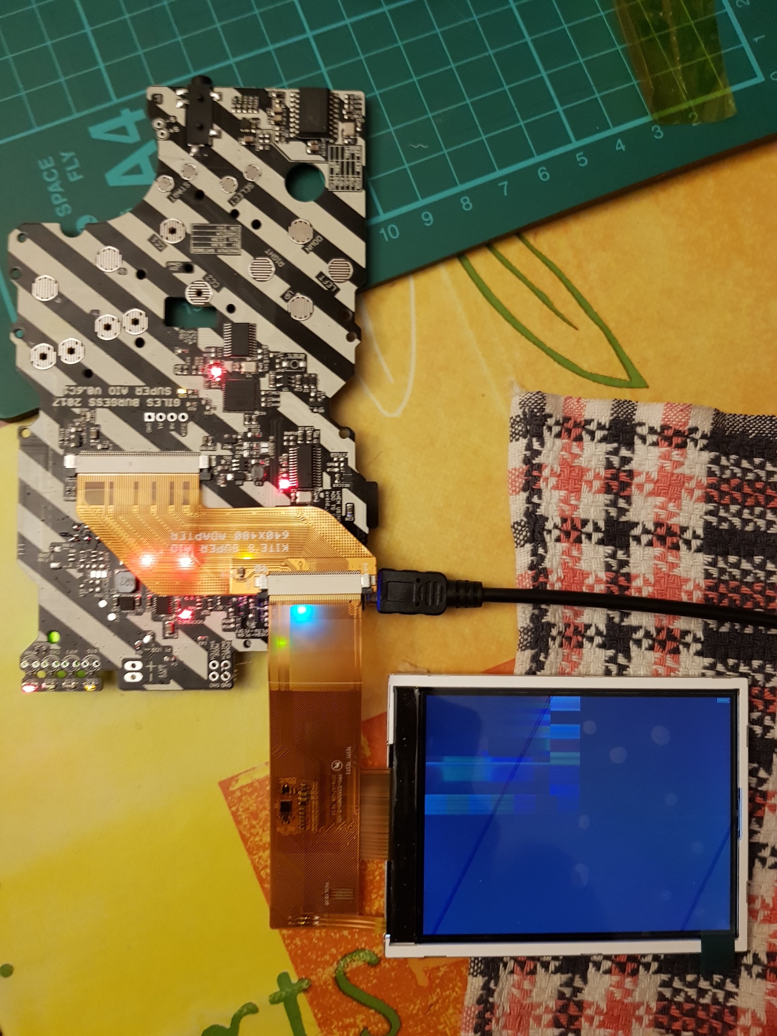

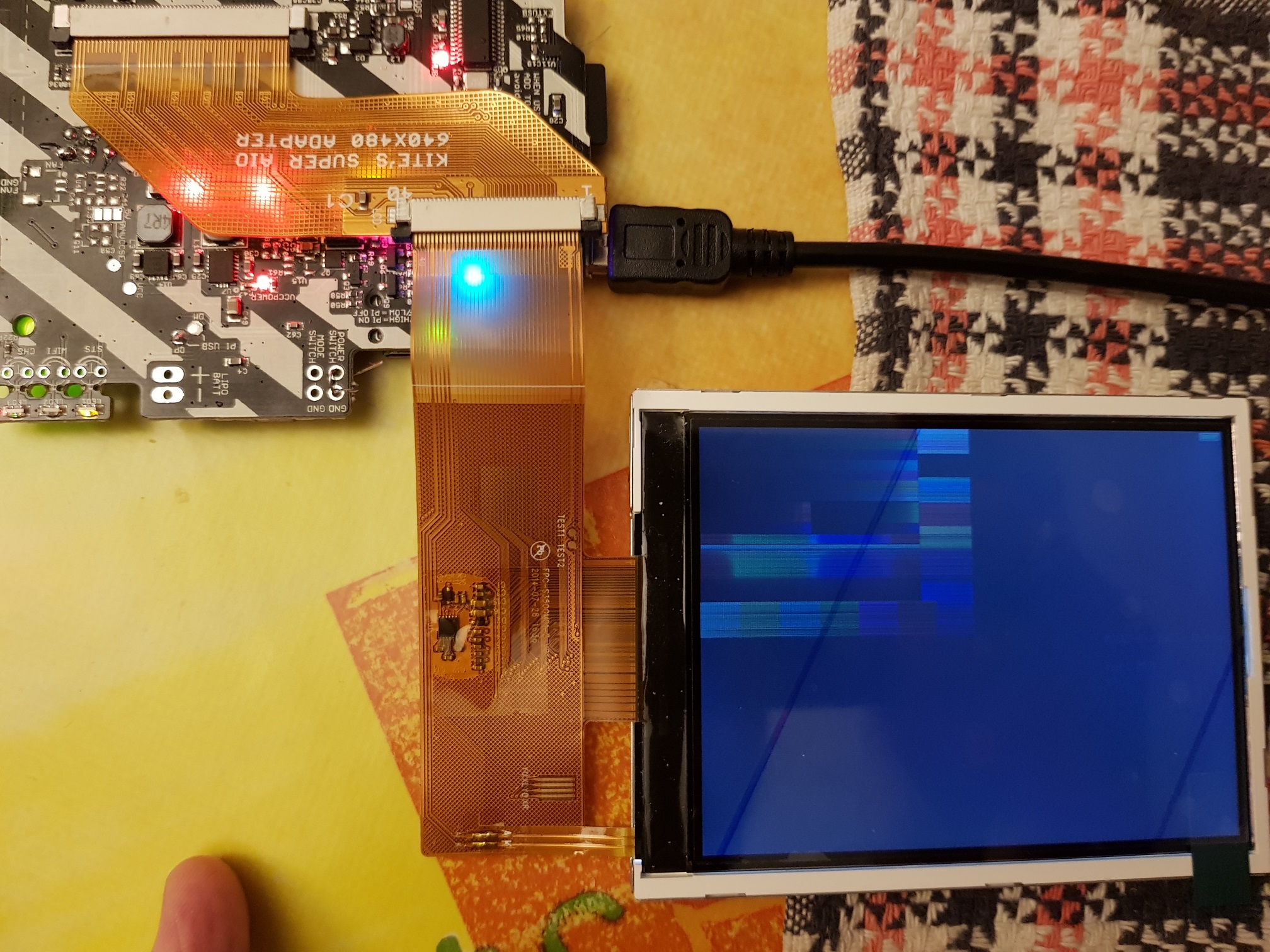

I change the screen to the 320*240 and it seems to be better, but still have a weird color: white appeared to be kind of yellow...
Any ideas?
Any ideas?

Your soldering is missing some connections, check the GitHub wiki in the troubleshooting as that gives tips on which pins you need to rework
Do not try and remove the Pi, rework only!
Once you have the 320x240 working perfectly, then we can debug the 640 if it still isn't behaving!

I resolder all pins but still no change, I guess blue pins cause the trouble since the blue gradient is not correct, is that right?

Correct, it is the blue 'most signifant bit' because it happens in the middle of the band only once. I can tell you precisely which pin it is tomorrow (not at pc right now)
