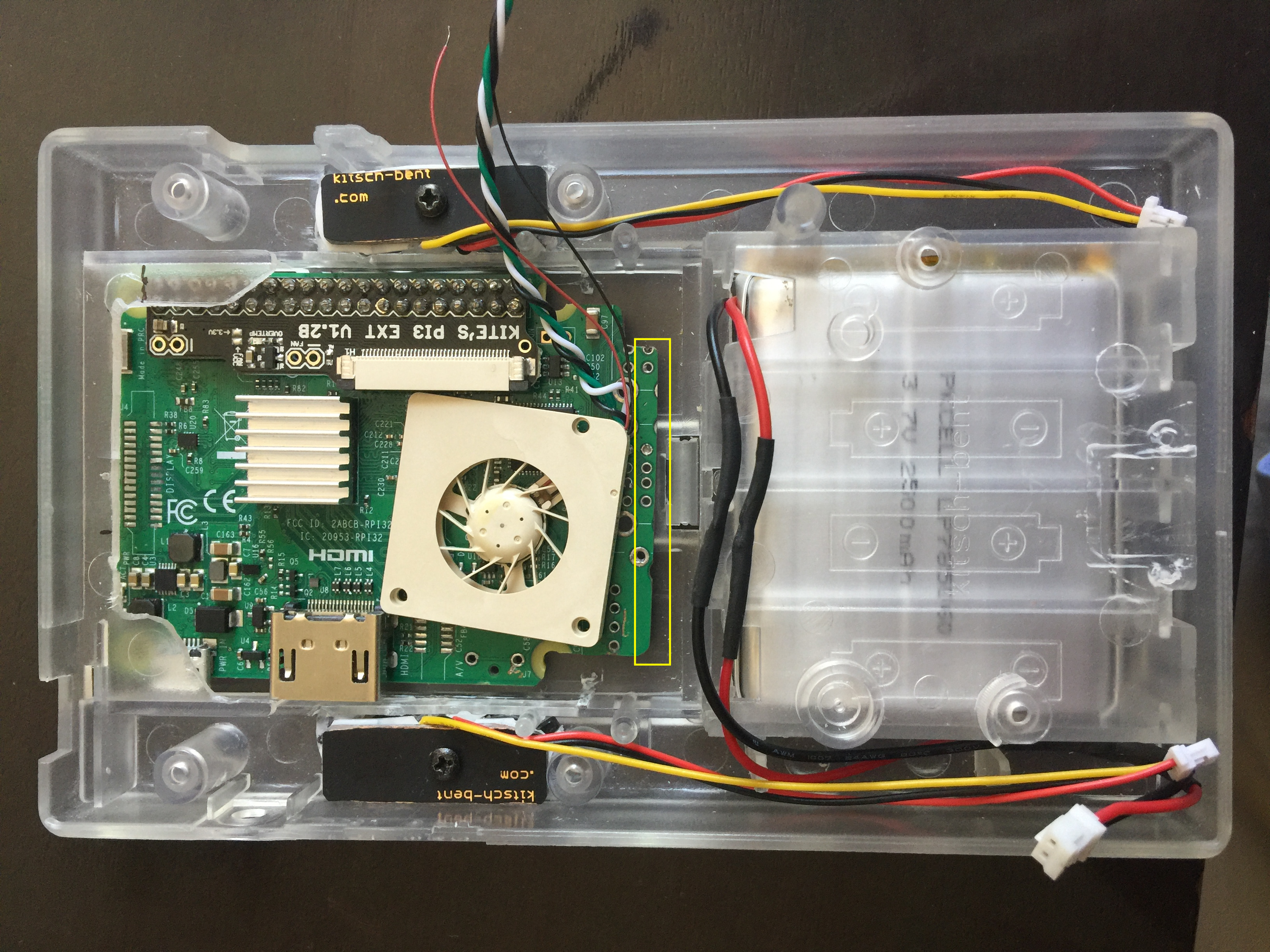

I am currently fitting the Pi3 in my DMG shell.
Per the Wiki, I am about to put the unpopulated Pi3 in the cartridge slot, with the microSD poking out right where the battery lid latch goes.
If I do put the Pi3 there, I don´t have space for the latch of the battery lid.
Has anybody done this and how did you make the lid stay closed? I would like to avoid tape or adhesives, and if possible magnets.
Alternatively, is there any issue with flipping the Pi3+Fan and having the microSD poke out of a cutout on the game cartridge top? This orientation has the advantage of having the fan blow upwards (hot air tends to go up) with the possibility of having some mesh or slots to help hot air exit the case.
Any ideas welcome!Thnx

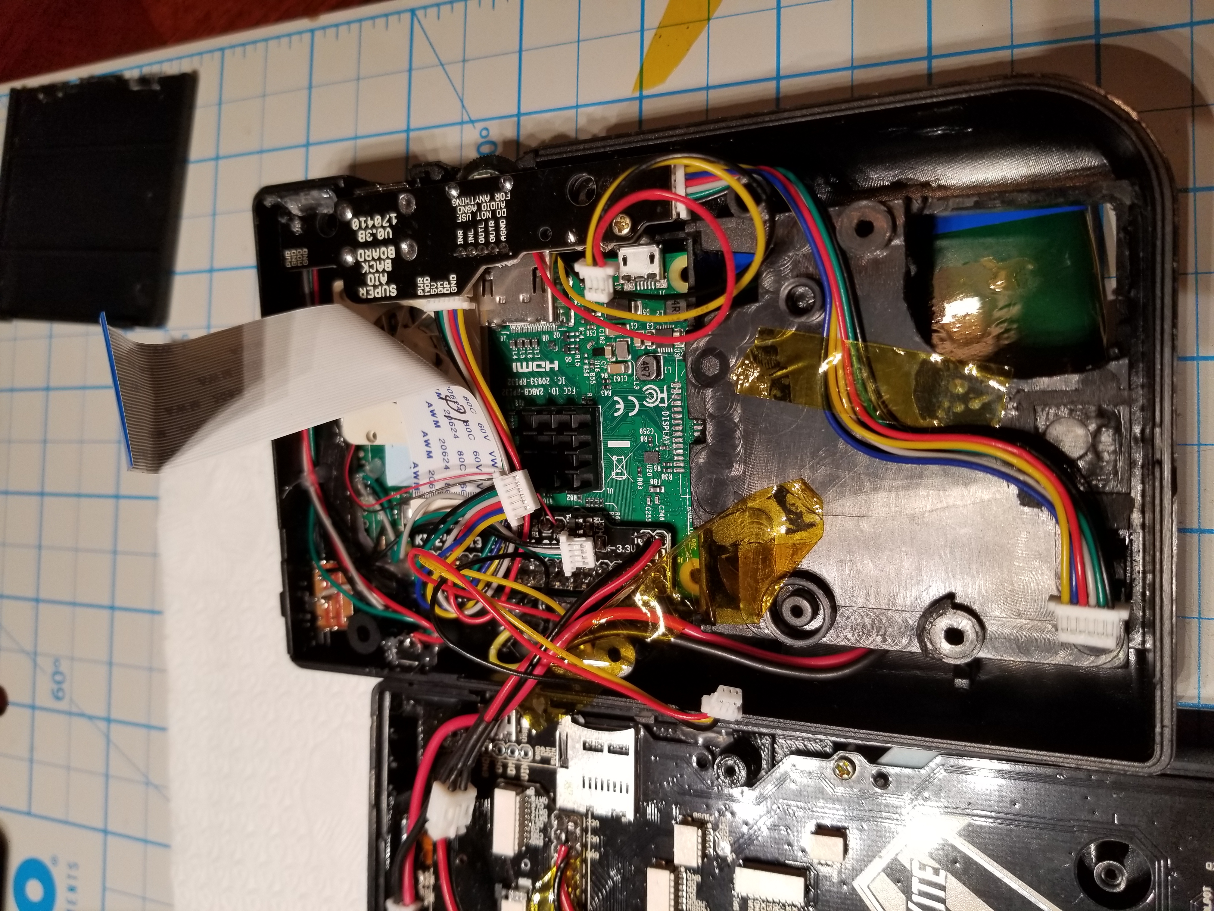

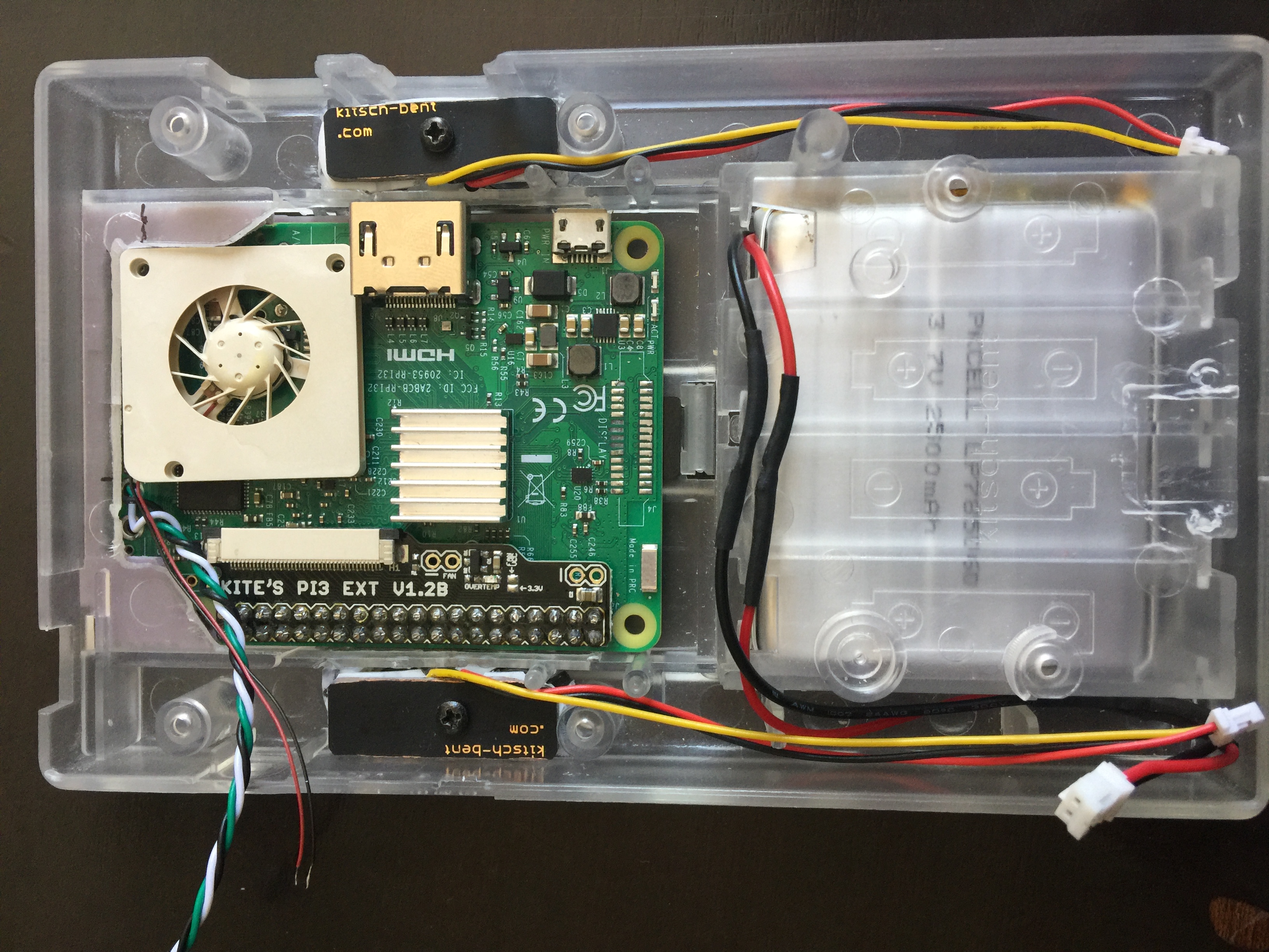

Hey, heres a picture on how I fitted mine, hope it helps. I had to cut the battery tab off and I used a super tiny amount of very thick and very strong double sided tape to hold the battery door on. The tape was firm enough to hold the door but not so firm that it didn't come off when I needed to remove it.
Unfortunately, you won't be able to turn the Pi the other way because you need to connect the ribbon to the ext board to connect both boards together.

Hey dryja123 thanks for the tips.
Your build looks amazing by the way!
Unfortunately, I am trying to avoid using tapes as a means to hold the lid in place, and I would like to have the SD card accessible, so just mounting the pi further up would not work since the sd would not be accessible.
I am about to mount the pi board with the SD on top, so the ribbon would just come from the opposite side and still be able to reach the SAIO socket which is more or less in the middle at 90 degrees from the pi EXT Board.
Does anybody see any issue as to wether the Pi should not be mounted with the SD on the top and the fan blowing towards the top too?
Wouldn't the fan work better this way?

Have you tested it?
I think, you can cut some more mm from the "upper" side (USB) of the pi3.
