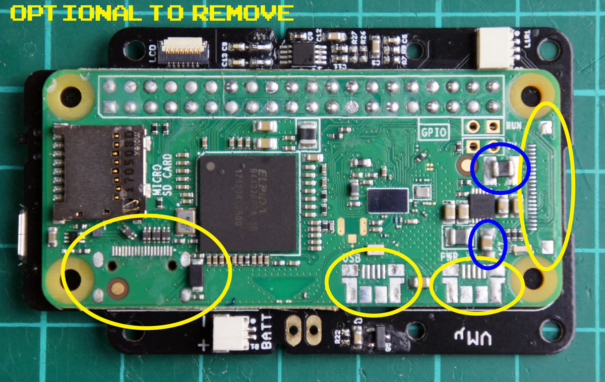

I was going to set about thinning my RPi in preparation but I'm confused about the two capacitors circled in blue. It appears as if Kite has replaced the larger ones that were there with smaller ones, no details on this though. Any ideas?

omgitsaheadcrab wrote:
Fri Feb 22, 2019 3:50 am
I've bought one of each. The larger one I got from Aliexpress, which won't arrive for some time, but the smaller one I got from a Spanish eBay seller and it arrived in the UK within 3 days :d
That's exactly what I was talking about, I removed the connectors but not the capacitors so eveything should be ok but I wonder if it's still needed.
I believe (don't have a Pi Zero yet) the upper part circled in blue (near the composite video output pins) is an inductor, not a capacitor. No idea about the values to use, plus I'm suspecting this was someone's experiment and not something for general consumption. Note that the v2.1c board revision used in these photos still planned on having the speaker in the original case location, rather than the front of the case as in our shipped v2.1f boards. I'm suspecting this will free up more space for batteries, mitigating the possible need for Pi Zero component removals.

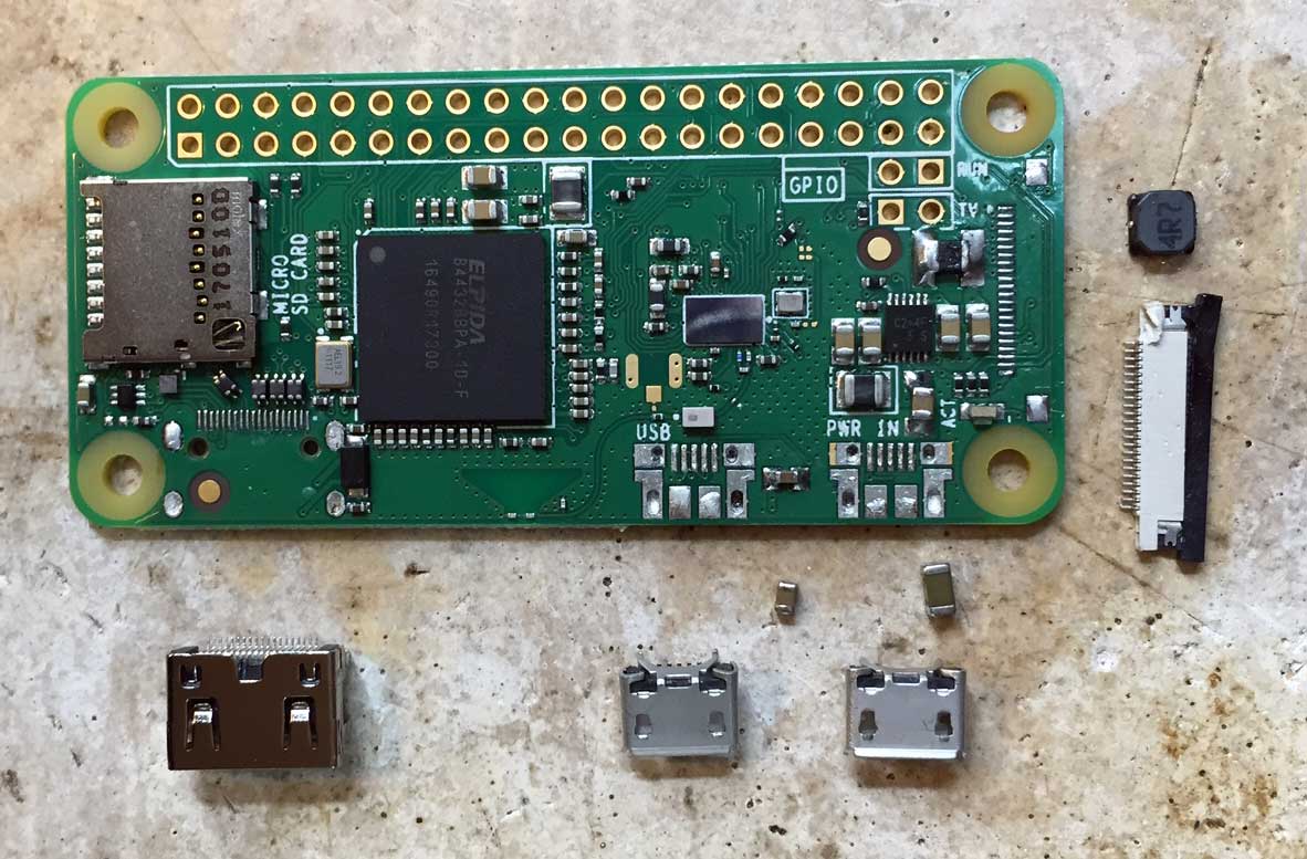

Post by diko_d » Sun Mar 17, 2019 7:05 am
Hey guys,
I am actually traveling today, but will get back home later today so that I can post some pics for you to see.
I built it with the original recommended 850mAh battery from the original post. It fits great inside the case. The images of the the original build are, however, somewhat misleading...
The RPi Zero W actually has a pretty bulky power regulator next to the camera CSI connector, which you cannot remove if you want the Pi to work correctly. Still, if you push the battery in the case all the way up it fits just above the upper “optional” capacitor recommended to remove. So effectively, There is NO need to remove the optional components. Moreover, you also do not need to remove the CSI connector. You will however need to remove the HDMI and the two Micro USB connector to fit the larger battery in.
As mentioned, I will post a few pics later today.
