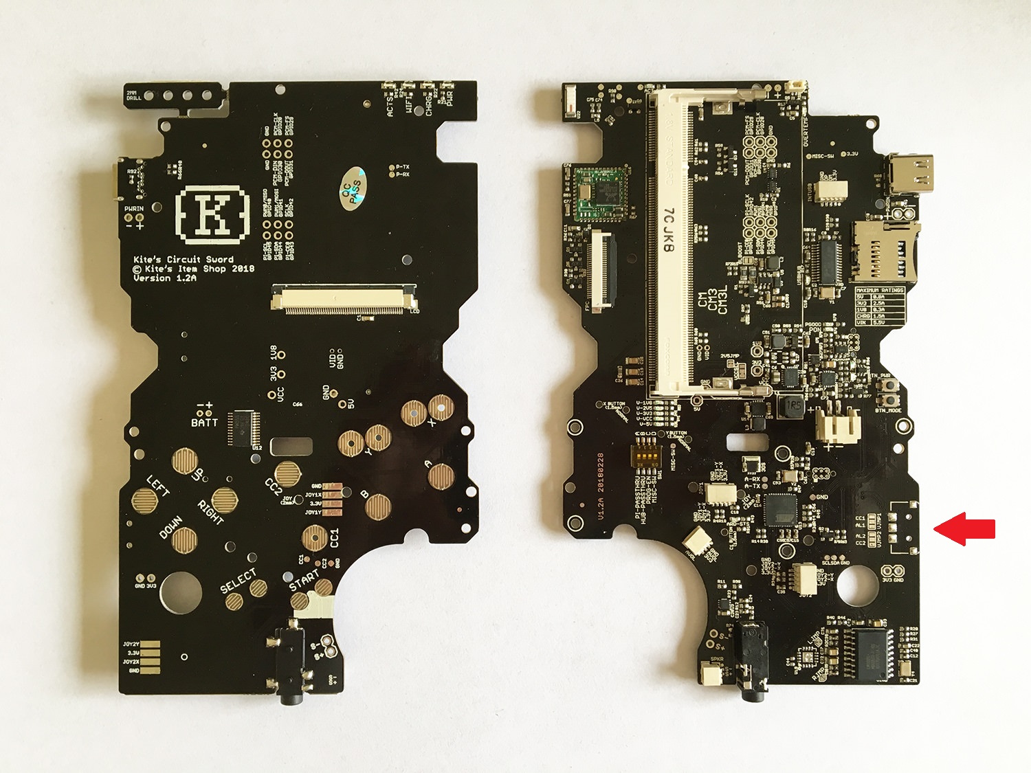

Quick other question:
Which poti can i use here? (See picture)
Can i use a 5 Pin B103 10k Ohm poti like this for example?
https://www.amazon.de/REFURBISHHOUSE-16 ... s=b103+10k
Or the poti from the Alternative back board?

That thing you have pointed to is a digital volume rocker, you can find it by looking for a "navigation switch". If you want to use an analog potentiometer, then use the "AVOL" connector that is on the PCB at a 45 degree angle above where the battery is
