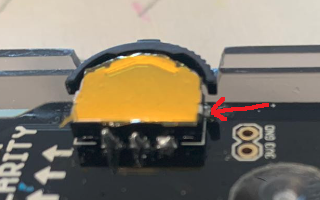

This pin, can you rework this slightly?
Another thing you can try, with it on, get a piece of wire with one end attached to like the USB port, and then touch the other end to one of those three contacts (in your picture, the three at the front). And see if there is a reaction on screen.
omg i didnt solder that pin.... *facepalm* sorry for wasting your time...

Haha no problem :) i'm glad that it was something simple! It's not well documented (or even at all really) so don't worry about it! :D
There is also a pin on the opposite side, solder that too (its only purpose is to provide physical support for the switch)
