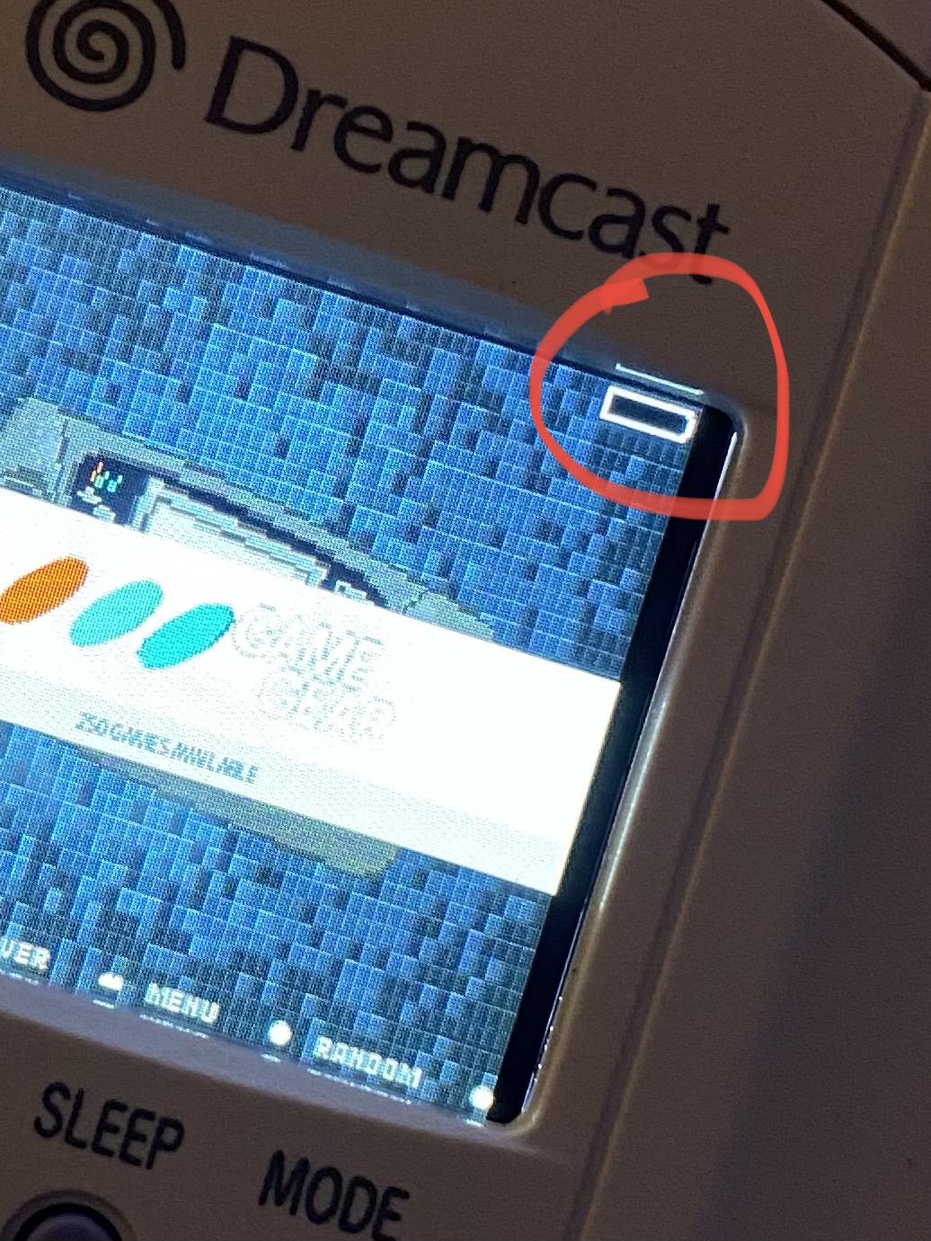

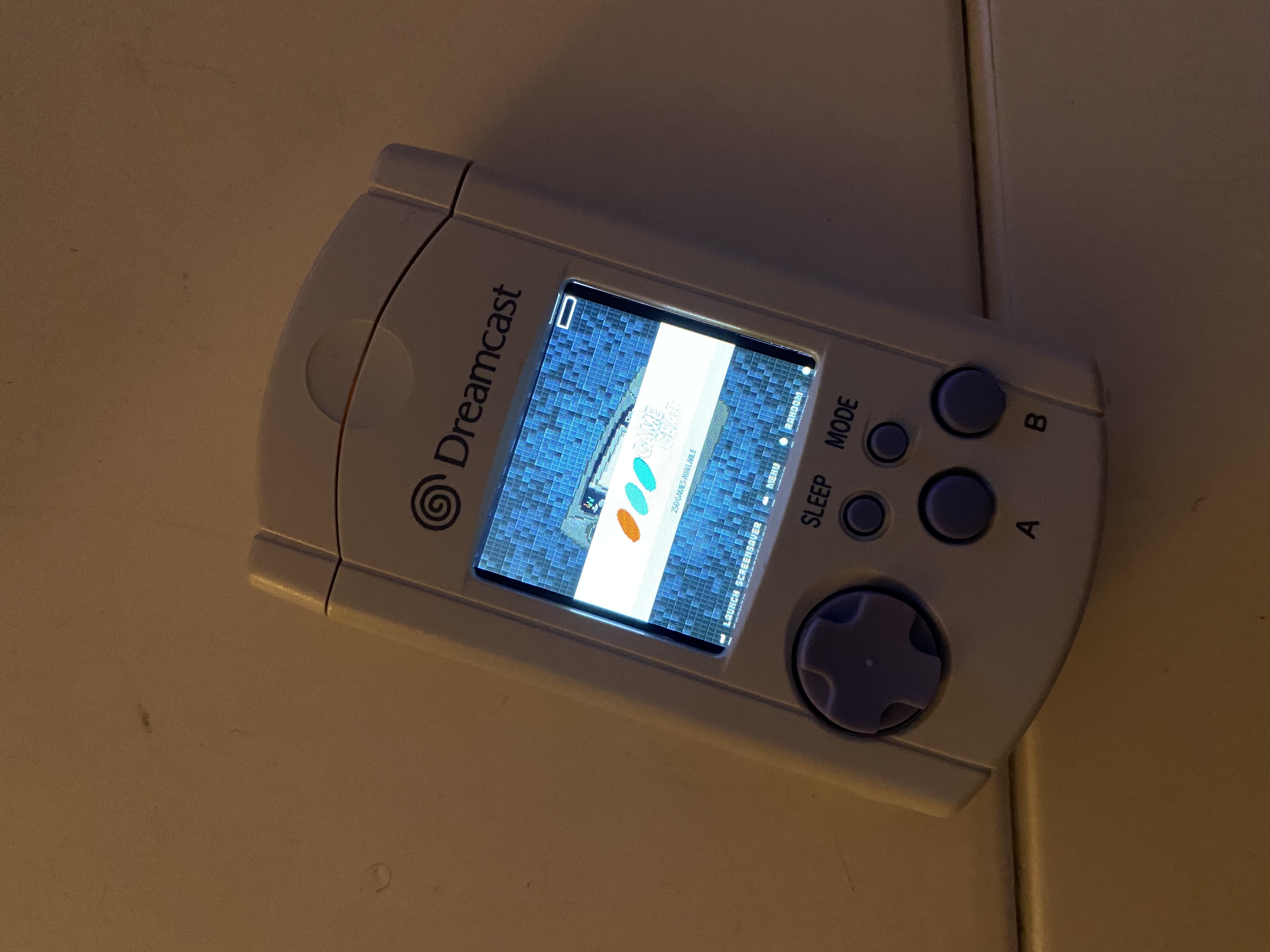

Hi everyone!
I just built my circuit gem!
I have a small problem, the battery icon is shown but it appears empty, so I don't know how much battery I have. how could i solve this?
And on the other hand, what theme are you using?
I have put the theme pixel, but the games menu, the font is too small and can hardly be appreciated.
Thank you!

hello @kite Could you tell me how I could solve that the battery bar looks full? will there be a new plate for sale like wermy's version?

It works fine on my Gem. The battery is connected to the Gem so wouldnt expect there to be any issues with that. I assume you've fully charged?
If you check the FAQ: https://github.com/kiteretro/Circuit-Ge ... it-Gem-FAQ looks Pin 16 monitors the battery, check for continuity with the test pad and also a short, especially with ground.
