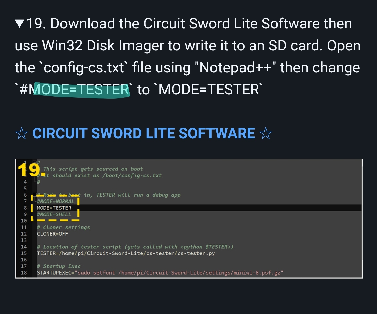

The circuit sword has a test mode ( I know this is the lite version). Have you checked if this mode is enabled? Ifso you need to disable it
Anthology
Posts: 28
Joined: Tue Jun 30, 2020 1:05 pm
Been thanked: 9 times
Re: Circuit Sword Lite Bootloop
Post by Anthology » Wed Oct 13, 2021 7:57 am
So do this
Add the '#' back which you removed in step 19
