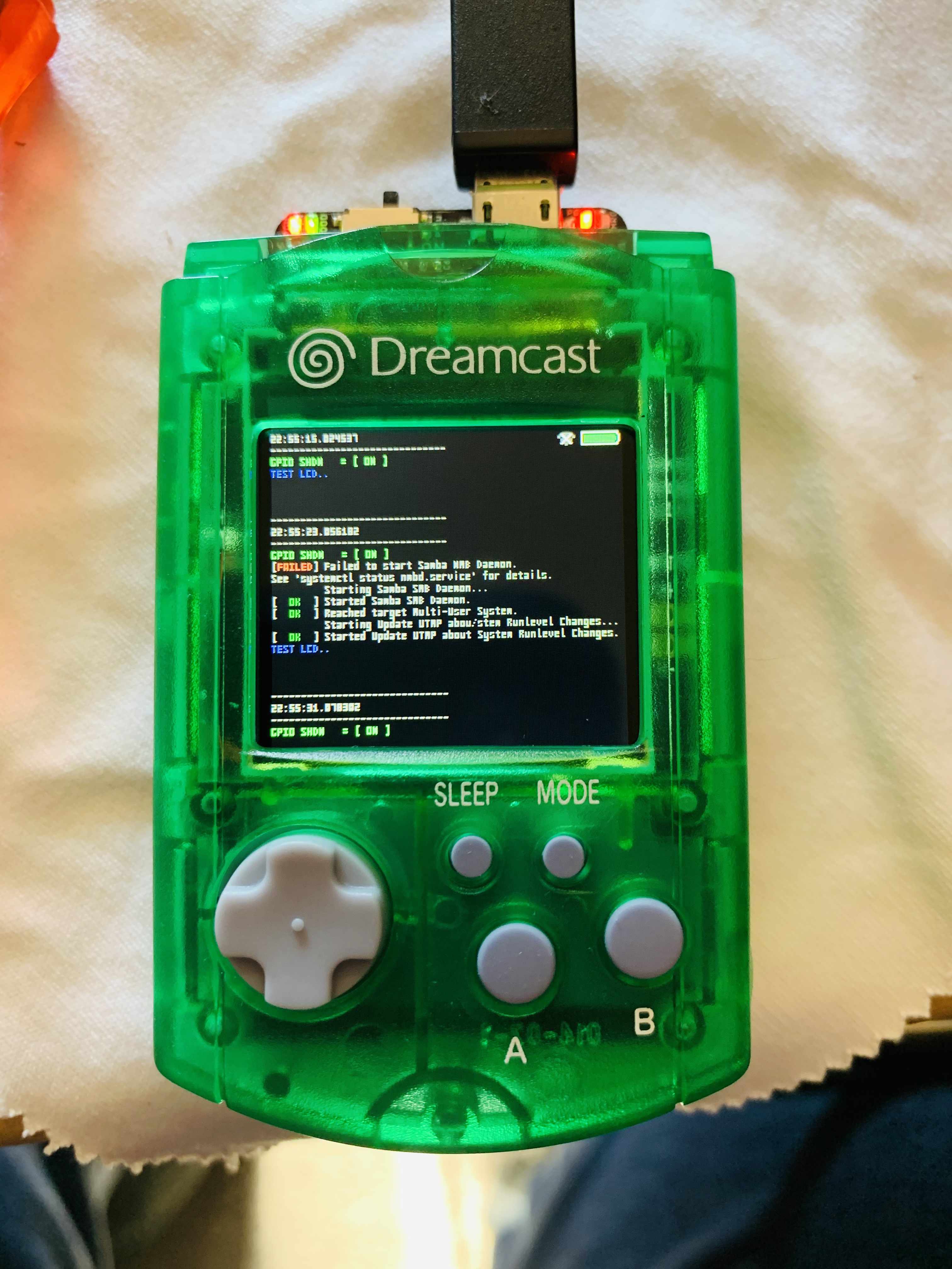

I’ve put together my Gem and have gotten to the point where the test loops the SHDN on and LCD Test forever.
I’ve tested the SHDN Gpio for continuity and it doesn’t look to have shorted to ground or any other pin around it. what’s the next step? Shouldn’t SHDN be set to off and when I turn the per switch to off it should have turned off, it didn’t it brought the menu up.

do yiu modify the config cs txt file?

The only modification I made was to put it in test mode by setting #MODE=TESTER to MODE=TESTER. Thats when the loop happens. If I change it back it will stay stuck at the kiteretro screen and as far as I can tell never boot.
