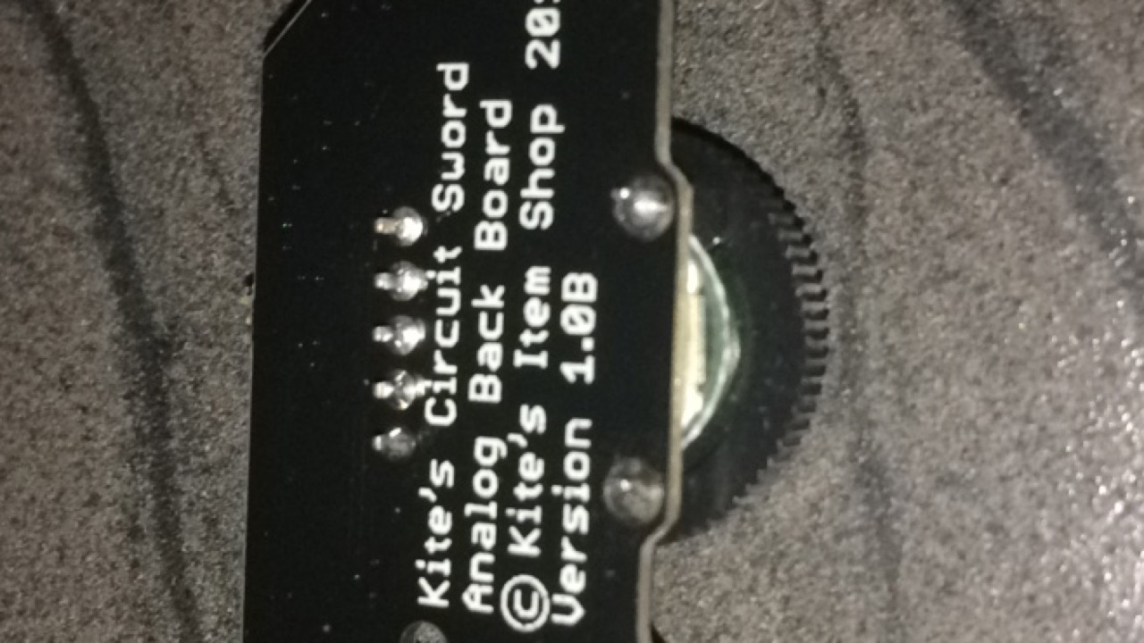

Hm! Ok can you take some pictures up close of the back board, both sides please? Perhaps get soldering iron out and solder from the bottom those pins A B and C with some more fresh solder?

Post by SuperPitendo » Wed Jun 27, 2018 7:03 am

Post by kite » Wed Jun 27, 2018 7:35 am
Right, I think it looks like the back of the 3pin connector on the Back Board isn't soldered properly, it looks to me as if it has been shifted and the pins haven't stuck to the solder.. do you think this is something you can have a go at soldering? It is possible, as these pins are 1mm apart from each other.
If you give it a go, and see if that helps.. if it all goes to pot and is messed up I'll send you a new board out! So there isn't anything to lose! Also it is possible to snip that 3pin cable and solder to those pints A B and C directly, so we've always got that as an option :P

Post by SuperPitendo » Wed Jun 27, 2018 10:50 am
To be honest... my soldering equipment sucks... it is the cheapest you can find... its good enough to solder 2 soda cans together :lol: but for such tiny things its not adequat :?
